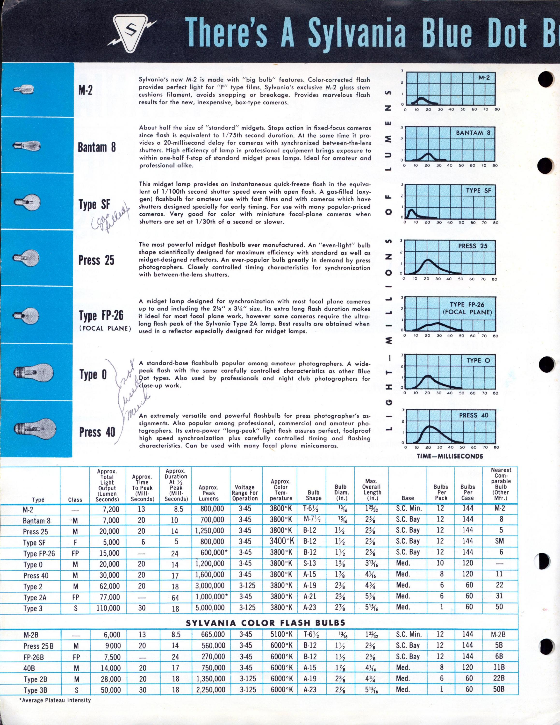

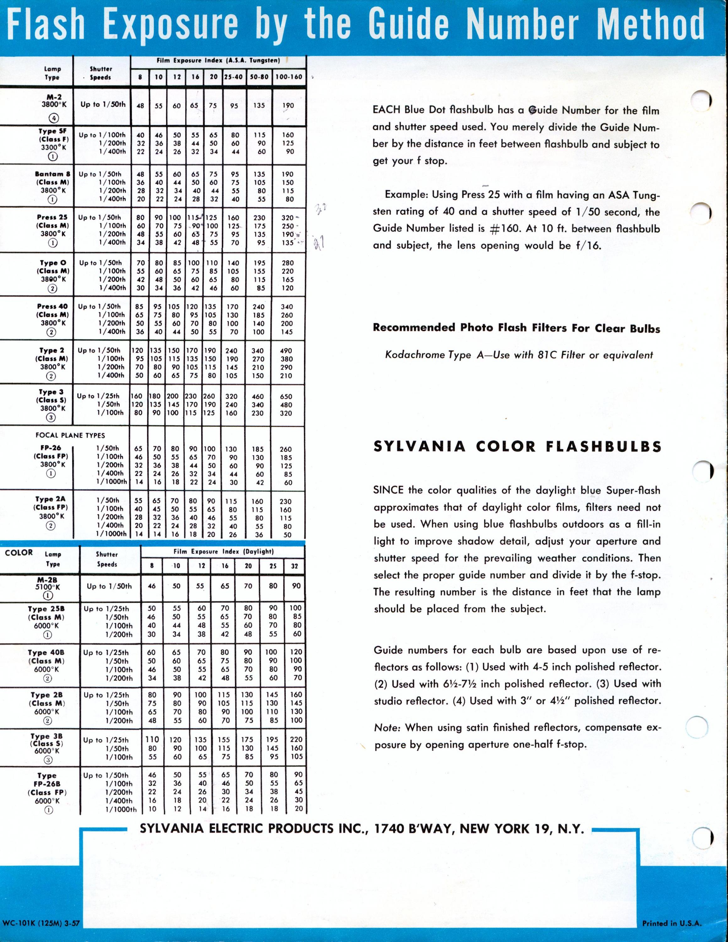

My question is was there really a difference between the older M25 and M5 bulbs and the newer M3 bulbs or was this just a name change to help novice photographers figure out what bulb to use. The published guide numbers for the M25 and M5 are very similar to the M3 guide numbers.

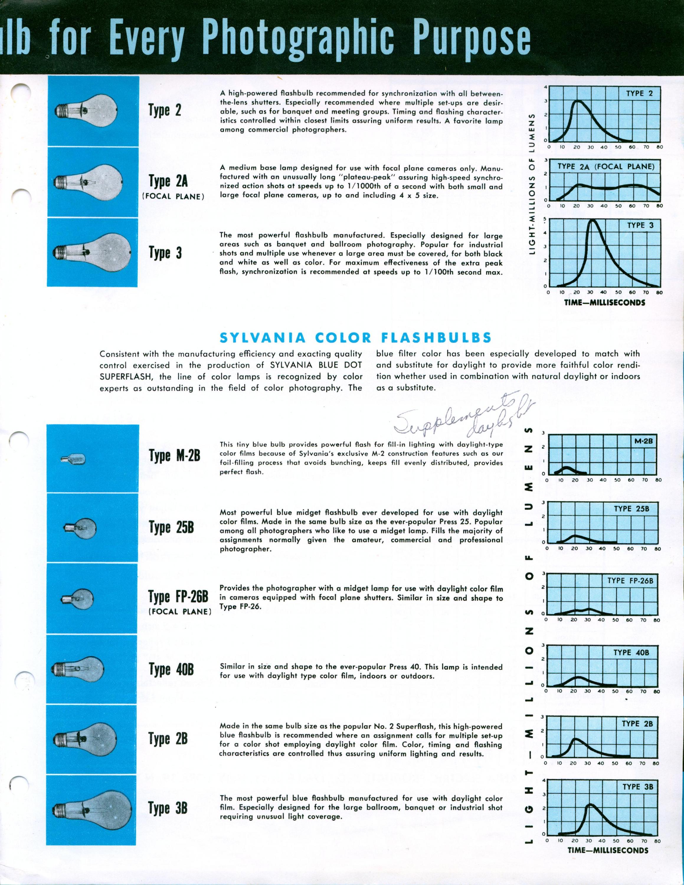

Was there perhaps a difference in the time to peak. I have an M5 package that lists 20 milliseconds to peak and a later M3 that lists 17.5 milliseconds. Perhaps the older time was just rounded off to 20 ms.
