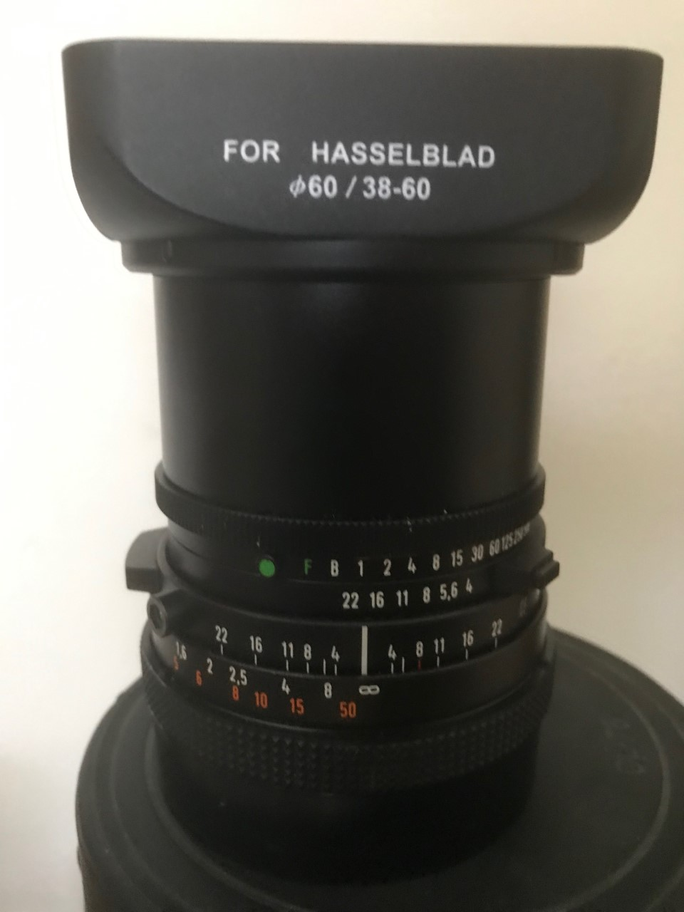

I have a 50mm Distagon CF T* lens that I love, but it does seem to have a tendency to flare when the sun is just outside the frame. I have the correct hood for it, but it is pretty small and clearly doesn't do a great job at reducing flare. I've tried shading the lens with my hand, but I like to shoot in mirror-up mode and my hand has been known to encroach on the frame 😕
Is anyone aware of another Hasselblad hood that will work with this lens and do a better job at flare reduction?
Here's an image showing the sort of flare that I'm referring to (upper right):
There are Hasselblad lens hoods, of various brands, that are for the 50mm lens. You appear to be using one that is a bit too short.

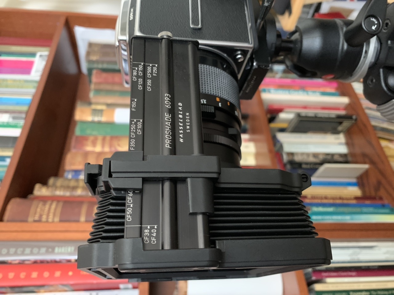

I use this for my 50mm CF lens.
Is that what's been known as a compendium hood?
Not very familiar with the terminology...
Yes, a lens hood with a bellows is called a 'compendium'. When I used a Hasselblad on the job we used a Lindahl "bello-shade"(?) because it fit (and we already had it on hand).

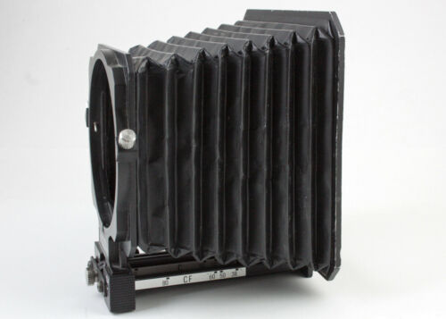

I see there's another 'Hasselblad Professional Shade' that has part # 40676 that looks like this:
Is there any functional difference between the 40676 and the 6093? Not clear why one would choose one over the other.
The big difference is price and which adapter is available. To use the outside hood bayonet you’ll need the 60 adapter for your CF lens. Standard for the hood I showed. The older compendium has a 50 adapter for the C lens as standard and an optional 60 adapter which is absolutely impossible to find. I bought the older and more affordable compendium first , searched unsuccessfully for months trying to find the correct adapter for my CF lenses… and learned the hard way.
Yeah, it looks like the 6093 is about 3x the price of the 40676.
Assuming the B60 adapter was available for the 40676, is there any reason you'd still recommend the 6093 instead?
LOL… yes, assuming you could find the correct adapter the older compendium will work just fine. Actually, maybe even a bit better because the bellows aren’t as stiff as the newer model.
But you’ll be a lot luckier than me (and I can get really lucky finding obscure old stuff generally)… or you’ll end up like me buying two to get one that will work to my liking.
The older model came with two adapters, a 50 and 63. You can use the 63 with a bay60-67 adapter, but you’ll be attaching to the filter bayonet. That works okay but I didn’t like that when using a filter.
Check out Roberts Camera. They generally have lots of these compendiums at a range of prices. But as you know… the newer one is always going to cost more.
Thanks. Found a 40676 that comes with a B60 adapter - or so it said 🙂 We'll see when it gets here...
