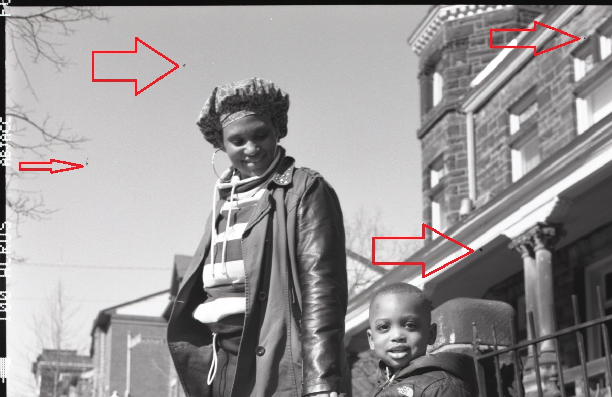

This is annoying. I have a backlog of Acros 100 (120) that I've been developing (six to nine months since exposure). Every roll I develop has at least a few frames with, what looks like, emulsion that has flaked off. These show up as clear, irregular spots on the negative. Usually where there's one there are others. Since this started happening, every variable has changed (for one reason or another) including:
- tank and reels (Paterson to stainless)
- developer (HC-110, various dilutions, to XTOL 1+1)
- stop (acetic acid to plain water)
- rinse (Paterson tank with hose to Ilford rinse method)
- wetting agent (Photoflo to Edwal LFN)
- camera (two different Yashica Mat 124G's)
- film (all Acros but different lots and expiration dates)
What hasn't changed is the storage conditions of the exposed film (Ziploc bag in cool dry area) and the fixer (Ilford Rapid Fixer 1+9, 3 to 5 minutes). Everything is mixed with distilled water and processed at room temperature (68F). The camera rollers and backing paper seem to come up as culprits. All I can say is the rollers are clean, and there's nothing telling on the corresponding spots of the backing paper. Nor am I rough with the film when I load it -- usually I just let the backing paper fall away from the film.
Assuming this is happening during the development process, what else can I do to try to avoid it? Prewet? Lower temperature processing? Is there some better way to separate the film from the backing paper? Of course, it's futile if the damage is already done. For example, I considered that dust or debris could be on the film at the time of exposure, but like I said, I've changed cameras. Also, the problem seems to be more apparent the longer the film has sat (working on that).
Thoughts? Thank you.

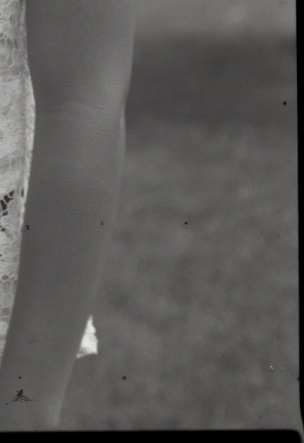

I recently developed a roll and I have a similar issue. I did not change my modus operandi and from the 4 films I developed with the same D76 batch, only the Acros got trouble...

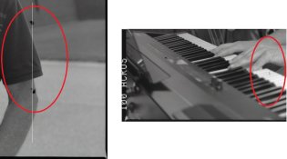

I never did solve this problem. I added a chrome alum pre-bath, switched to a hardening fixer, and maintained my temperatures to within one degree (68F). It's not everywhere, but it seems to consistently show up on a frame or two of every other roll I develop. I've had it happen with XTOL and HC-110, stainless and plastic tanks. The only thing I haven't changed is the camera -- I use a Yashica Mat 124G -- though I did experience it more than once with two different models.
After these last few rolls, I think I'm done with Acros.
ETA: Uploading a recent example.
The defect clearly comes from the film as I never got a similar issue issue with another film and my development process is pretty standard (D76 + rince + Ilford fixer + washing). Also developer, rince and fixer were done at 20-21 deg C. Only the final wash was 23 deg C. I don't why a +3 deg difference would give such bad result... Like you, goodbye Acros.
