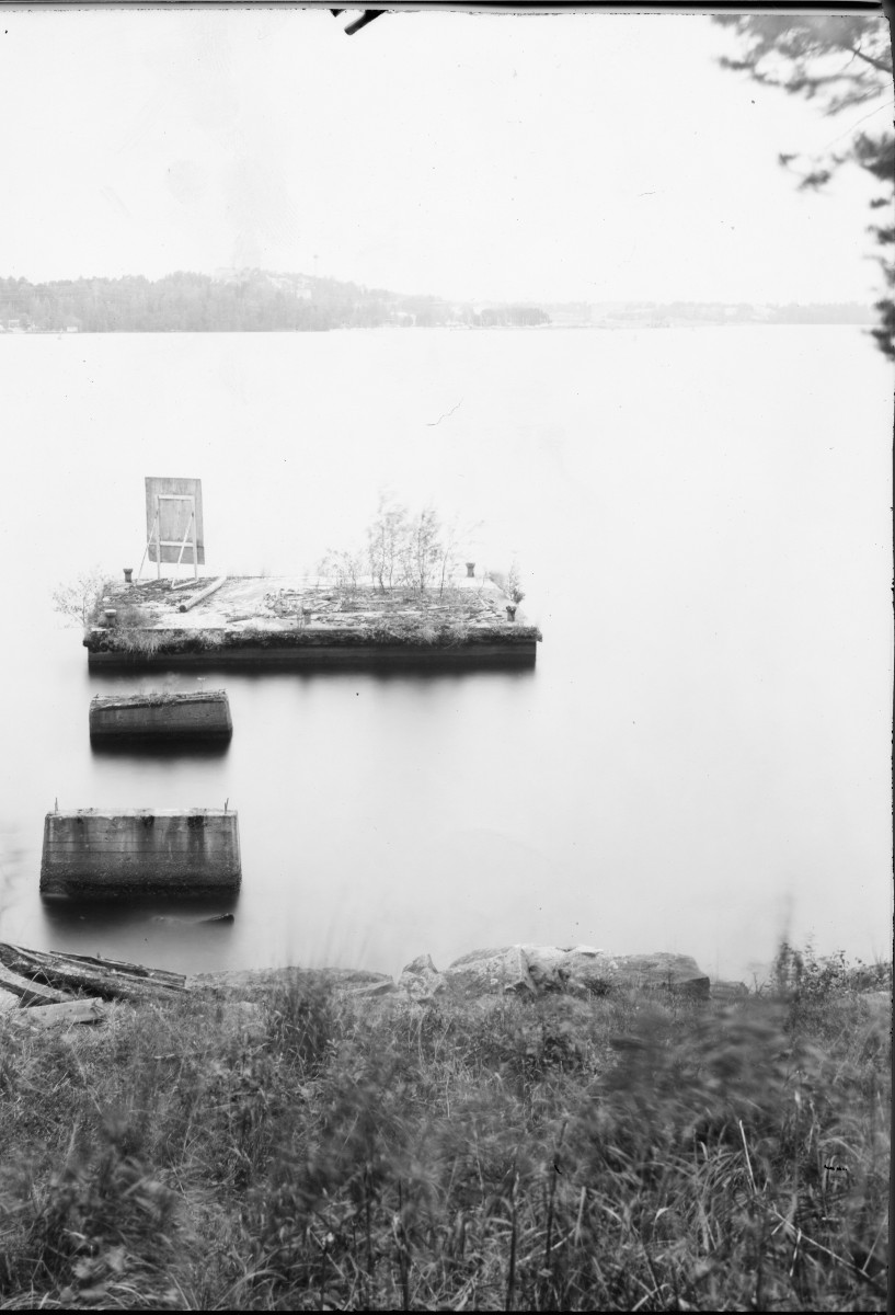

I bought an FKD 13x18 two days ago. It's made in 1980 and it seems that it hasn't been used before.

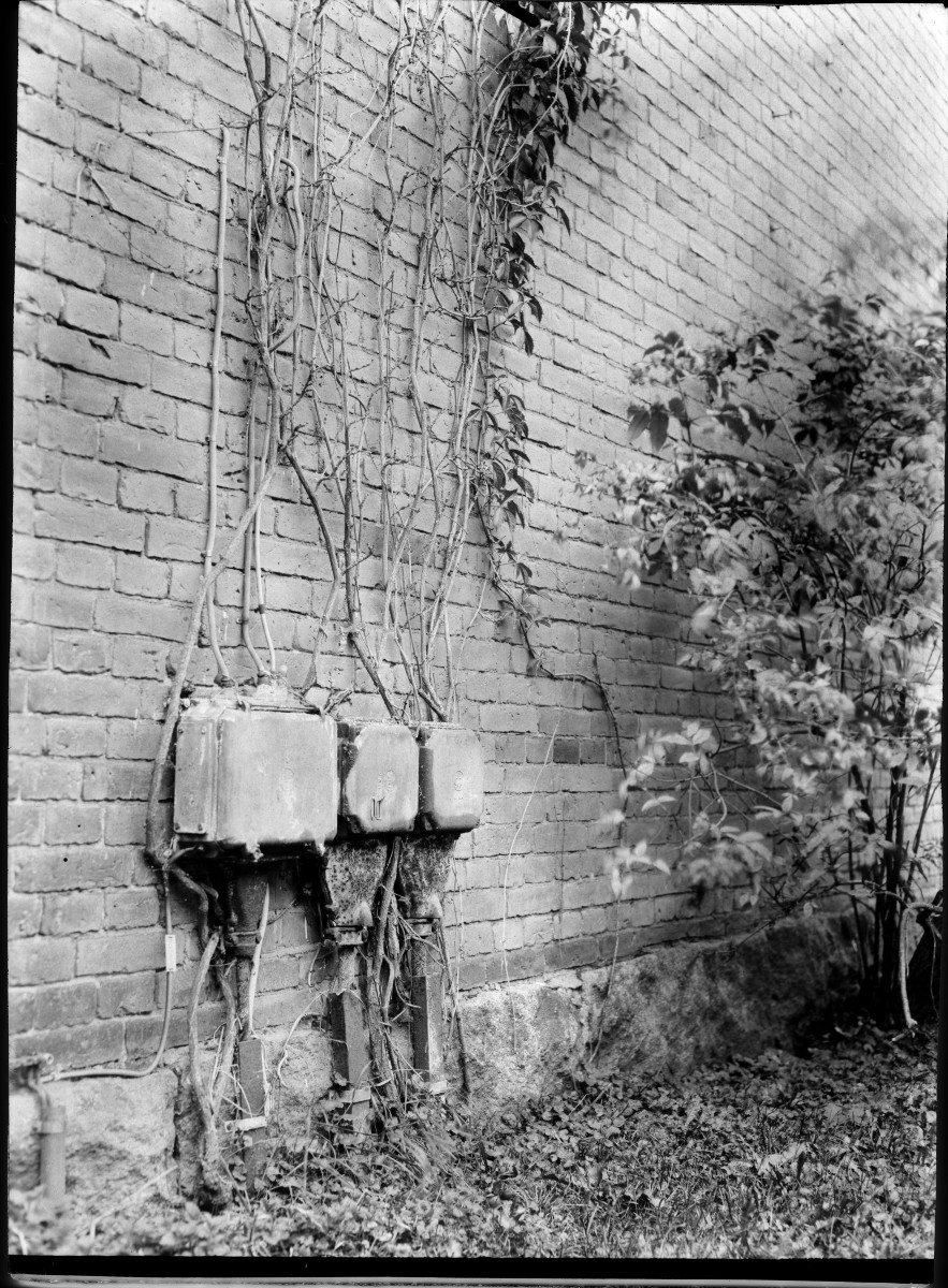

Yesterday I loaded some paper in it and tried it out. I developed the negatives today and it seems that film holders (actually they're plate holders, I just put some glassplates and paper in them) doesn't work. They hold film allright, but they also leak light in. I knew that Soviet products are far from top quality, but who should have guessed that film holder is made of material which let's light through? Two of the negatives have checkerboard pattern like that in film holders... Cardboard which separates two filmcompartments may be also leaking. The two negatives have some papery pattern also. Negatives are drying now, but I will post pictures later.
These are plastic film holders. Are wooden ones better quality? I wouldn't want to modify the camera if it's not necessary, because it's unused.

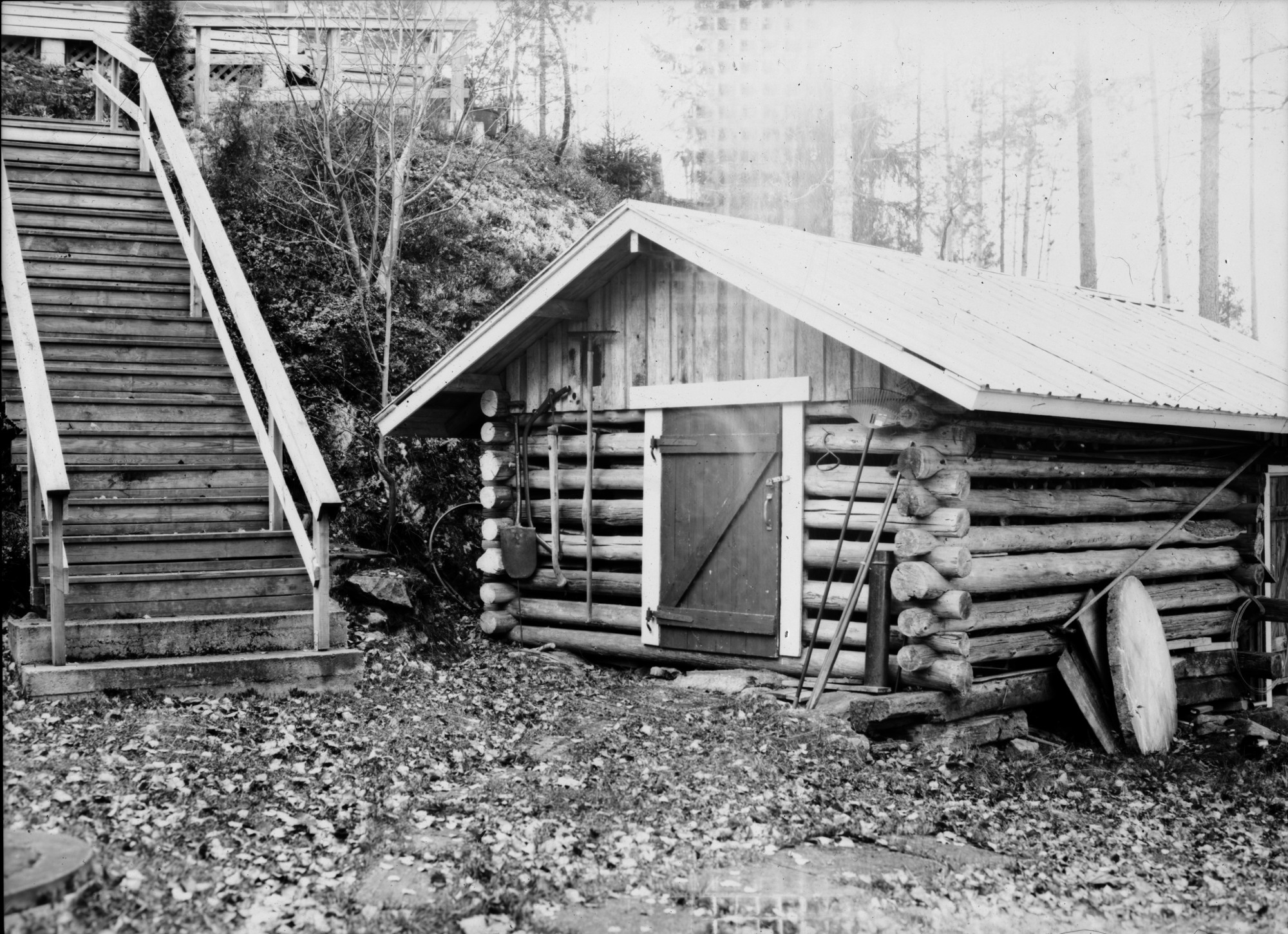

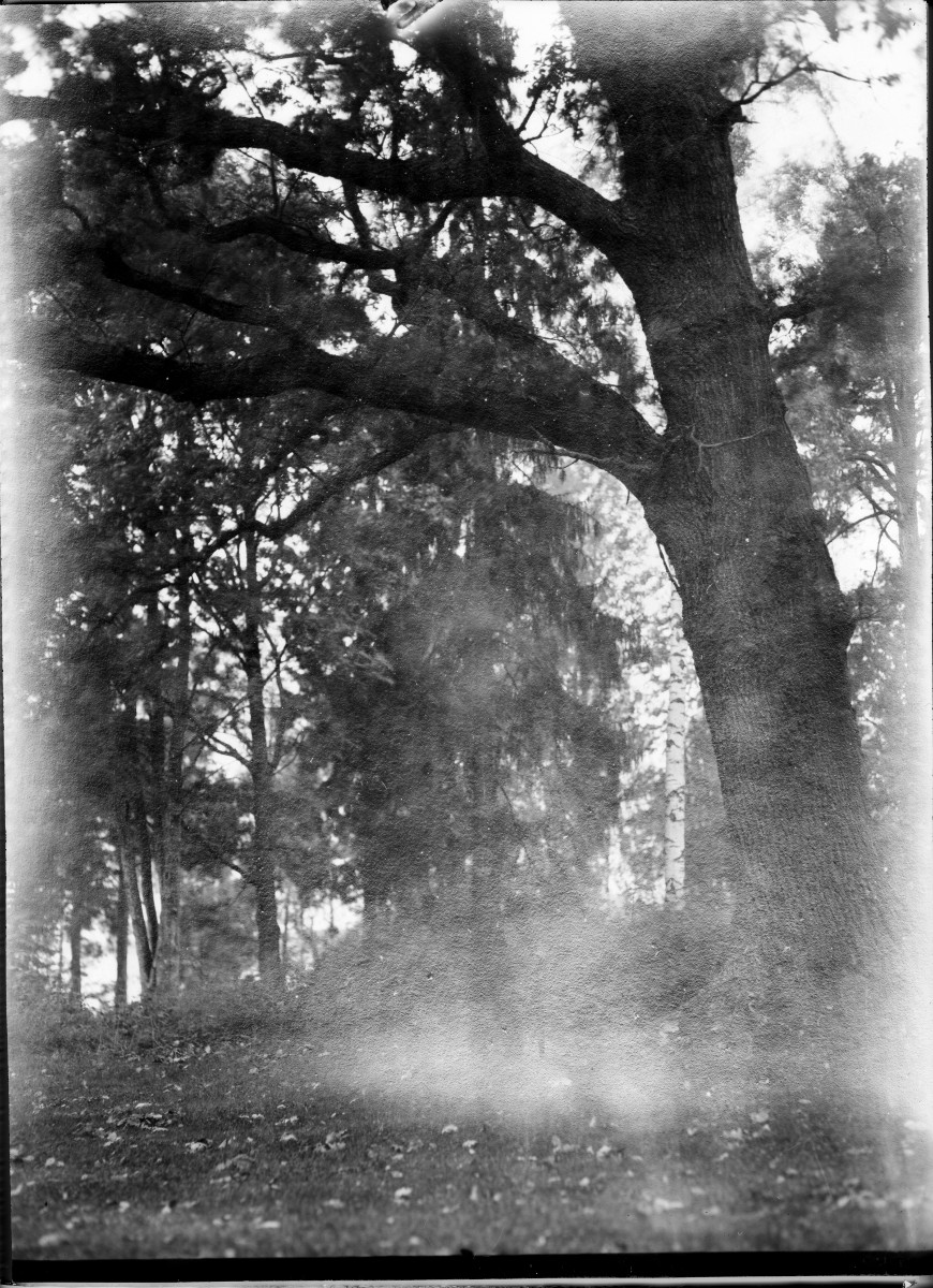

It seems that pictures one and three are better than two and four. Checkerboard pattern from film holder (or lens board, but I think that's unlikely) is visible only in number four.
I forgot pen and paper home so I couldn't keep notes, but they were all shot with 2-3 minutes of exposure. I think number one was with f/22, two and four f/8 and three maybe f/11. Pictures are in order which I shot them. It's odd that only other side of both holders have this problem while the other side looks fine in that respect, though number three has bad light leaks on edges.
What do you think?
Maybe I should just load film holders, put them outside for ten minutes and develop them.

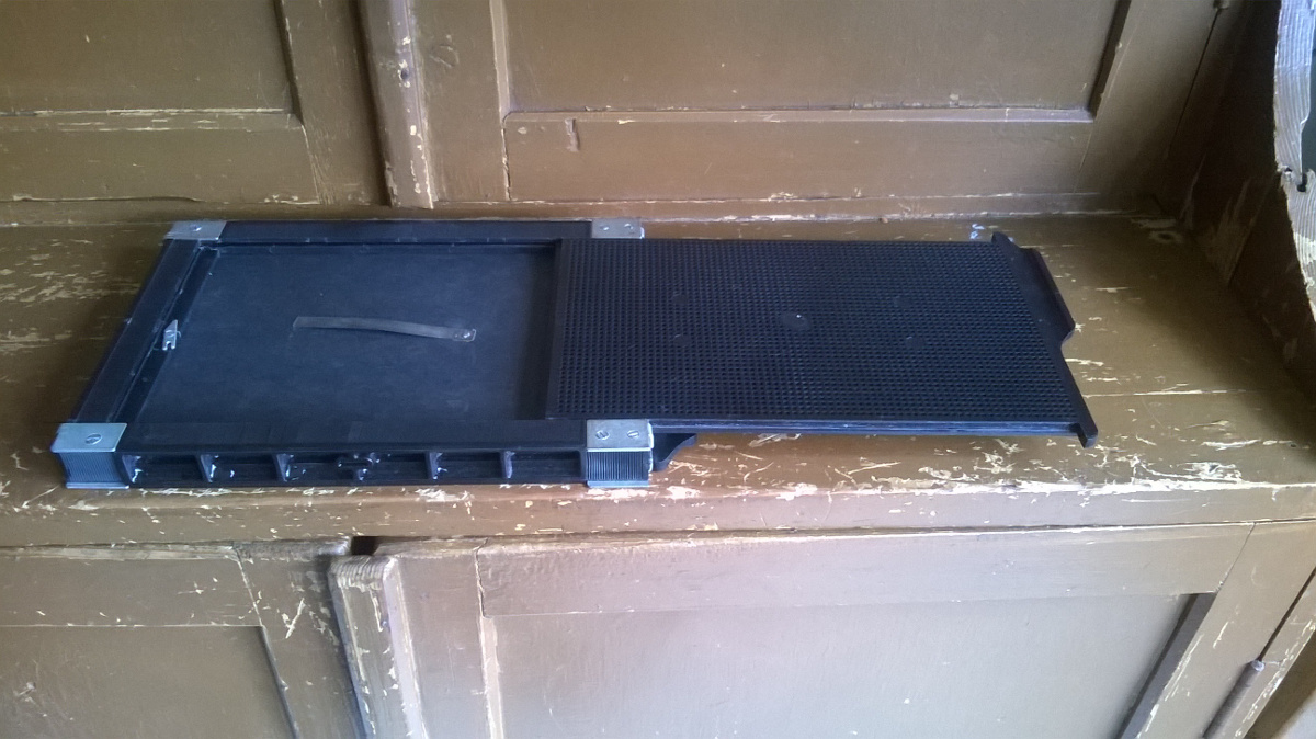

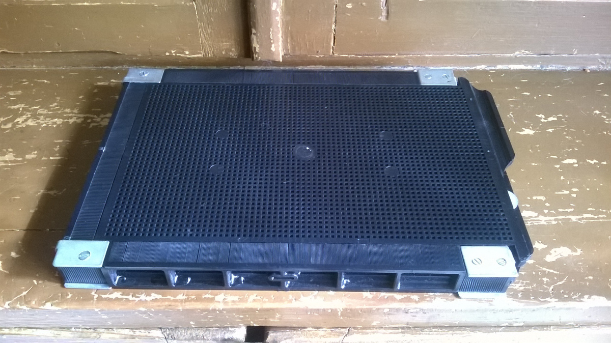

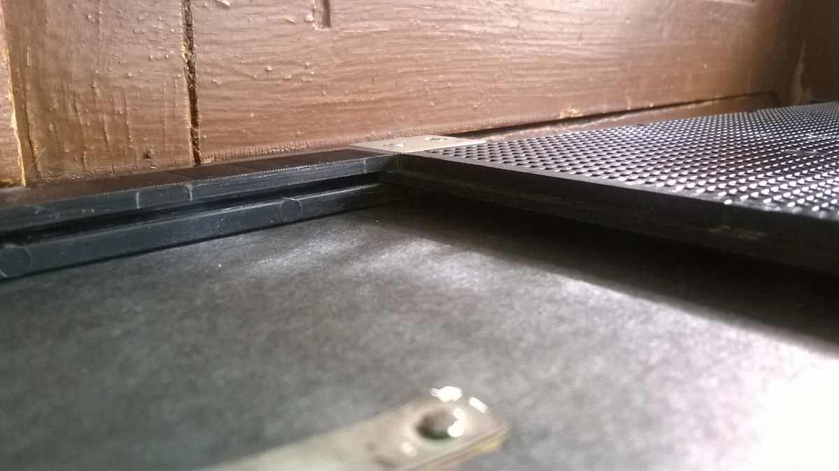

Can you show us the plateholders too?
They are black and don't seem very translucent, but maybe matt black spray paint could help.

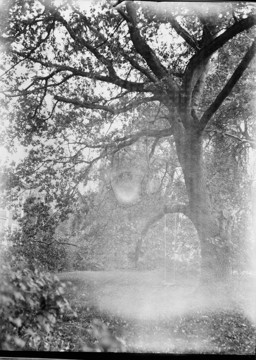

I had the same problem with my FKD18x24 for the first time now. It's the same camera, just a bit larger. I also had the checkerboard pattern on my negatives - a pattern that is the same as the dark slides.
I wasn't sure if it was caused by light-leaking-through-the-slide or during exposure. I had been wandering around on a very sunny day, carrying the camera with filmholder and tripod on my shoulder in the field in the full sun. So it might be true that the plastic dark slide isn't light proof indeed - at least not in full sun light.
I'm still planning on testing this, by loading a film holder in complete darkness with photo paper, put it in direct sunlight for 30 minutes or so and then develop the paper.

-) I see a checkerboard structure only in one image, and only because I got hinted at by the text.
A test would be easy: set a patch of aluminium foil on a holder, load it and expose under strong light.
You're right, it's only in one.
I put some sealing between camera back and film holder as it seemed little loose. Pictures two and four show quite a similar light leaks even if they are different holders. I thought that maybe it's not only holders which are leaking...

I loaded the holders with paper, put them outside, waited 15 minutes, turned them over and waited another 15 min. One of the holders had quite a bad leakage. Sky was very cloudy, I wonder what would happen to fast film in direct sunlight... I know that at least two of the four slides are bad. Maybe it would be easiest to make new darkslides for all of them. They are very simple pieces of plastic after all.

It is puzzling. First I thought that the pattern on the slides has been cut too deep, but it's not. Material is faulty. I don't know if it's the age of the holders or were they like that when they were made. Especially that little round area in the center of slides let's light through.
