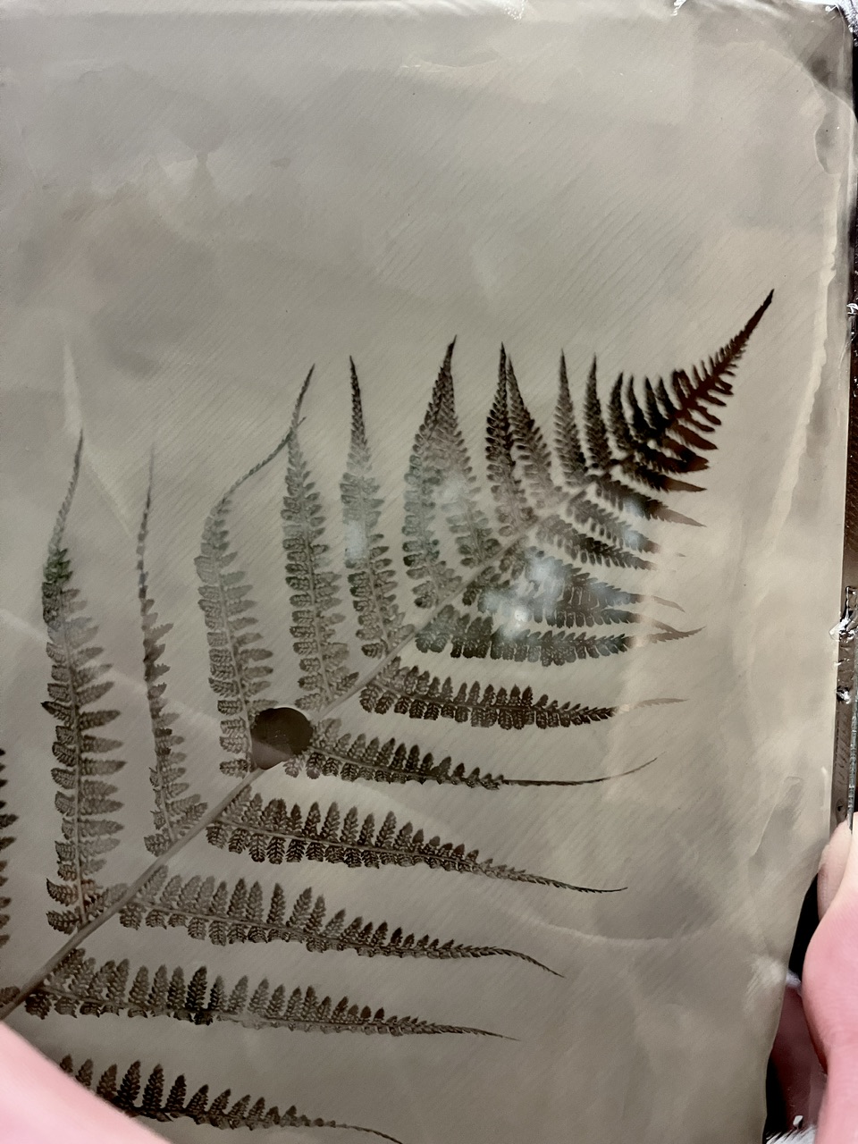

I made my first wet plate today. Very addictive and a lot to learn🙂
Fixer dilution was 1+4 and the plate cleared fast. I will try 1+10 next time to save a bit on the fixer solution cost.

Congratulations, well done! If that's your first plate, ever, you've really done a perfect job preparing everything. I bet that plate already looks very nice against a black background.
Don't hesitate to pour out a little more collodion on your next plate so it's easier to cover right up to the edges; you can let the excess flow back into the bottle.

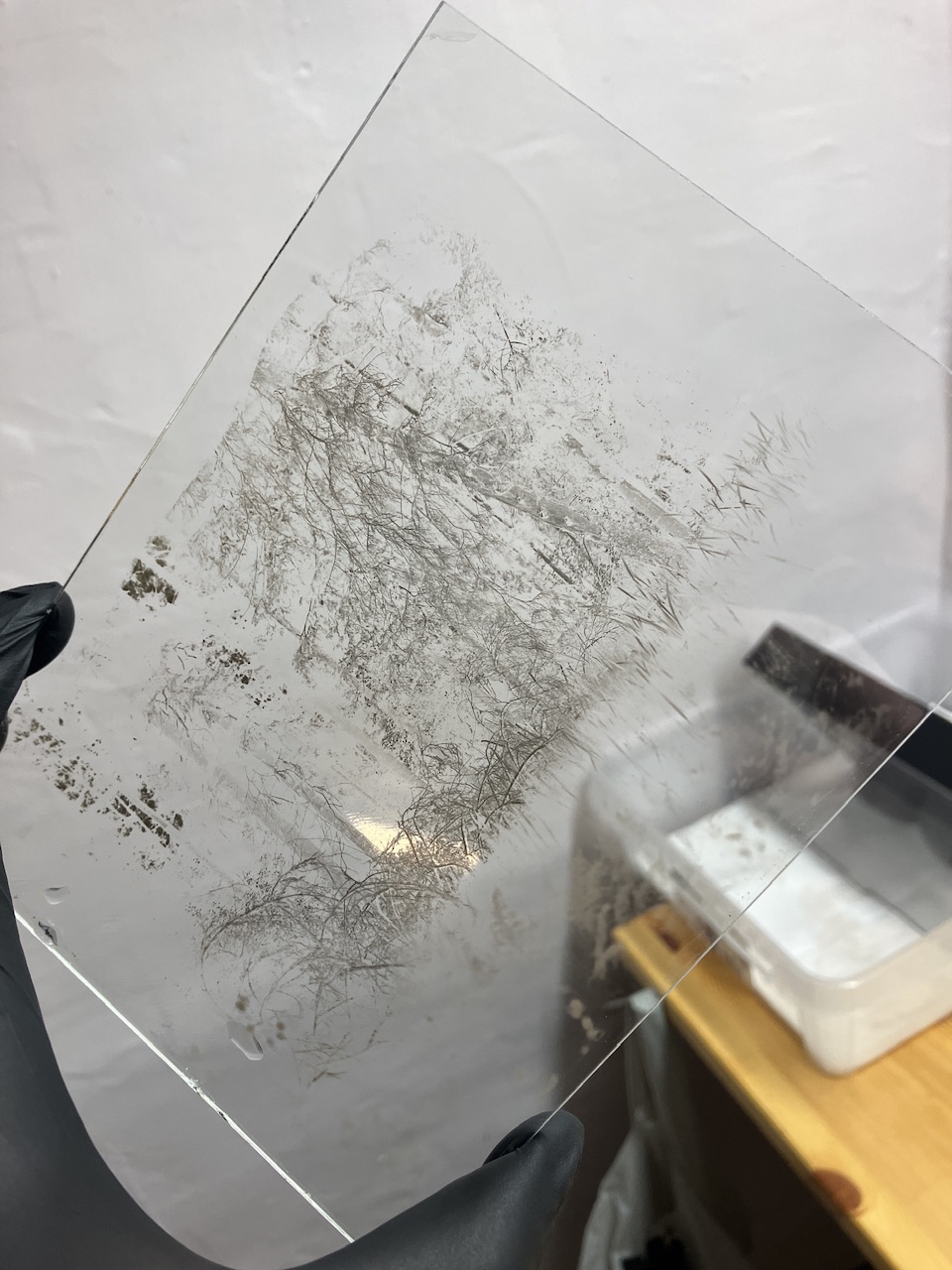

Everything except pouring the plates went very smoothly. Afterward I found out why. I poured the plates outside and the box with the cleaned glass plates was laying in the sun and I think the temperature of the plates was over 40 degrees Celsius. I think the ether and alcohol evaporated too quick when poured on the plate. I did 6 plates today and the first one was the best.

Yeah, that sounds like a good analysis.

Fixed in 1+10, no problem! Bit it was too hot at 30 degrees Celsius pouring collodion resulting in all kinds of imperfections. At least I got some practice👍
I need to pour collodion outside as my darkroom is a small 8 square meter basement containing the geothermal heat pump. I am afraid that the electronics like contactors and relays my cause sparks. Otherwise the darkroom have an almost constant temperature of 17-18 C.
Looking good! Yeah, be careful with the ether vapors. You won't get a combustible mixture of air and ether just by pouring a handful of plates, but if you happen to drop a bottle, you have a recipe for disaster. Ventilation would also be a good idea and the kind of space you describe often lacks this.
But...the plate looks great! You're getting the hang of this.
