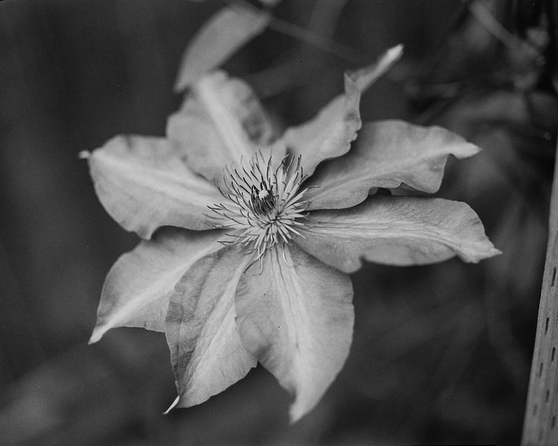

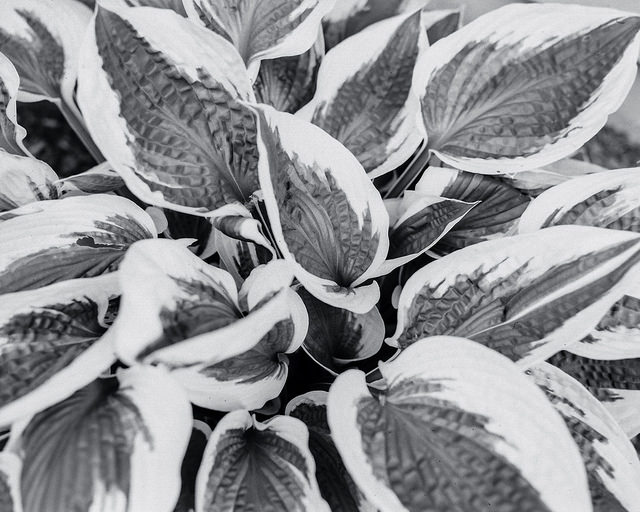

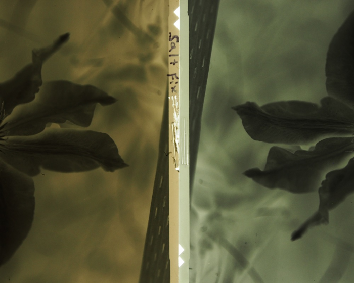

I did a few tests "fixing" in salt about 3 years ago. The negatives have been stored in the dark and still look good but I don't expect them to be archival. The reason I did this was because I travel for work a lot and often develop film in my hotel room. I wanted to see if I could develop (caffenol) and fix (salt) film with simple store bought chemistry. I mixed up 225g of iodized table salt into 750ml of distilled water (equivalent to 300g salt in 1L), that's about all the salt that can be dissolved in the water. I let it sit at room temperature for about 48 hours giving it agitation whenever I happened by. The first image is a comparison of two negatives, "salt fix" and normal fix. So far I have not needed to do this, I usually find a way to bring some fix with me.
I don't see why salt fixing should not be archival if carried out for long enough.
Fox Talbot stuck with quick fix salt stabilization because it gives a much better print color than the yellow obtained at long times .
