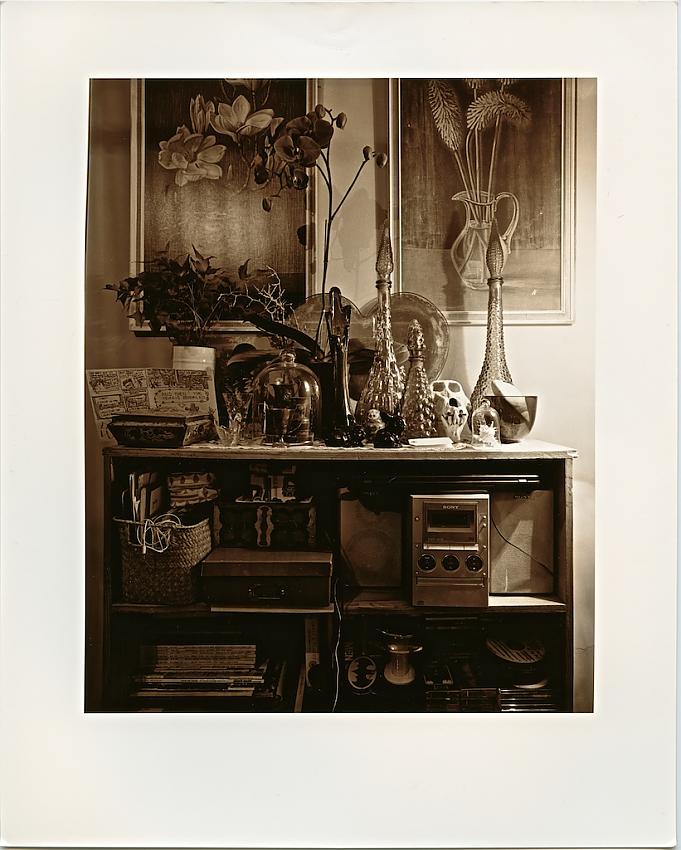

Thank you for the replies. Yes, I get a beautiful warmth in the highlights, I literally drag my prints through the sepia as it works very quickly after bleaching and then I give them a couple of minutes in selenium. So far it's a look that I love and works for me.
(there was a url link here which no longer exists) is an example of the toning effect I get from my process.

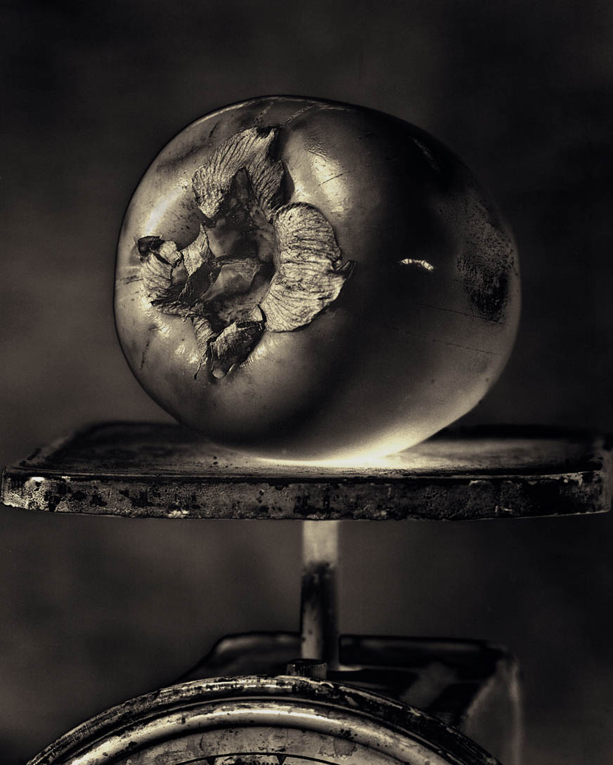

The bleaching takes quite a while, probably about 2-3 minutes or until I see the highlights coming out, then I snatch it out and put it into a tray of fresh water to rinse it. At this stage it seems to be very sensitive to sepia toning (I use Moersch sepia tone) and I literally drag it through. The print does not get more than 5 seconds in sepia as it acts very very quickly.
Funny how different people work
I use a bleach formula that is very strong by comparison, and I try to be in the bleach no more than 40 seconds, sometimes I just dip it in the bleach for 5-10 seconds to get a hint of sepia in the high regions.
I have found that having running water and a aluminum sheet on a tray to immediately wash off the bleach is very handy.

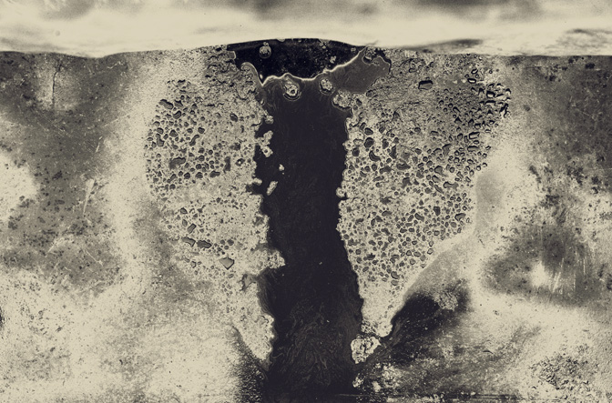

One thing I learned from Bill Schawb is to build up the tone by bleaching, washing, tone, then re bleaching / toning until I get the desired tone I am looking for.
This allows more control of the colour and actually not a pain by adding more time as it is a very fast sequence.
I am doing a series of prints for a personal show in California right now where I need to bleach the print to lift the highlights , then fix , hypo clear wash as normal.
then do a quad tone sequence.
This allows me to bleach lightly to get tone in highlight only, then gold tone for the upper mid-tones, selenium for the shadows and then horror of horrors add a blue tone that seems to want to attach itself to the lower mid-tones. I do this on Ilford Matt paper which really likes toning and the effect if I do it correctly is beautiful.
Since Solarizations try to move everything to middle grey other than the maki lines, I have found that my toning sequence needs to be more sophisticated than any other print process I tone for. I feel that I am getting a handle on it now after quite a few prints. FWIW - this is one of the most rewarding parts of wet darkroom work, the ability to control the final look and create an intense emotion out of silver paper.

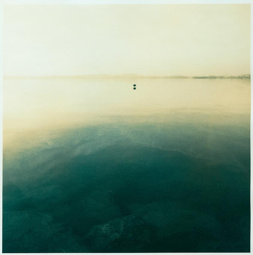

Thank you very much for your input, your examples are wonderful. It is funny how different people work. Much like food and cooking, we develop a relationship with the materials and 'get inside' how they work and think, or feel.
I have made a few prints where I used a bleach, sepia, blue tone sequence, which i love. I used my usual dilution for bleach and sepia to warm the high and mid tones. The blue seemed to hit the mid to dark tones which is exactly what I was after.
This was on Agfa MC 118 FB
