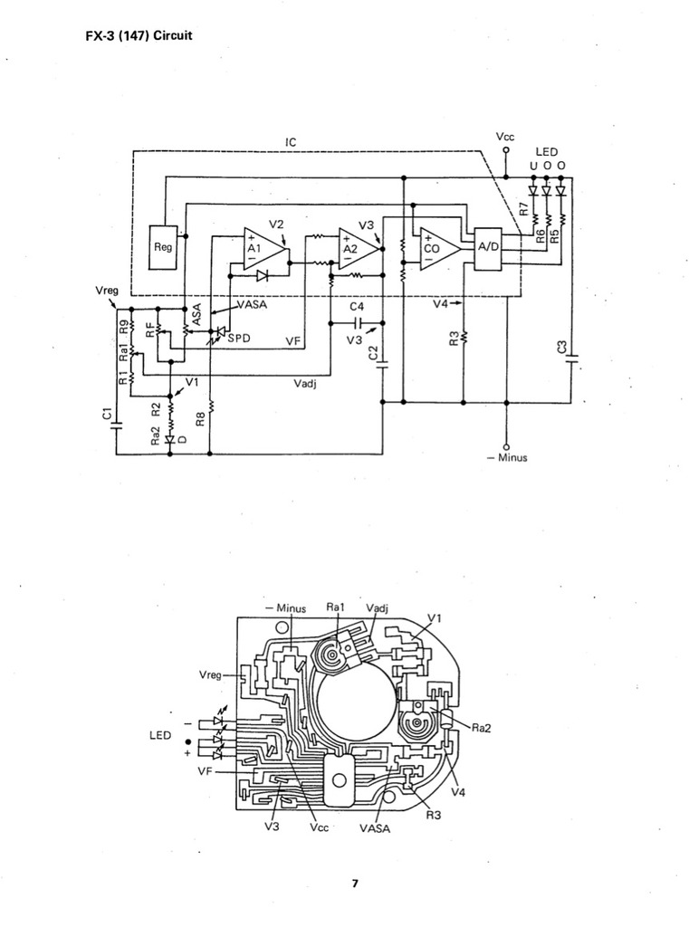

Since this thread has been resurrected, I have a question. I have an fx3 in good condition but the meter is off about a stop or so. How do I adjust the meter on this camera?
Another great thing about the FX3, adjustable meter! Under the rewind crank is a thin cover for the access site. Check the repair manual for instructions on how to do it.

hello iracer could you help me with my yashica fx-3 too, focusing screen was damage by liquid. i need help to open and clean it. hope you notice
Just seeing this now. The FX-3 service manual is available on the internet and explains how to open it. But, if the screen is damaged, you will likely need to buy a second camera just for the screen.
