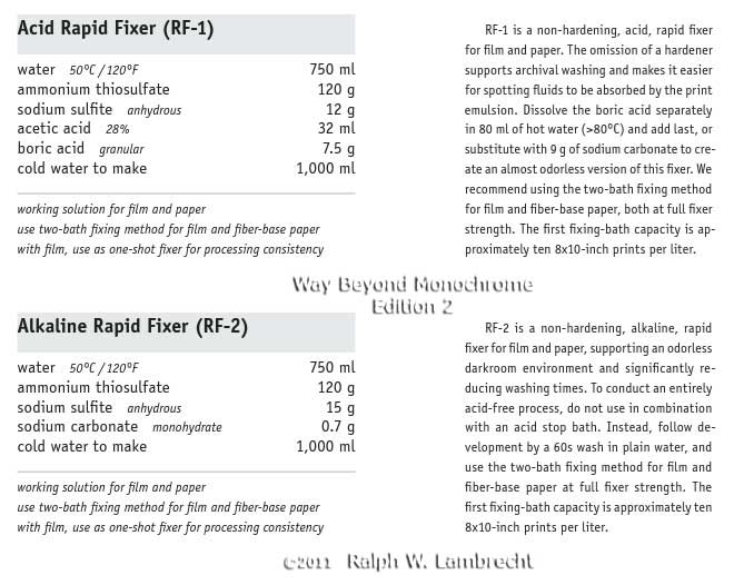

Looking for a good formula for fixer. Currently using TF-4 and love the stuff. However shipping of the liquid is a bit expensive, and the kit from Formulary is a bit high as well. Would like to mix my own fixer, so if anyone has experience with this let me know. Thanks
I'll throw in a couple for self-mixing, one acid, one alkaline but both rapid and non-hardening. II don't know how they compare to TF-4, but I've tested and used both with success.
