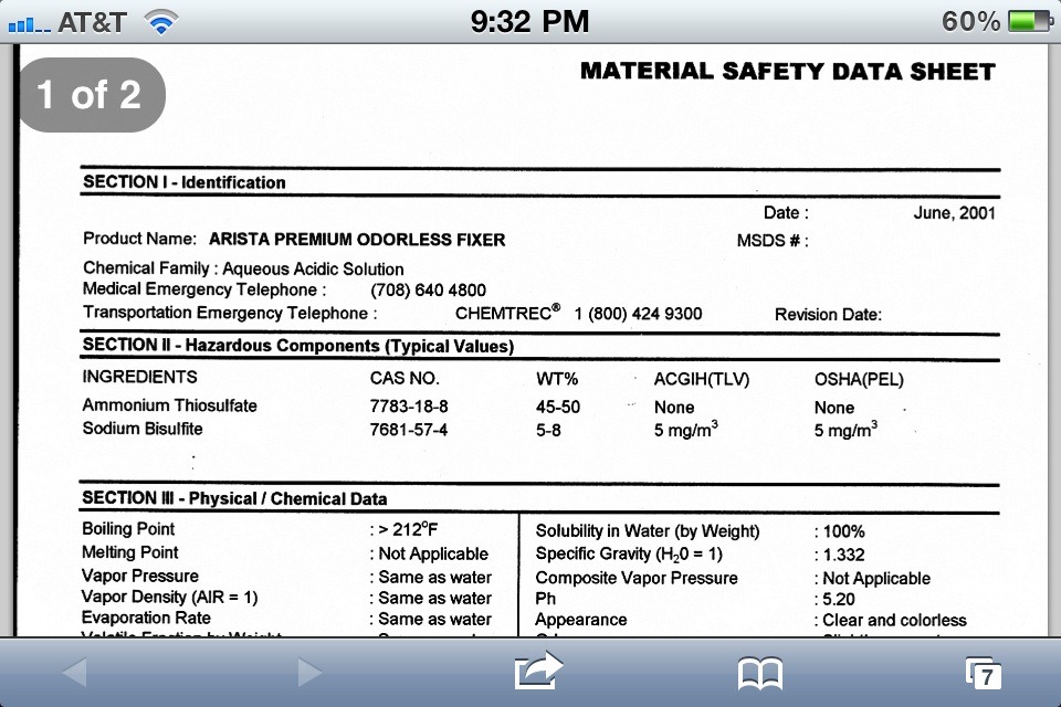

I've been using Arista oderless fixer for several years in liquid form. Now that I'm no longer in los angeles, the xtra shipping charges are $$$$$ and I'd rather mix my own anyway. It contains
Ammonium thiosulfate
Sodium bisulfite
Who's got a formula for me that uses these chemicals?
Here's the msds

Bruce, your formula makes an alkaline fixer while wildbill's ingredients make a rather acidic fixer. Sodium bisulfite by itself is quite acidic and it is usually used together with sodium sulfite. Look (there was a url link here which no longer exists) for a popular recipe. Since sodium sulfite is not overly toxic there is a chance it doesn't show up on your msds.
If you are absolutely determined to make it work without sodium sulfite, think of two things:
  • If your pH drops too low, the thiosulfate will decompose and becomes ineffective. Stay above pH 4.5 at all times
  • The main reason why folks throw sulfite/bisulfite into the fixer is that it acts as preservative. If you use too little bisulfite, your fixer won't last for long (in terms of time, not capacity).
Combining these two might put you between a rock and a hard place, so I'd at least think about the recipe I linked to above.

just put 200 ml of ammonium thiosulfate + 20 gr of bisulfite, to 1 liter, it will be acidic but if you add another 20 gr of borax it will be almost neutral, if you add more borax it will smell like ammonia and become alkaline. borax can be substituted by a smaller amount of sodium carbonate, if PH is a concern you can buy test strips in some drugstore or internet sites.

It's quite possible that Arista fixer contains other chemicals but below the level where they need to be listed in an MSDS.
Actually Sodium Metabisulphite has often been used in fixers with no other sulphite present but it will only be mildly acidic in an Ammonium Thiosulphate based fixer, something stronger like Acetic acid needs to be used for true acid fixers - also some form of acid buffering when a fixer's possible going to be used with a hardener.
