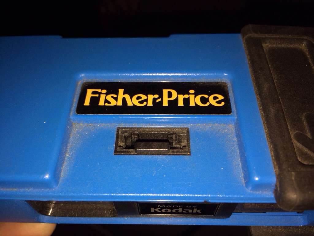

So I was cleaning out the attic today, and going through a lot of very very old boxes, and what should I come across but some really really very special camera equipment, one was my grandfather's old movie camera, but the other thing that I was excited about was that my first camera that I ever owned was discovered, at da!!
However as you can see there isn't much to it there's a shutter button and a cocking mechanism to set up for the next shot and that's about it, there's no kind of adjustments, it's a Fisher-Price camera so it was made for children so obviously that's why doesn't have much in the way of adjustment.
It does have a socket for one of those light flash bars, and I actually have a bunch of light bars that I bought off of eBay and then was going to get rid of because I decided I was going to stay away from 110 as I didn't really have a camera and didn't want to spend the money but then I found this!
Anyway I think they also might make a/electronic bar that's reusable for now I think maybe Lomography might make one?
Anyway the whole point of this post is what the heck to a shoot this set is there any kind of knowledge as far as what the exposure shutter speed would be an aperture? It's fixed aperture and shutter speed but it would be nice to know what the ideal lighting situations would be for this camera, and I do know that they do have some 110 film available new, as much as I used to shoot a lot of color as a kid I think for this camera I would probably enjoy shooting black-and-white mostly, so do I get the 100 speed film or the 400 speed film and in what situations can I shoot either?
ANY info would be awesome!
Thanks!

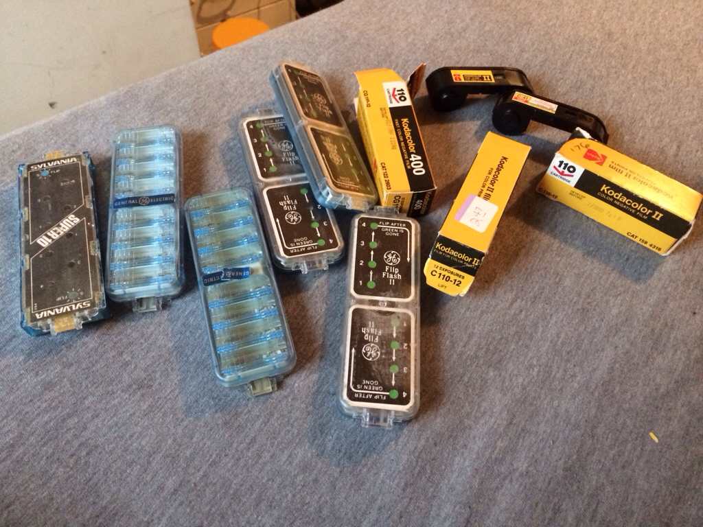

I'm not sure of the difference between the regular and advanced type, I seem to have two types altogether there are the ones by GE that's General Electric, they each have four flashes on each side of the flip flash, their simple to use and I remember using them as a kid so it's not confusing to me at all, and then I have one of another version that has five on each side instead and it's called a "super 10" made by Sylvania, I know it may be a waste but I tested a bulb in each of them and they both work just fine, I'm not really sure of the other type that you're speaking about as you didn't tell me anything about them, but it's good to know that I have the right kind.

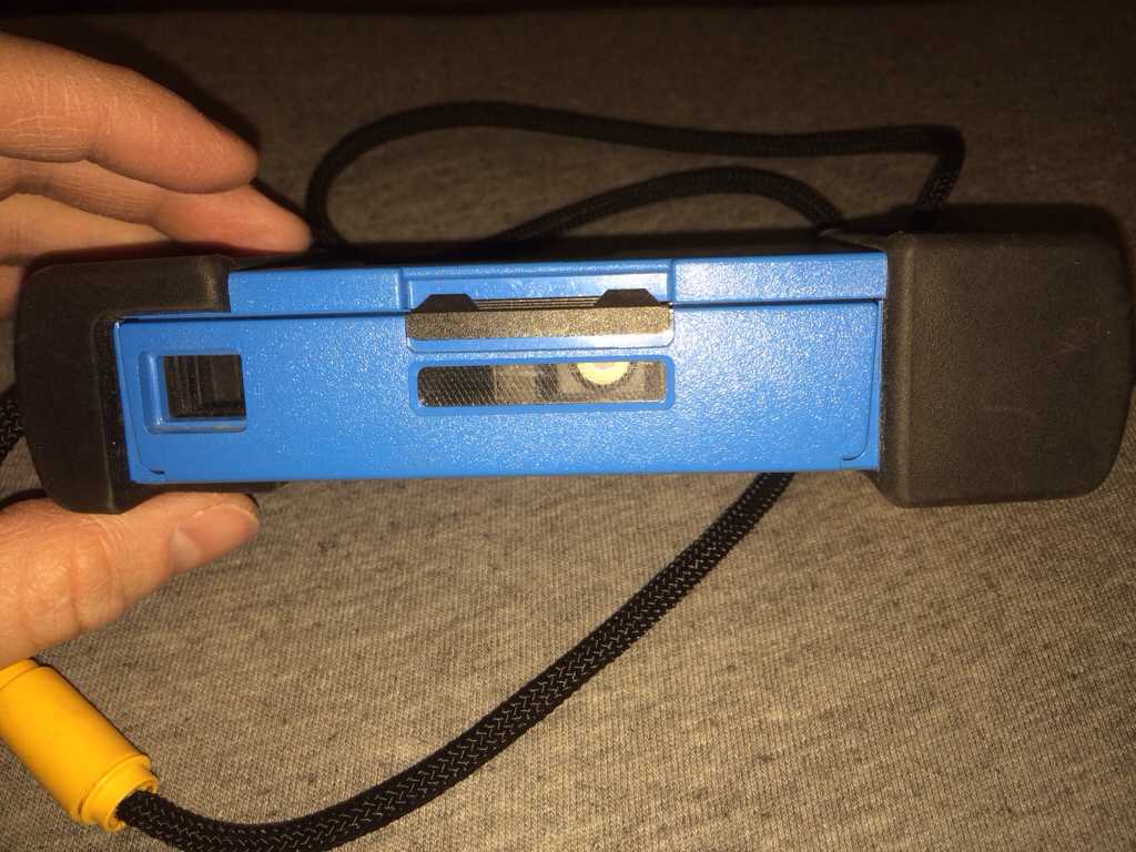

I do see what you mean about they top of the camera not being completely flush, it is flush on one side but not on the other so it depends on how the adapter is designed I suppose.
Pardon the dust...
I have looked everywhere on the Internet and couldn't find a single image of an adapter so if you could come up with the name of the adapter perhaps maybe that would be easier for me to find one.
It would be extremely amazing if I could find an adapter that had a hot shoe or even just a PC terminal and then I could add a hot shoe after, that would make a lot more creative things happen as I could simply adjust the flash exposure levels in order to make something really interesting. Heck I could even connected to my studio strobes with a pocket wizard and do some really fun things with that.

Oh I see, well I think I have that type actually, because when I flashed the flash to flashes went off at the same time, eek! I seem to have two different models, one has ... oh heck I'll just show you....
As you can see the contact points are different, one only has one side, while the other has both sides or something like that. The name on the flashes doesn't seem to change between the two different types, but obviously the contact points must of different in some way... They are both labeled "Flip Flash II"

There was Flip-Flash I and Flip-Flash II, with #I being the classic one.
Thank you for that contacts-photo.

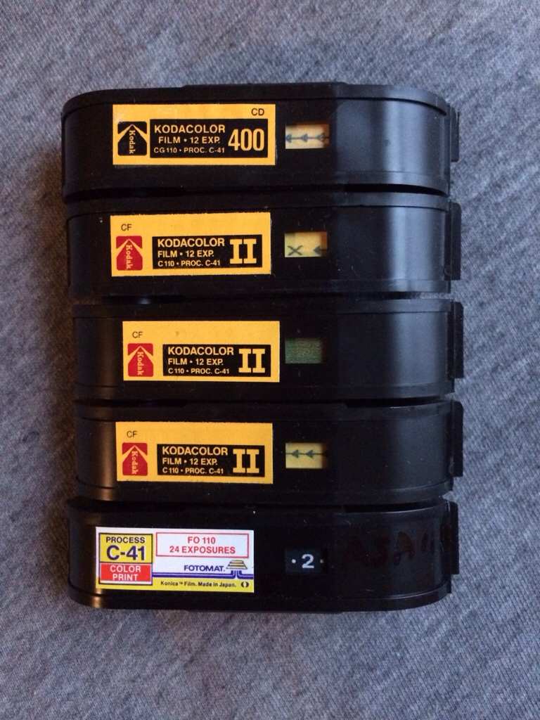

Update, someone mentioned that there might be some kind of little notch that would be different for 400 speed versus 100 speed I do see that I have mostly what I assume to be 100 speed film, the Kodacolor II... It expired in 1980 so there's no actual ASA film speed listed but there is one roll of "Fotomat C-41" film, that the original box said 100 speed film and I wrote that in marker on the cartridge, I was going to add some point change these cartridges out with 16mm film, but then decided that getting those notches done would be tedious, anyway the only role of 400 the film I have does seem to have a different and notch on it, it's just a little bit slightly more indented than the others, so I'm assuming that that's the notch that SOME cameras would use to identify the difference between the two film speed, however this simple camera is definitely not one of them, there's no little kind of switch or anything that is moved or adjusted when you insert the film so there's nothing to identify or change the shutter speed.
Anyway thanks for all the info and here's a picture

GE made a model that let you chose how many bulbs to let go off at one time.
This is unique in flash-bar photography.
I mixed up those flash-bars...
It is the Philips Topflash that offers the unique feature of deliberately firing several bulbs the same time.
The difference between the GE Flip-Flash I and II is the different location of the bulbs within the bar: square vs. row.
But more importand: the prisms array on front of each bulb at the #II with white reflectors behind them.

The notches were started (I think) on 126 film cartridges. I used to have a link for 110 notches, but cannot find it. Here is the best I can come up with at the moment, just to give you an idea:
http://retinarescue.com/110cassette.html
