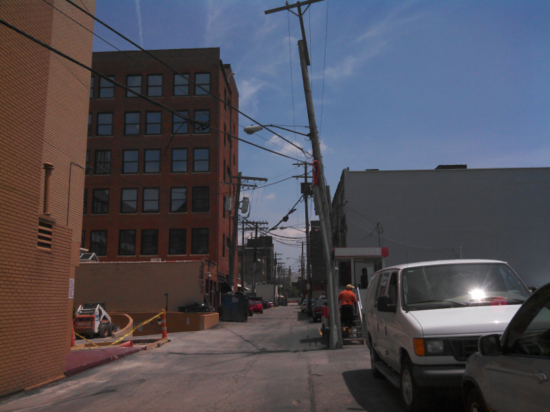

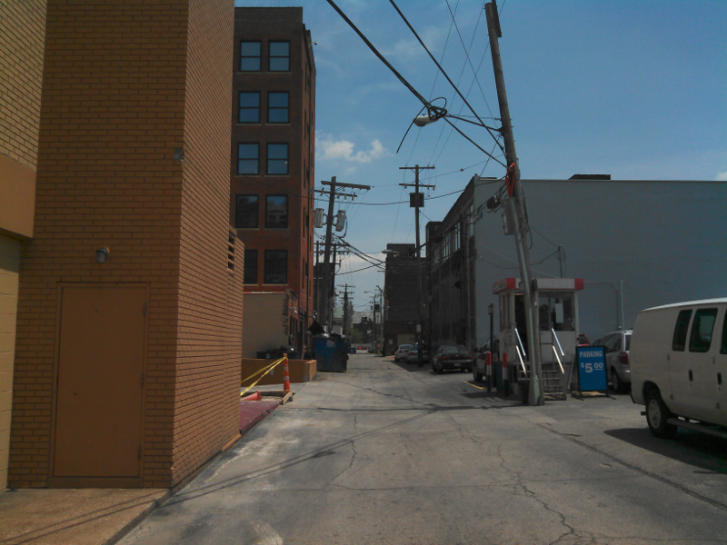

We don't need fisheyes in Cleveland:
If I stood in the right place, would a fisheye make those telephone poles look straight? :smile:
(Sorry to use bad cell-phone pictures for a bad joke.)
You need to keep the lens as level as possible to eliminate tilt with wide angle lenses. I suspect that it would give the best results for a fish eye lens.
It doesn't look like much from the pictures, but I was visiting one of the third-floor offices that is right by the pole on the left. Oddly, the bend seems much worse from the office than from the ground.
In the first photograph, the wall of the building is vertical, and the telephone pole leans to the left. Therefore the pole is leaning. Moreover the pole may be warped.
