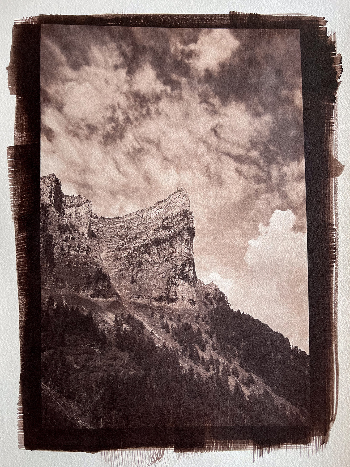

This one is my favourite, not only because it's one of my favourite places in the world (Tozal del Mallo in the Pyrenees, Ordesa National Park) but because was the first successfull one :D
Fabriano Artistico + gelatine + Acid emulsion + Gold Toner (Digital photo, GR1):

Nice examples of VDB. No doubt of that, VDB is a very nice and flexible process. I suggest you to try Selenium toner wit VDB, as well. However, the gold-toned Hahnemuhle Platinum Rag is intriguing. It should be more reddish-dark but it's almost indistinguishable of the untoned Hahnemuhle print. What toner have you used?
When I tested Fabriano Artistico with VDB my results showed less contrast than yours. Have you used a special treatment of the paper?

I tried Selenium in a couple of discarded copies because we didn't manage to get a "proper" colour, it gets brownish but....cold? a wird colour I don't know how to explain this one. Probably I was doing something wrong and it's in my list to test this. I gold toned with gold chloride 5% in emulsion, every time I tested it it gave me an improvement in "resolution" micro-contrast, not so much of colour/toning.
Regarding the treatment of the paper, It's "worked" sorry but don't finde the english word for this... basically put into hot water until fibers are ready to not stretch-expand any more once it's dried. Then just adding a gelatine coat with roller and the emulsion in dry.

Nice; looking good! I've always found VdB a nice and straightforward process, and gold toning makes (IMO) very nice prints indeed.
The Gold-Thioureea toning formula will give you an almost b&w image, with slightly reddish blacks.
Depends on how deeply one tones. Strong toning will produce a nearly neutral, somewhat blue/cool black tone. Tone a little more briefly or with more dilute toner, and you get pretty bright reds that dry down to some duller red-browns. That's my experience at least.
I never had much luck toning VdB's in normal selenium toner, but never tried compounding my own Se-toner without ammonia. That's the route I'd try. I got lots of bleaching, reduced dmax and a yellowish color that I personally didn't care for. Very similar to the middle example in your excellent comparison.
