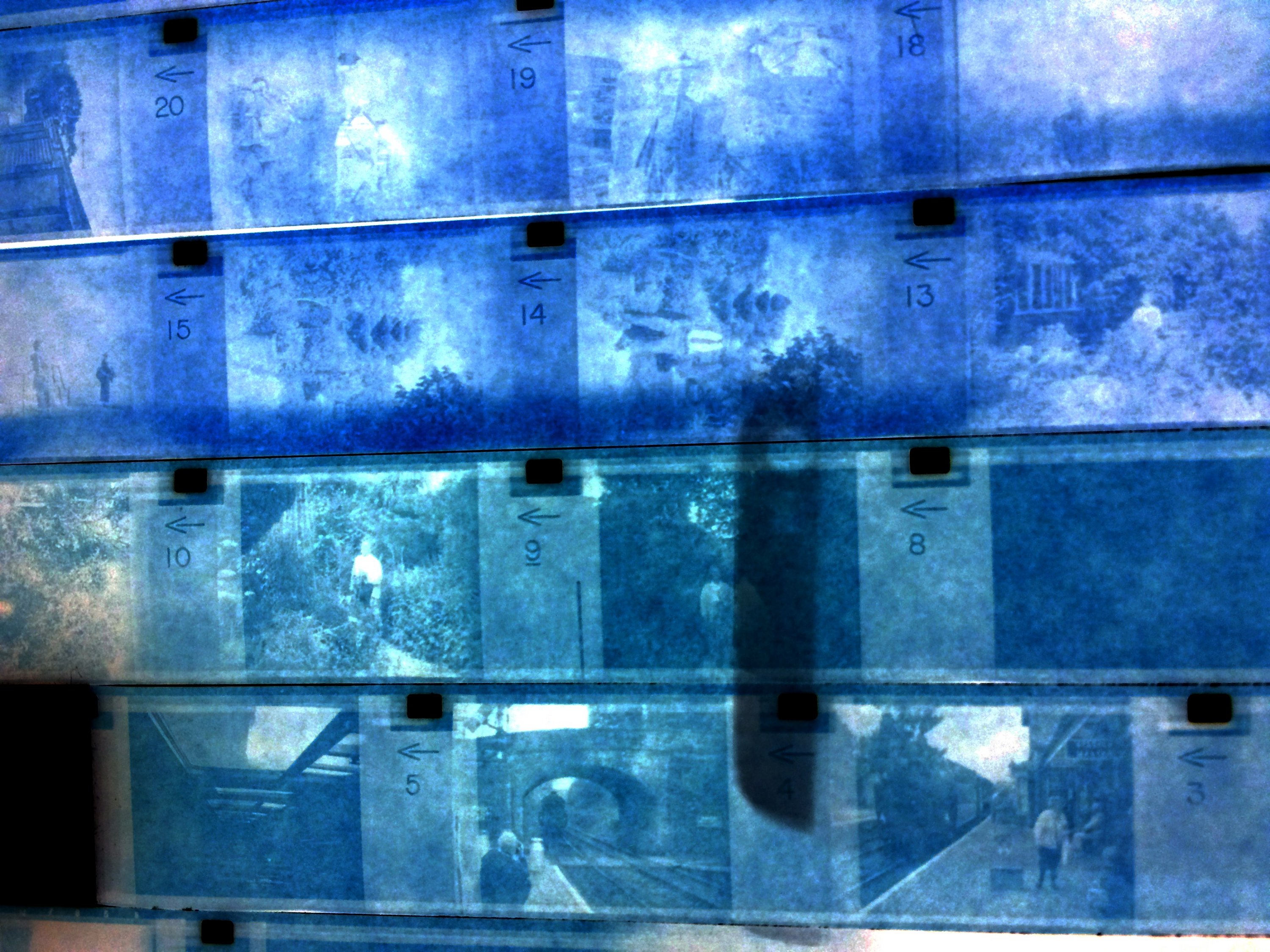

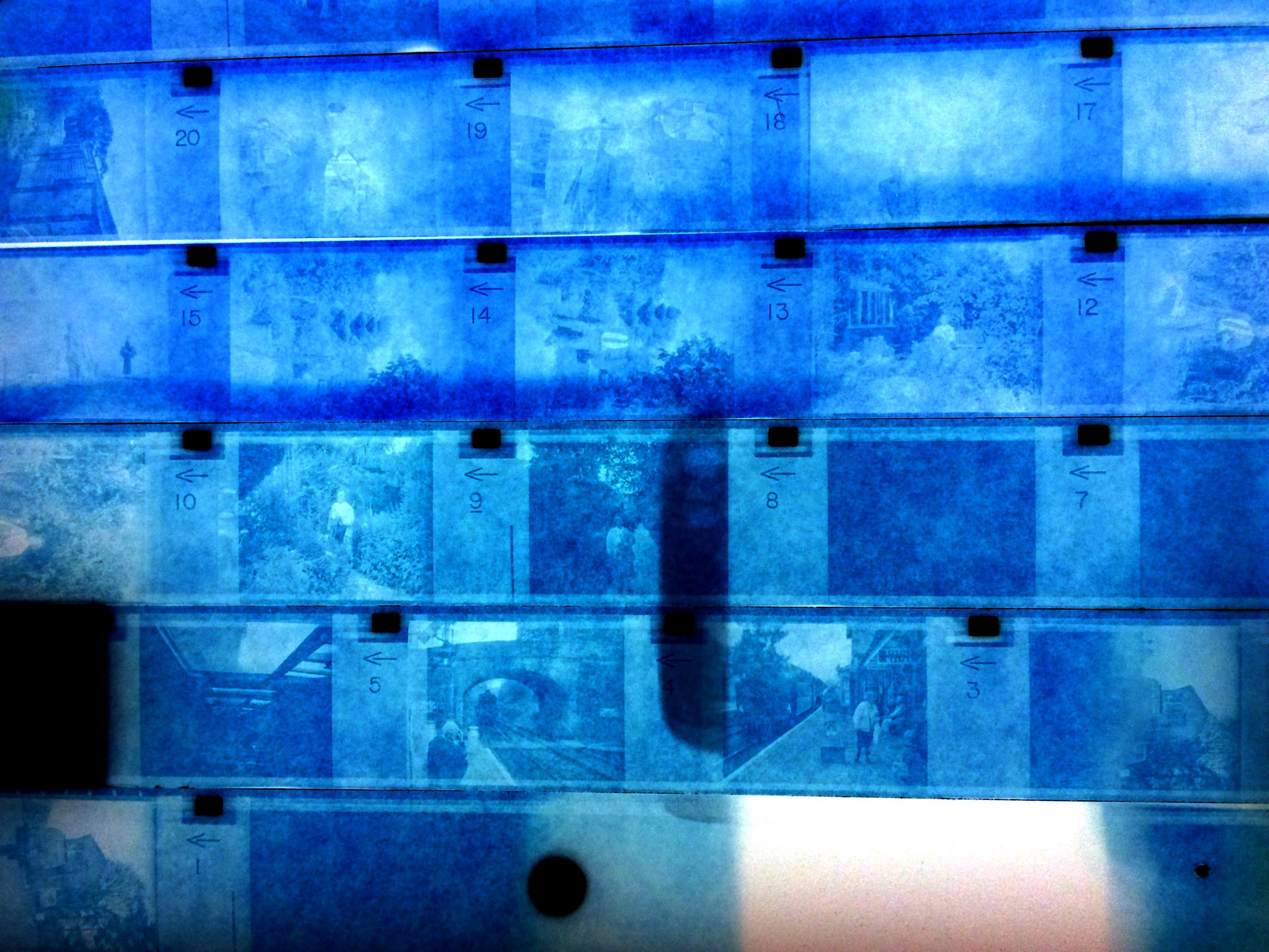

Ok, so for now at least this is about the best i can do. I know it's pretty crappy, but they are proving a nightmare!
This is just a couple of pics from my iPhone (you can see the reflected shadow from it) then used photoshop to invert and adjust to try and get them as clear as possible.
When i look at them with a 12x loupe they do look better, just really dark.
You can clearly see that they were developed differently between the top ones in Rodinal and the bottom ones in DDX

From what I can see here the Rodinal negatives are higher in fog, but also higher in contrast, and there is a nontrivial chance that the DD-X negatives will have just as much fog once they reach the same level of contrast. Whether you proceed with Rodinal or DD-X will depend on more personal than absolute factors:
  • DD-X is less sensitive to Potassium Bromide than Rodinal. If you have difficulties weighing small amounts, DD-X may be the easier choice.
  • Rodinal 1+100 is substantially cheaper per roll than DD-X.
  • Development with Rodinal 1+100 takes a lot longer than DD-X.

This is my thinking also, it's is easier to see what is going on with a eye loupe. The DDX negatives seem much easier to distinguish, i think the fog is just too high on the others.
Plus the Rodinal ones have the band along the bottom, is this possibly bromide drag? Or possibly the developer settling out the water? I read these can be possible issues when stand developing.
I am wondering, now that i have proven the film is still viable, it is worth getting a C41 kit. While there is deffo an image there, the colour layers of the film still being undeveloped are making the film so dark it's pretty much useless.
Unless there is something i can do to help with that without degrading the image?
You will be amazed what 1-2 g/l Potassium Bromide added to developer can do for you in such a situation. That's why I recommended that you take small (i.e. 1-2 frames max, ideally less) test clips and make tests with developer plus 1 g/l increments of Potassium Bromide. I realize that DD-X looks more attractive right now, but trust me that you can control fog with Rodinal + Bromide just as well. It's your call.
I am by no means experienced with stand development, but there are many people here in black&white forum who are, and there are many, many postings here about this topic. The little I have garnered from reading so far tells me that even with stand development one should agitate every 5-10 minutes in order to avoid exactly the inhomogeneity you describe here.
For undeveloped film: you can get quite far if you control fog with Potassium Bromide. As far as the film you already developed is concerned: you could try to salvage it with Farmer's reducer, there is a good chance you can get scannable images out of these strips.
