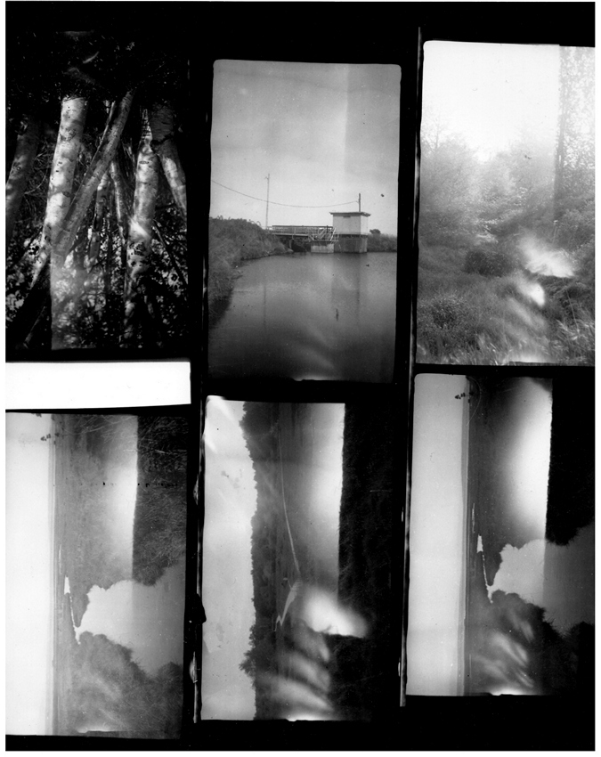

Those rolls look a lot like the 70 year old film that I exposed and developed last year.
They are of course, colour rather than B & W like my film, but their general appearance is similar (so dark and fogged looking that you can hardly see detail in them).
I got around to doing contact proof sheets of the rolls yesterday (I had a backlog!).
With 4 times the regular amount of exposure, the contact proof sheet came out reasonably well (see below). I'm going to try to print (optically) a couple of the results - I expect I'll get some usable results.
You will find the story in this thread: (there was a url link here which no longer exists).
The film is much larger than 110, but it shares with your film the fact that it was very difficult to scan. It isn't, however, impossible to scan. And it shouldn't be impossible to print.
I bring up this somewhat different set of facts to point out that the appearance of the negatives doesn't mean that they are unusable.
But I really do recommend getting a lab to try processing them in C41 chemistry. Send a note along indicating that they are old films, and will understand if the prints are less than optimal.

The mask has a fair amount of yellow in it.
As you are likely aware, a yellow filter is used with variable contrast paper to give you lower contrast prints.
So the challenge imposed by the mask is that it tends to give lower contrast results.
Good luck with the contact print. It may be clear, but those little prints are definitely not going to be large!.
