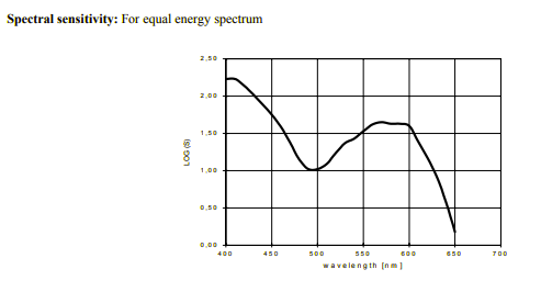

Thanks but it would be helpful if we know what the colours were in those pics of Huss. It may well be that it affects green and red although based on the jonno85uk's chart. It looks as if blue/cyan might be most affected then red to some extent

Thanks Huss. I'd say that based on the spectral sensitivily chart above and your reply, we may as well say it is ortho as near as damn it.
