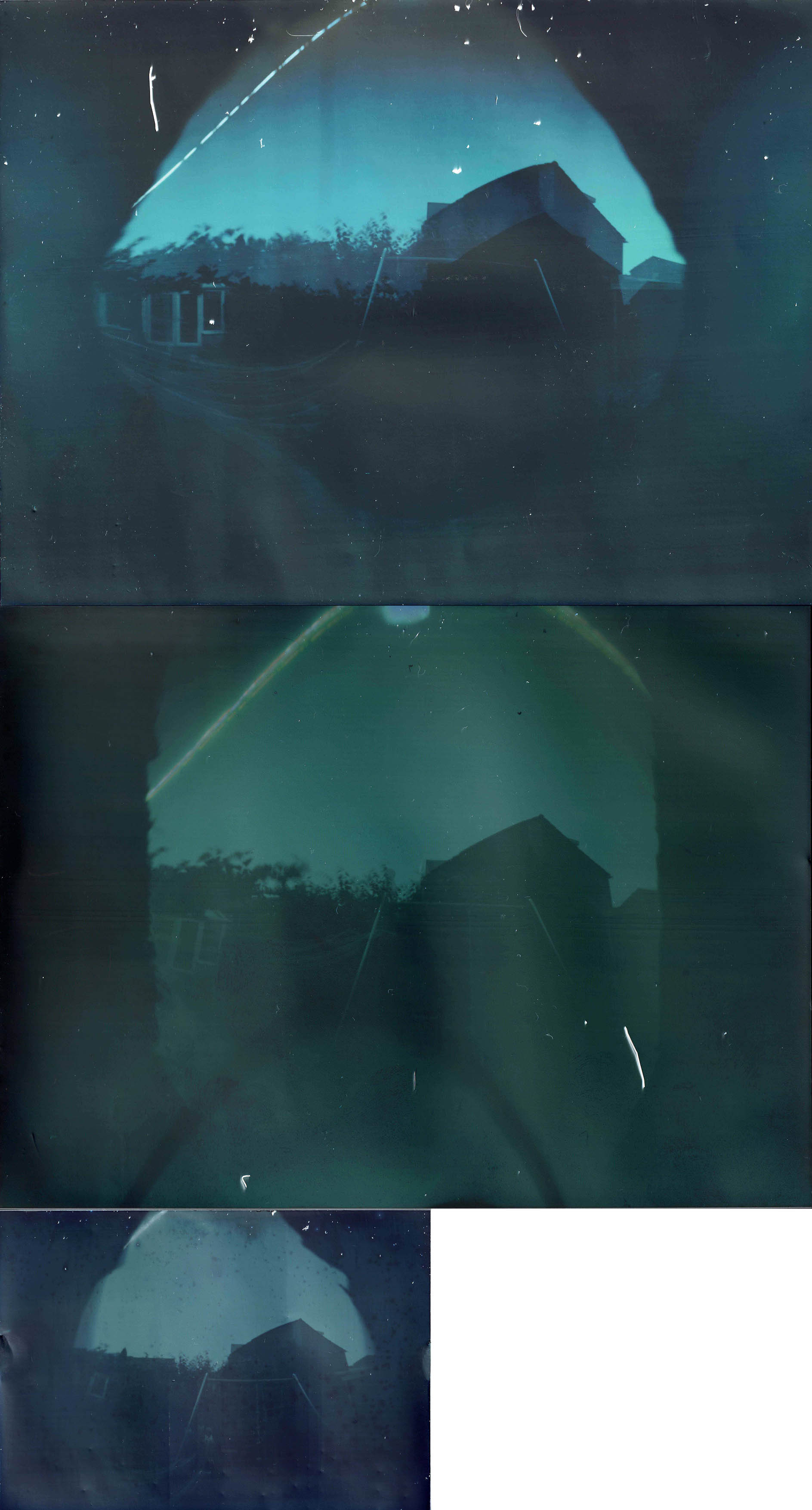

After 8 days 2,5 sunny the others rainy, we took it down to see if it worked.
Well it worked, only it paper was pretty moist.
I was able to make a scan of the paper.
It looked nice.
I inverted en mirror it in photoshop.
Now it looks like this.
I was wonder if the ghost trails were because I used glossy paper.
And is this much condensation normal for 8 day outdoors, or is it due to the materials used?
I think they're due to an internal reflection of some kind. This may even be a reflection against the edges of the pinhole itself.
Given the humid weather we've had lately, I'm surprised you didn't have more problems with moisture.
Oke, is there could also still have a reflection from the backside of the brass sheet metal, I have seen people coloring it black, so on the new one I will also do that.
From the solargraphs I have seen on the internet i didn't see/read much about moisture. But for the next one I will try and find a beter/dryer location.

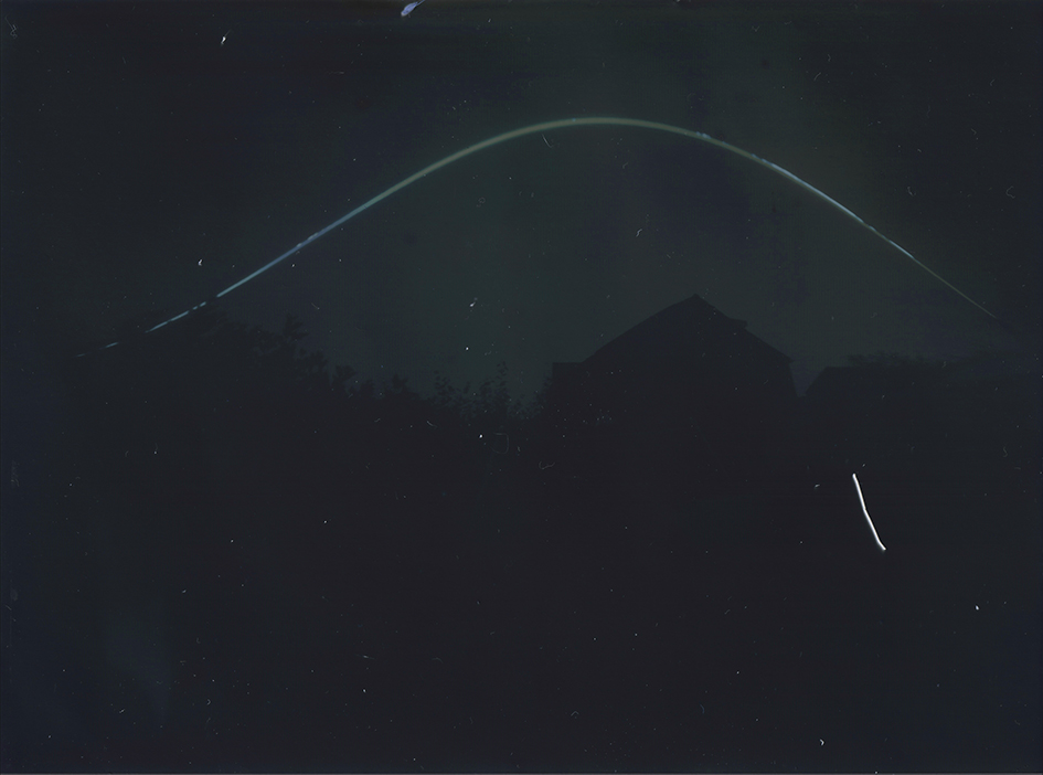

Update:
I have 3D printed a small one for 8.9x12.7mm. It was in the full rain, and it was really rainy last month. I put it up on April 24th and took it down on June 2nd.
This is the result (flipt, rotated and inverted):
My aim was too low, so the path of the sun was mostly on top and out of view. The strange thing is the dark sides. I first thought it was due to the small size. Then I took down and scanned the large one. It was also aimed far too low and also had the same dark sides and top.

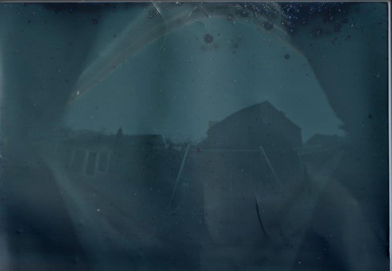

Result large one:
It was placed "dry" and the paper looked very nice.
Then I realized that it was probably the 3D design. Here is a close-up of the hole. I think it is far too small. On the inside the shape is the same.
I mean the hole in the tube not in the brass.
I think I have shadows/ obstruction of the tube.

Yes "ghost trails" can be caused by the shine from the inside of the rain pipe, the shine off glossy paper, or sometimes if water gets into the bottom of the can it will cause reflections like that. I spray paint the insides of my cans flat black and use "pearl surface" paper, but I think the ghost trails are kinda neat too...
My advice: don't worry about the size of the pinhole too much. If it's around .2 or .3 mm it will be fine. I punch a small hole in the bottom of the can and push a little piece of foam into it.... this blocks light but allows water to drain. In my location there is so much condensation that the can will sometimes fill all the way up to the pinhole if there isn't some way for it to drain :smile:
Here's one I picked up just a couple days ago: link to ipernity
On that one, the paper got damp then dried and curled... causing the "ghost image" because the curl changed the position of the paper. There are a few ways to prevent that ( something to hold the paper ) but I don't bother usually. I kinda like ghost images too. Go with the flow and have a nice surprise to open and see what you get!
Oh, and the little speckles are tiny bugs that got in through the pinhole! Happens on the ones I pick up in June, but not so much on the December ones.
Really? I would expect that the roof overhang for the second attempt / large sheet was the main problem:
That would be smack in the field of view, wouldn't it?
Thanks so much!
Good progress, too.
That could also be a problem indeed, but the small one also has it al around the picture. But that is also worth a test indeed.
Yeah, but that one has it to the sides, which makes sense since the paper sites in a circle, so some parts will barely get any exposure. The top edge on the large sheet is likely caused by the overhanging gutter.
Now i look a the picture, you are probably right, you can already see the shadow on the wall, it is almost the same height as the tube.....

I think your analysis of the supporting hole being too small is quite likely good. Unlike lens-based designs that can sort of funnel light rays through an opening, a pinhole is just straight ray tracing and it is surprising how much peripheral "stuff" winds up getting in the way. I had to totally re-do a design of a sliding flap shutter after finding major vignetting.
I have sometimes found it useful to do a carefully measured scale layout of a cross section to look for possible interference. My pinhole cameras have been boxes targeted at regular photographs, no doubt your cylindrical "film chamber" can add some additional fun to that process.

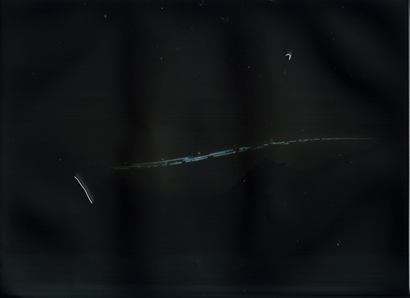

Update:
I have made the holes larger and now running a test week (if there are a few days with sun i hopefully know enough)
Here's the test setup:
Here is a small update.
The first part is the following of the last post.
The photo's are still not what i hoped for, but I learned more and 3d printed some new desigs.
It took a while before I had time to make a new stand and test the new stand and 3d print, with the following result.
That looks a lot better, so i directly tried a special version with a arduino in it. But it did not yet work as i hoped. I have still some stuff to find out.
The new one has some dark spots in it which i can not explain yet. So now i have the latest version installed and I will be waiting for a few weeks because of the time off the year and to get a clear picture.
