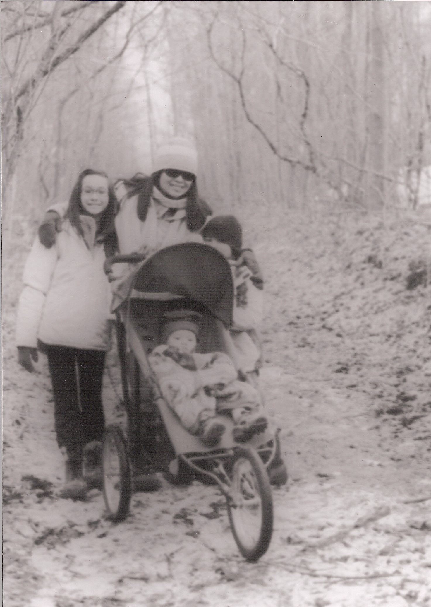

Hi,
I just recently acquired a free darkroom (really old stuff, but everything seems functional). I have several developing tanks & reels, a couple of DeJur enlargers, trays, tongs, etc. Pretty much everything except a safelight. I purchased a Pentax ME off of ebay for $34 shipped, shot a couple roles of TMax 100, purchased the chemicals and developed the first role. It didn't come out that great as I had a hard time with the film wrinkling up when loading on the SS reel. I found with the second reel I developed that I was pulling the film onto the reel and I believe the trick is to feed it on without any pressure in either direction. The second reel came out great.

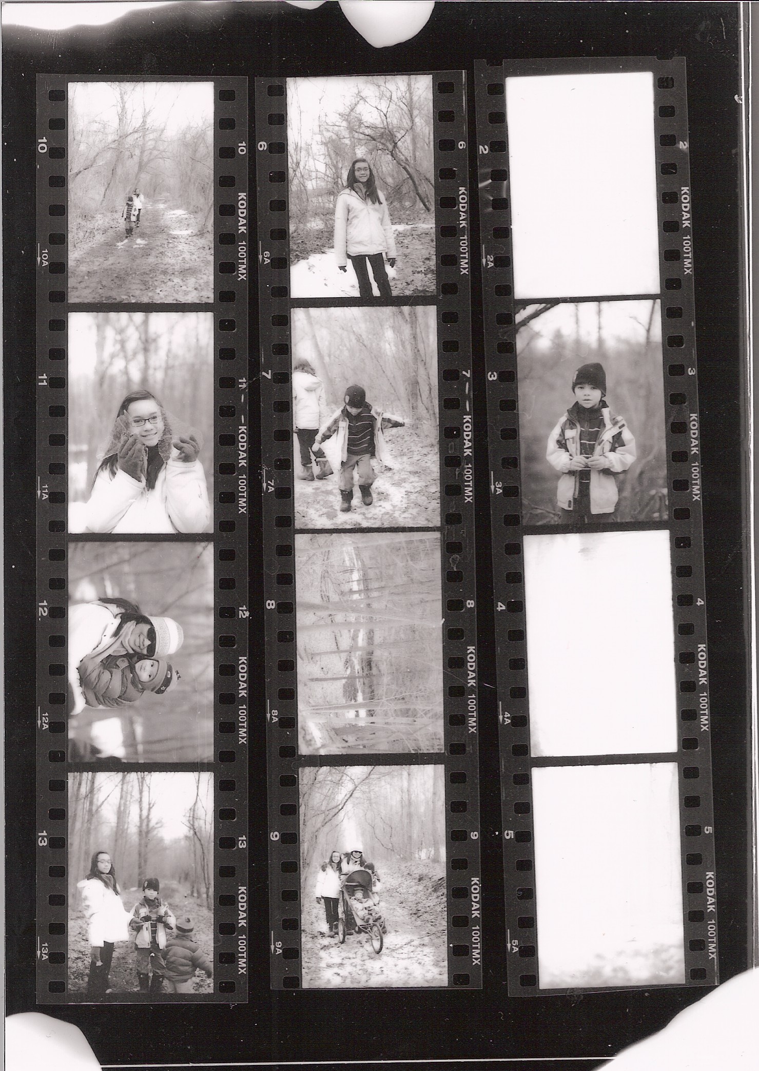

Then last night I proceeded to print proof sheets of the negatives, the came out great.
Then I made a test strip and then the print I've attached. It's quite muddy. Does anyone have any advice?
Proof sheet:

Good Evening, Mark,
The lighting under which the exposures were made probably contributes a lot to the somewhat flat appearance of the print. It's hard to comment based on the limited information you have given. What kind of paper are you using? If it's a variable-contrast paper, did you use a printing filter? If so, what grade? Are you sure that the print was processed for the recommended length of time? Are you sure that the developer is the right kind and mixed properly? I don't see any gross errors, but I'm sure that an experienced printer could get a lot more from your negative. The first step toward a more satisfying print would be to print with higher contrast, either with a higher-grade paper or with a higher-grade filter, probably at least a #3 (Kodak) or #3 ½.
Konical
In the future, if you continue down the film route, you'll soon learn to process film for a little more or a little less time depending on the contrast of the scene; that will help you to achieve prints that will be more satisfying.

If this was your very first time, congratulations You did pretty well.
Let me try to help you out as much as I can with the information available. Please look closely at your contact sheet. Notice, the rebate area (an area OUTSIDE of your images) look gray and the difference of shade between that area and your images aren't all that great? That indicates you have a thin negative. When you have a well exposed and well developed negative, on your contact sheet, your rebate should look black or nearly black with only holes and edges visible and images well exposed.
What may have happened are two folds. You may have UNDER exposed your film. You may also have UNDER DEVELOPED your negative. You may even have done both. That will result in thin negative and low contrast. Properly exposing your film will help with density (darkness) and development will help with contrast.
What to do....
1) if you have another camera, try checking if your camera is metering correctly.
2) make sure your iso dial is set correctlyl
3) watch for your development time and temperature.
I don't think your problem is the safe light as white part is pretty nice and white - although it is always a challenge to evaluate someone's work through scanned images.

Your results look pretty good. As mentioned above you need a little more contrast so the blacks print black and the whites stay white. You can get this with a harder filter if you are using variable contrast VC paper, or a harder grade of paper. You can also develop your film for a bit longer so it has more contrast. If when the film base is printing black you don't see much detail in the shadow areas you should add exposure by cutting the speed of the film down on the camera or meter. For example try 200 instead of 400 for Tri-X. You are very close, and i bet with a few changes you can get good prints from that roll.

Yeah, you could say this was my first time. I did take a black & white processing class in high school, but that was 30 years ago.:blink:
I used Ilford Multigrade IV RC paper. It's what my local camera shop had.
The film was developed in D76. I made sure it was pretty close to 68 deg. and developed for pretty close to 10 min.
The paper was developed for 1 minute in Dektol. 30 seconds facing down and then flipped over for 30 seconds. Actually I think I flipped the paper back and forth a couple times after the initial 30 seconds.
I followed the Kodak Black and White film and paper developing instructions (as close as I could).
The rebate area on the proof looks black to me except where I had my fingers over the print where I was holding the glass down over the negatives.
No contrast filter was used. I can try that next time.
So, perhaps I can try again with a contrast filter and develop the print longer - for two minutes?

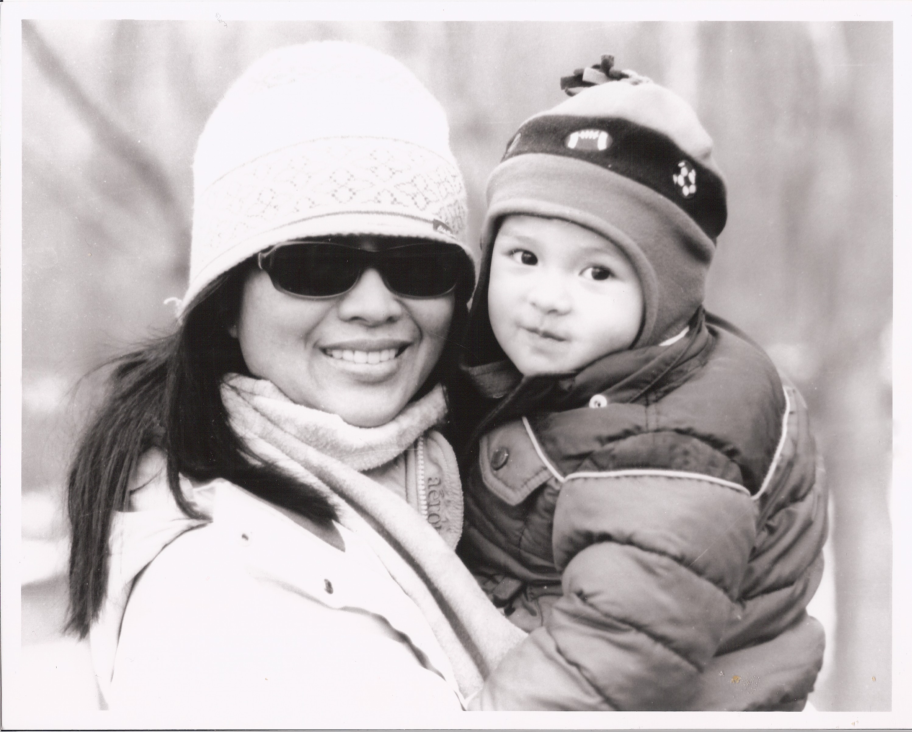

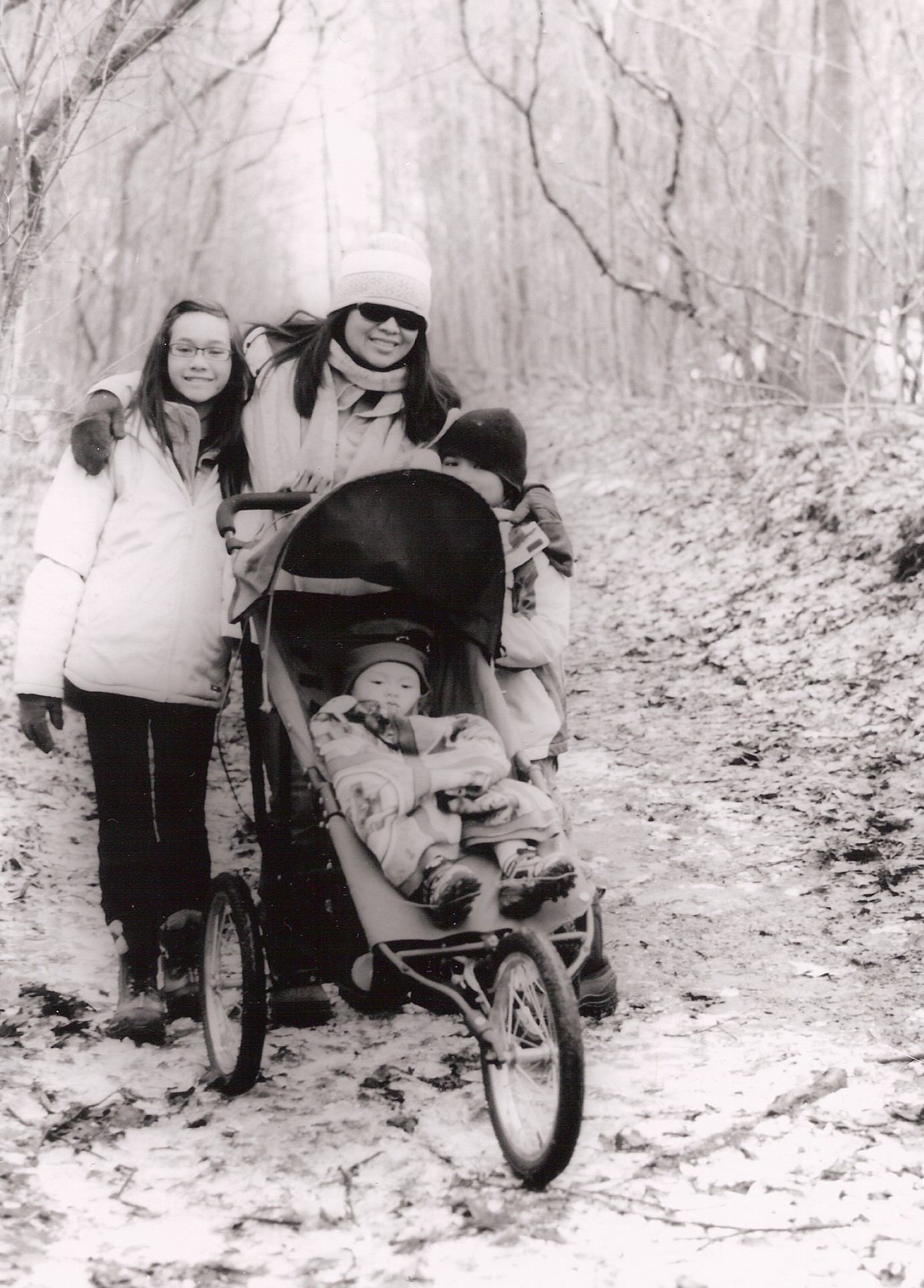

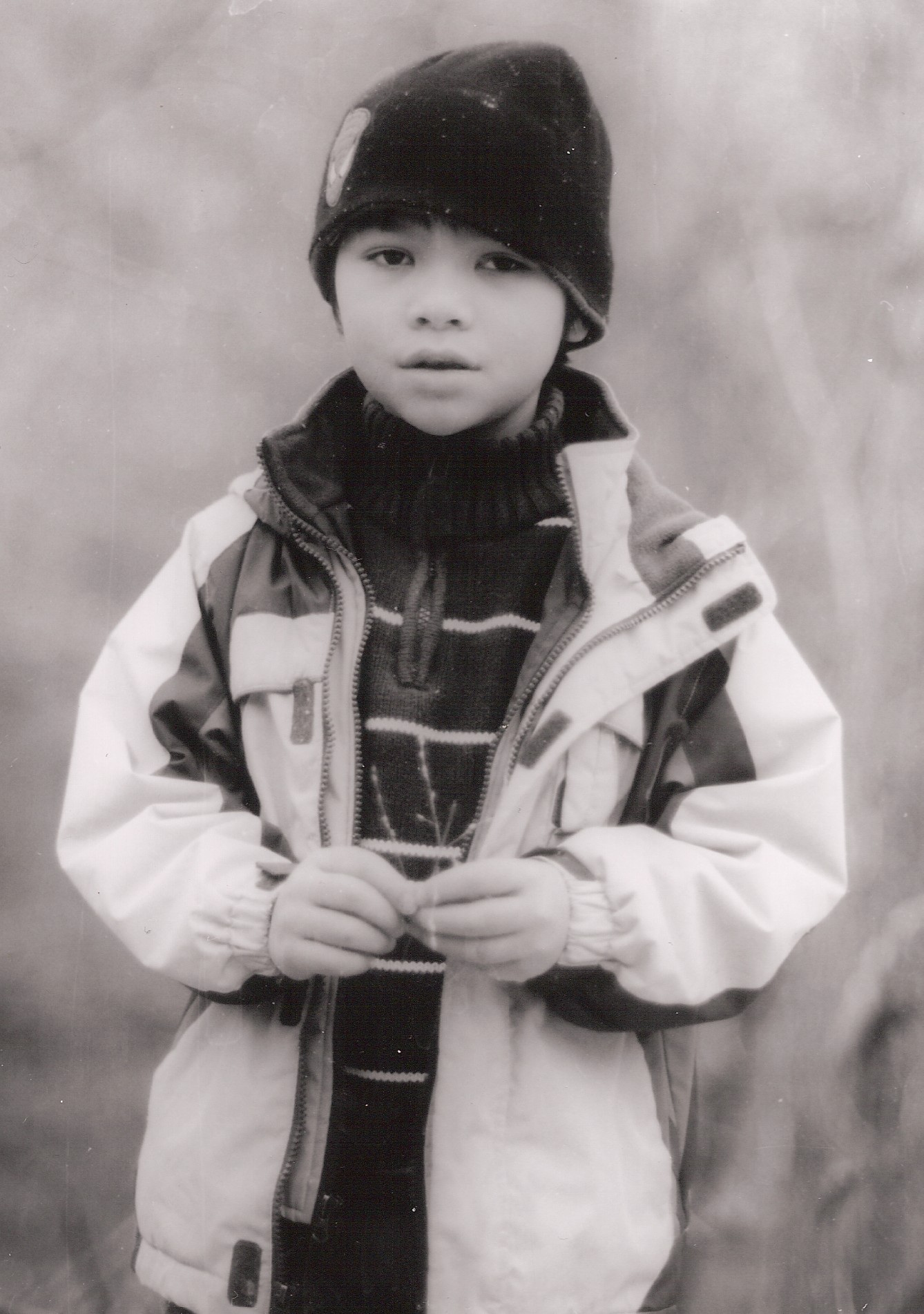

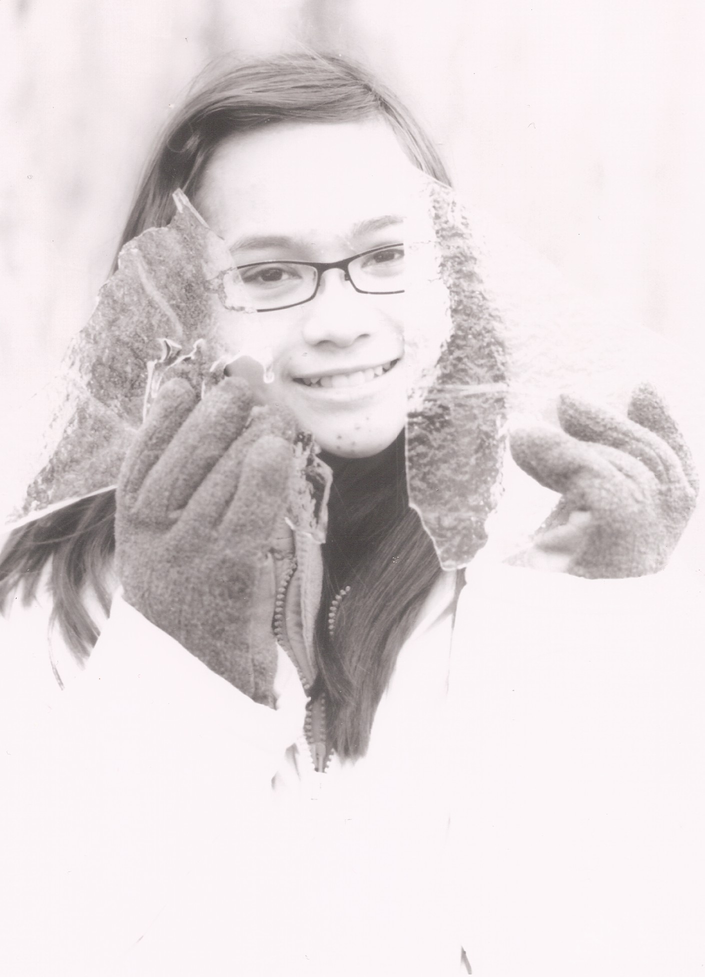

Marked improvements! First and second are great.
Third, I'd increase the exposure time 75 to 100%. In other words, double your exposure time. If you look your print closely, you might notice her forehead is pure white.... as white as the print's border. If you like the "look", you might decrease the contrast by using lower number filters but increase the exposure time.
FingerLakesMark
Jan 27, 2013
9
Clifton Springs
Thanks,
By the way, my improvements were to purchase a Yankee Darkroom Safelight: http://www.bhphotovideo.com/c/product/63613-REG/Yankee_YASL3_Darkroom_Safelight.html
and I used a 3.5 contrast filter.
With the third one I thought I would wing it and not do a test strip before printing it - not thinking that I had raised the enlarger which would decrease the light hitting the paper. I'll get it right next time...

If you are working on the same roll of film and you have a contact sheet for reference, once you have printed one image , you should be able to make an educated guess on the next images contrast and density by just looking at the differences on the contact sheet.
Usually, and in your sample contact case the contrast filter should be the same and you just need to change your timer setting. I always start with a 10 - 15 second exposure, this way you can start mentally storing density changes based on the 10 seconds in % . After time you will be saying to yourself.. Damm that image (on the contact sheet) looks 20% darker than the one I just printed , and you will immediately set your timer 20% less on you next test and without changing contrast you should be very close.
Also by looking at your contact sheet you will be able to judge areas that need dodging and burning, remember that once enlarged the effect will be a little bit more pronounced than the contact shows.
