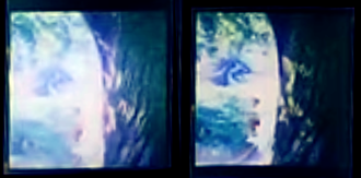

Very much so. If I take a still from the video and invert it, it turns out the casts aren't really so pronounced (or present) as the scans suggest:
The casts originate to a large extent in the scanner software, which is trying to automatically balance the colors - sometimes somewhat successfully so, but it virtually never results in a consistent color balance. https://tinker.koraks.nl/photography/all-over-the-place-the-problem-with-color-negative-film-scans/

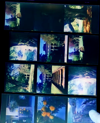

Note that in the contact sheet above, there's really no cyan or magenta cast to the tree image shown around 21:40. It's really the same color balance in the actual negative as the other shots taken under the same conditions. The main problem here is that the scanning software is going haywire with the extremely high gamma of Phoenix 200, which leads the color balancing algorithm astray. Note also that both of these images (normal exposure and one stop overexposed) really have the same color balance. The scanner thinks differently - but it has nothing to do with the film as such:
Note that neither is particularly cyan, or magenta. It's just the scanning software throwing you for a loop.
@Andrew O'Neill have you tried scanning the entire contact sheet in one go as a positive/slide and then balancing all frames at the same time? You'll find that this makes a side-by-side comparison of frames a lot easier - and more reliable. https://tinker.koraks.nl/photography/flipped-doing-color-negative-inversions-manually/
It's also pretty fast doing it this way.
As to the lost shadows in your images - don't beat yourself up over it. Any regular C41 film would have given you OK shadows the way you exposed it. With Phoenix, it's a bit like shooting slides, but a lot worse. You get to choose either the shadows, or the highlights. If you expose for the midtones or highlights, the shadows are gone as you've found. If you expose for the shadows, you'll push the highlights all up on the curve where they flatten out and turn to mush. This is also what happened with your tree image I mentioned above and probably a big part of the reason why the scanner turn it into something...err...artistic.
