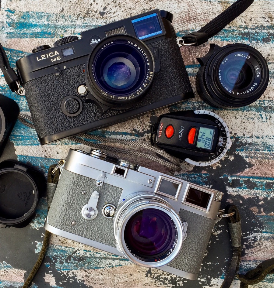

Among other Leica M bodies, I have shot with a 1956 M3 converted to single stroke for about 10 years now. I have had all kinds of great 50mm's on it including a silver 50mm 1.4 asph that while sharp and beautiful wide open, it weighed so much being made of brass that it consistently fell apart even with great care. I sent the lens in three times under warranty in 2 years to have the front tightened up as it would come loose under it's own weight and start to wobble which would compromise the image quality. So I finally had enough of that, sold it after a repair and bought a brand new Zeiss ZM 50mm F2 Planar. Not only is it one of the sharpest lenses I have ever used, it is also the lightest and is holding up great.
My "1.4" Leica lens is now a modern 35mm 1.4 FLE ( not pictured ) and I could not be happier, use it on a M240 and an M6TTL. I also have a version 4 35mm Summicron and a 28mm 2.8 Elmarit aspheric.
If it were me, I would get a silver 50 Planar and call it great...because it is.

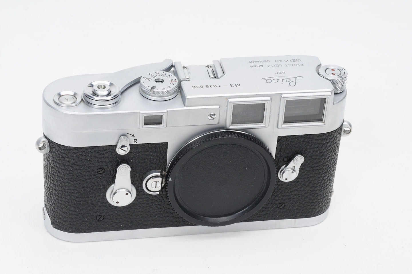

They're still out there. I wanted a decent looking M3 and found one about a month ago.
