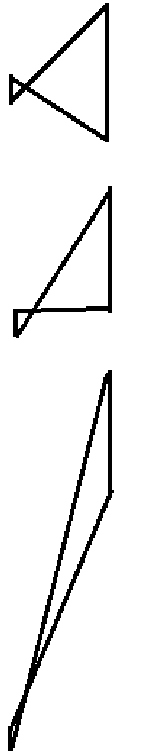

To get what I am saying, look at the picture I made. As the subject (the long vertical line) shifts up toward infinity, the angle made between the lens and the subject shrinks toward zero. In practice, you can't shift the lens enough for this to matter much. You can only shift it about as much as figure 2.

That makes sense, but the way I intuitively think about angle of view is an angle going from my eyes (or a lens) out into the world. The size of this angle does change when you shift the lens.
In the case of a shift lens, you merely are altering the centering of the large image circle as you shift it, thereby causing the 24x36mm window at the focal plane to capture a different view (but fixed 'Angle of View') captured with that window. In the case of 24mm shift lens, its image circle might hypothetetically encompass a 100 degree area within its image circle, but it is always projecting a 24mm lens' 84 degree angle of view within the 24x36mm window at the focal plane.

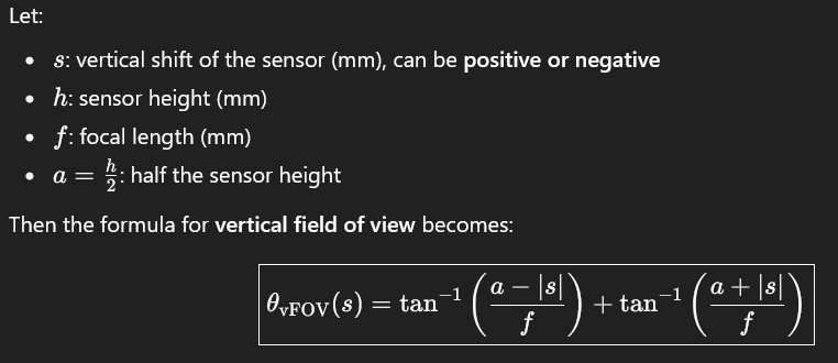

I worked on some math with the help of our friendly computer so I could see how the vertical angle coming from the lens would change as the lens was shifted. This is for a 35mm lens on half-frame in the normal portrait orientation, or on full frame in the landscape orientation (since they're both 24mm). There's hardly any change in angle at all until you approach 1/2 film height.
Sensor Shift (s) vFOV (°)
0 mm (centered) 37.00°
4 mm 36.63°
8 mm 35.41°
12 mm 33.69°
The effect on vFoV gets quite a bit worse when you're using an ultrawide shift lens though like the Laowa 15mm that recently came out. That one has vFOV of 77 degrees unshifted, and 58 degrees with a 12mm shift, losing 25% of its angle.
The formula:

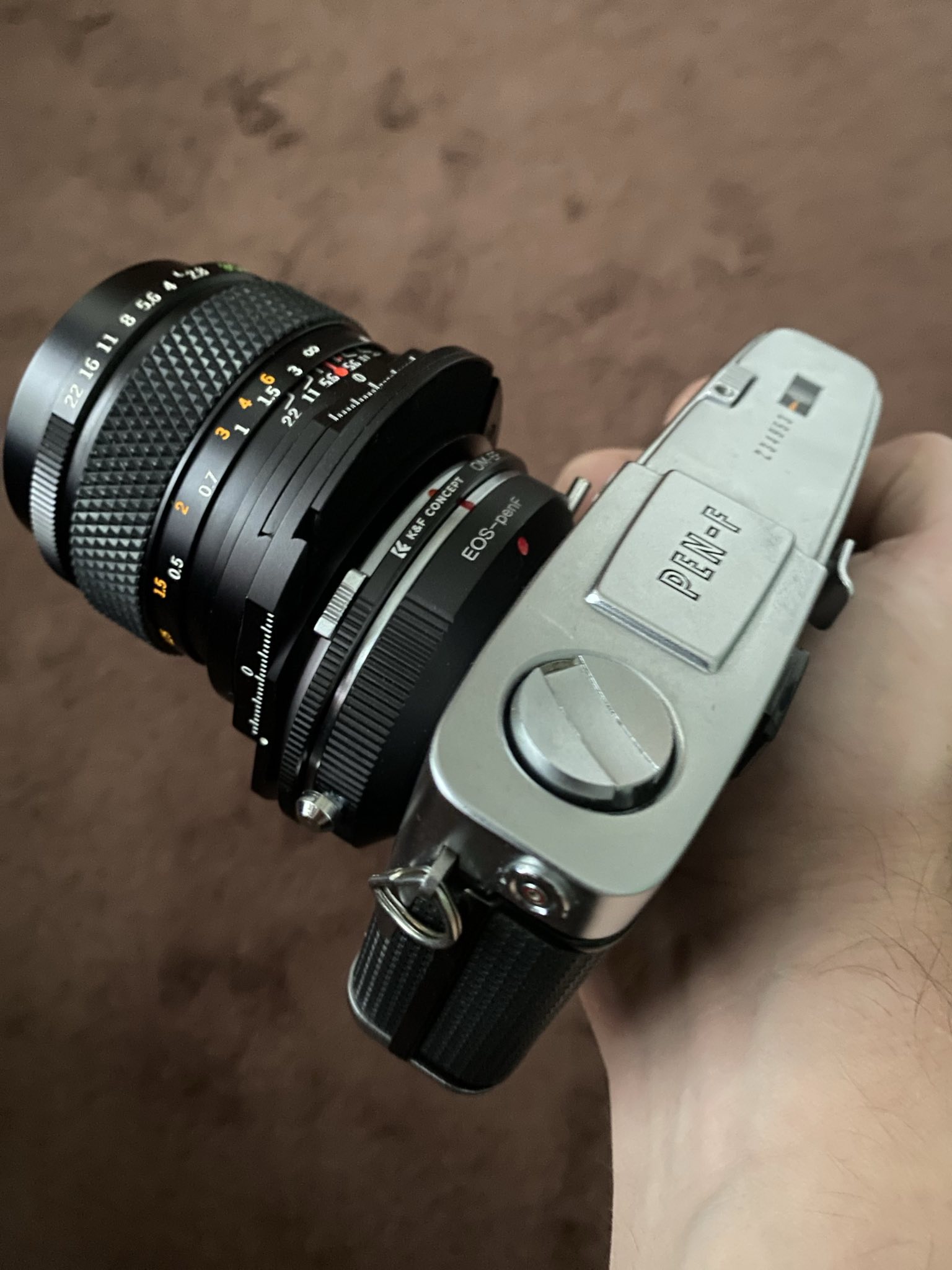

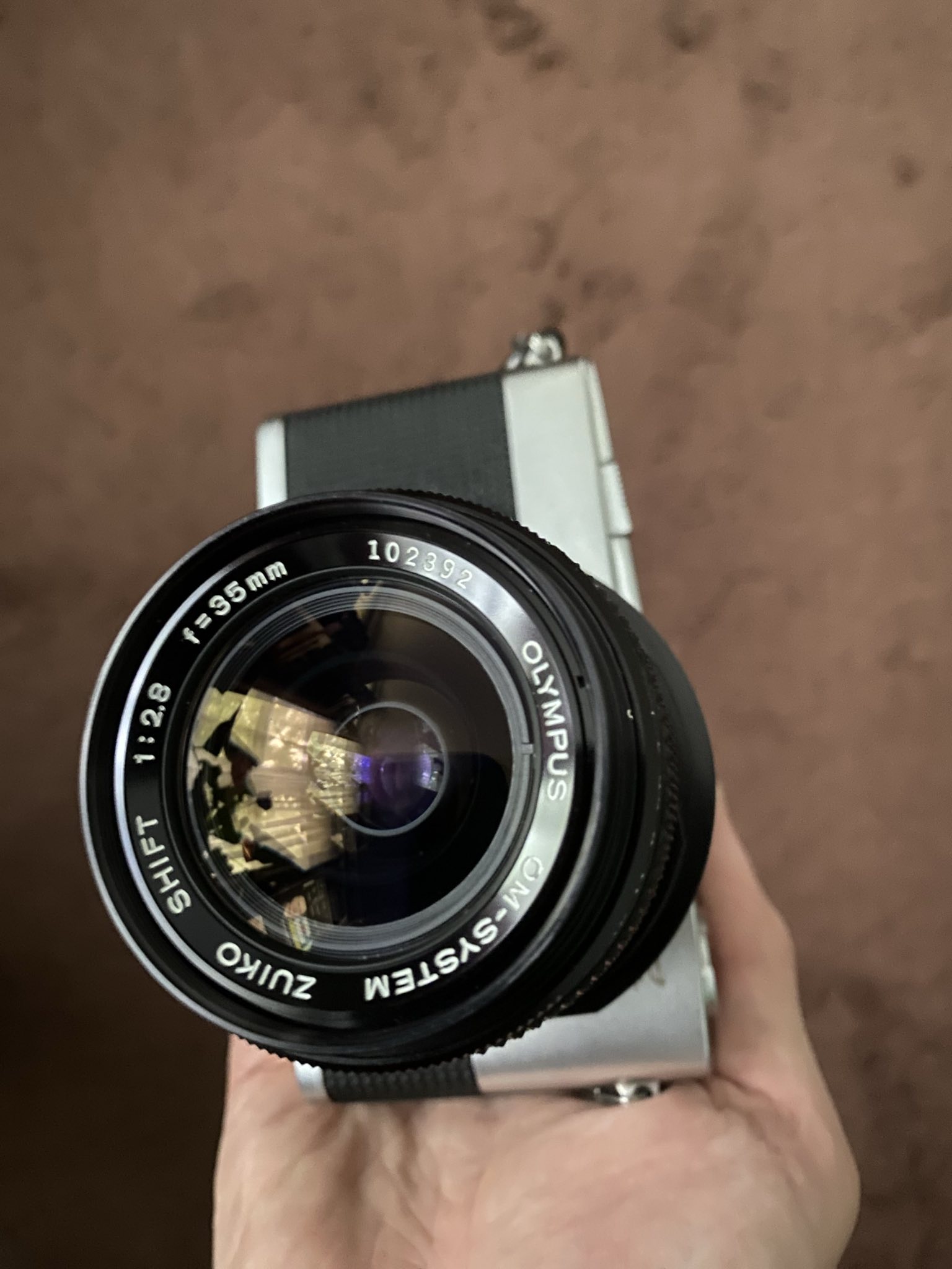

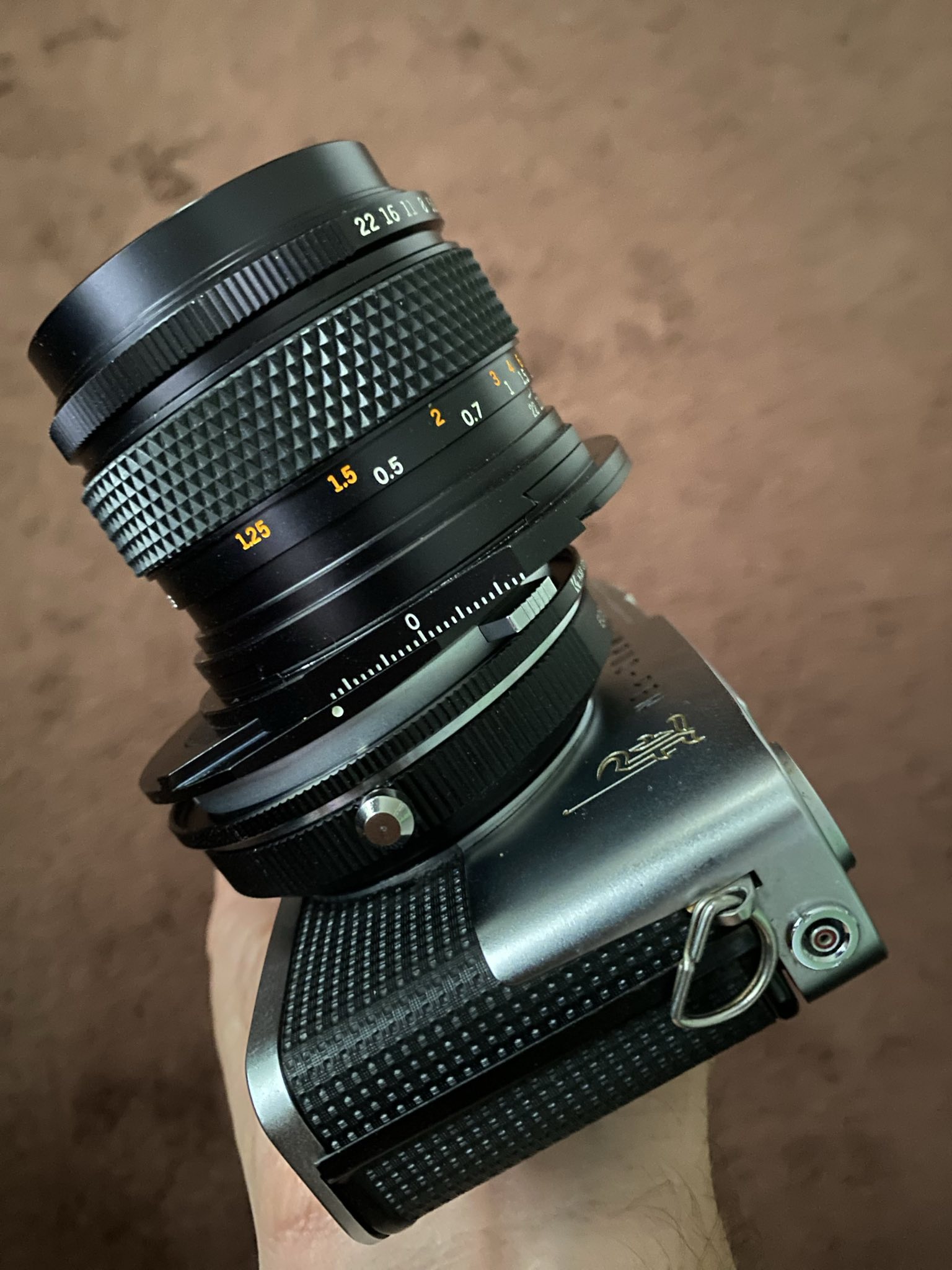

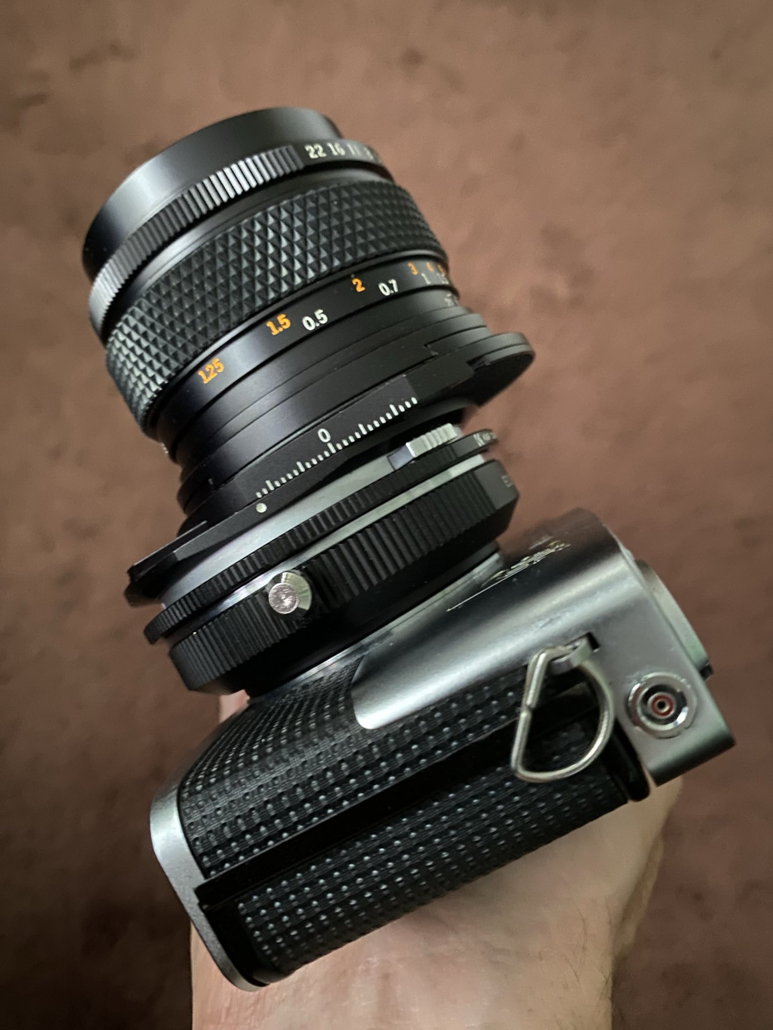

I received this lens a few days ago and it was missing the last ring on the mount, making it unmountable, it had been tinkered with! Had to return it and will try another example.
Received a working copy today. In case anyone is interested in the rather odd combination of a shift lens and a half frame camera, here is what it looks like:
Since you're using a 35mm shift lens on a half-frame, it's basically a normal lens (50/55mm) shift lens. I don't recall anyone making a shifting normal lens, but I suppose it has a use -- but certainly no need for math because your format is so small relative to the image circle.
