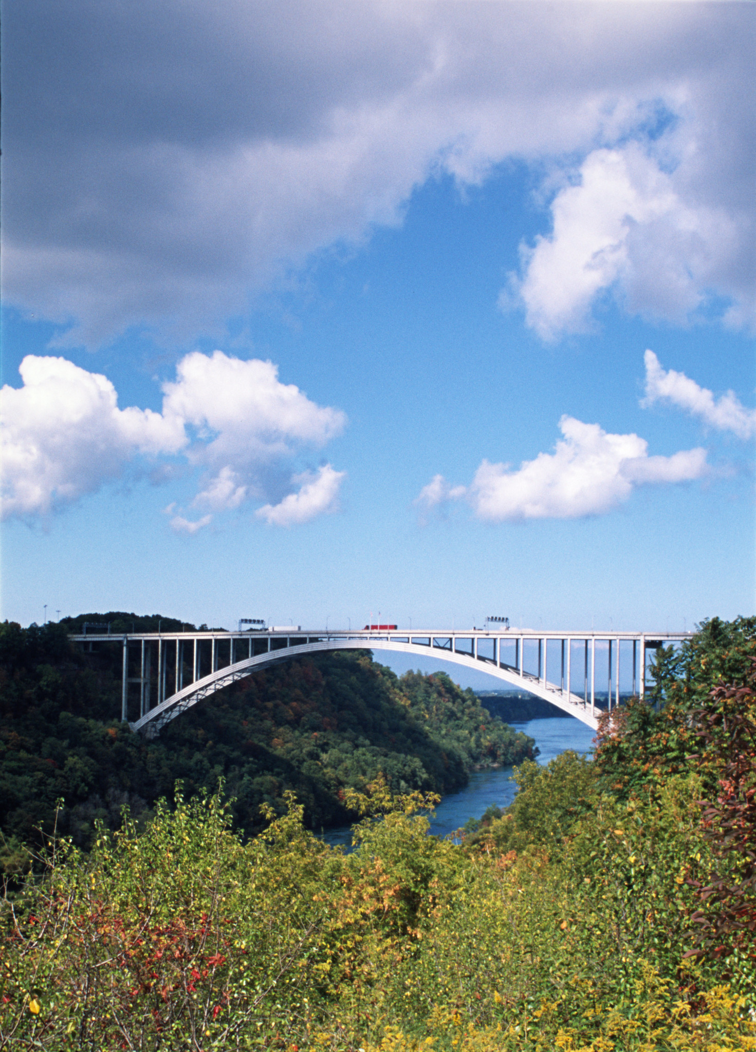

The lens is usably sharp shifted up to 6mm or so on the Pen F. At the full 12mm shift, resolution drops on one side of the image. There is some vignetting but not anywhere near as badly as is shown in the viewfinder. I only used it stopped down to f/8-f/11 where these problems will be minimal.
This image was taken at around 4-6mm of vertical shift to get the bridge supports parallel. At this level of shift resolution is acceptable for small prints, though lagging behind the 40mm f/1.4 lens in comparison. Provia 100F film was used.

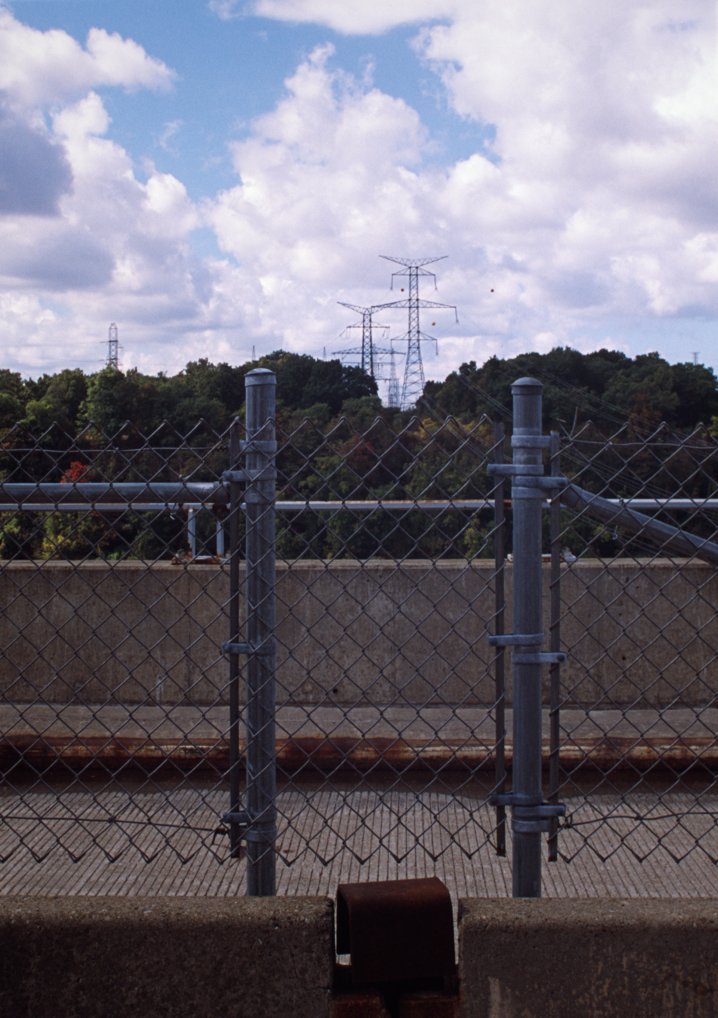

Here is another Pen F shot at f/11 where both horizontal and vertical shift were employed to get the background and foreground in positional harmony. The focus was on the chain link fence. This helped hide any slight unsharpness toward the top of the image near the edge of the image circle. Using this lens is fun because it gives you additional choices without slowing you down too much.
