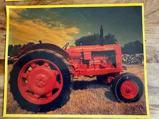

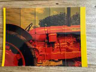

I have a Kaiser VPM 7005 enlarger. After successfully printing B&W for some time decided to try colour. I am using brand new Bellini RA4 kit and Fujicolor Crystal Archive 8*10 Glossy paper. Negative film is 500T, my initial setting were 45Y 25M 0C. From the test strip there was an obvious severe yellow colour cast, strangely the unexposed borders were also bright yellow. Even turning the yellow filter up to 100Y (full size print attached) has not fully removed colorcast and borders remain quite yellow.
Has anyone experienced this? Given that the unexposed borders are turning bright yellow my suspicion is that there is a problem with this batch of paper?

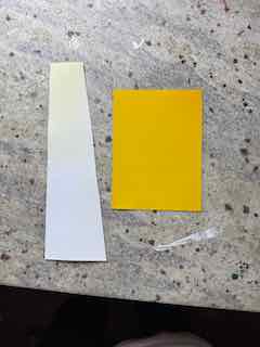

So I did as you suggested. Suare paper is following my normal darkroom process without actually exposing the paper. The strip was cut from fresh paper in the box and straight into the tank.
Results are conclusive - I have a blue light problem! There are quite a few LED's in my darkroom (also our utility room / electrical fuse / switching). I thought I had masked them all with electrical tape but clearly blue light is still getting through strongly :-(
Many thanks for your help - will need to think about how to fix this...

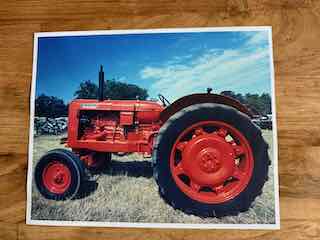

Got there is the end! After a thorough blue light elimination effort in my darkroom I got my first successful print! Many thanks to all who commented especially @koraks
