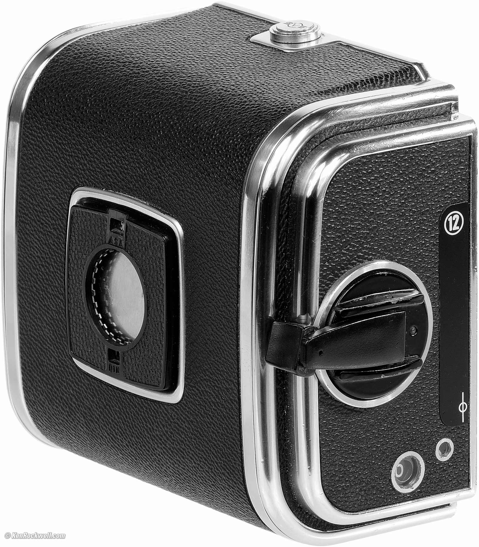

Somewhere in this thread I was asked which version of the A12 back I have and I didn't reply. It's this one, which appears to be from the '80s.
*Image borrowed from Ken Rockwell
