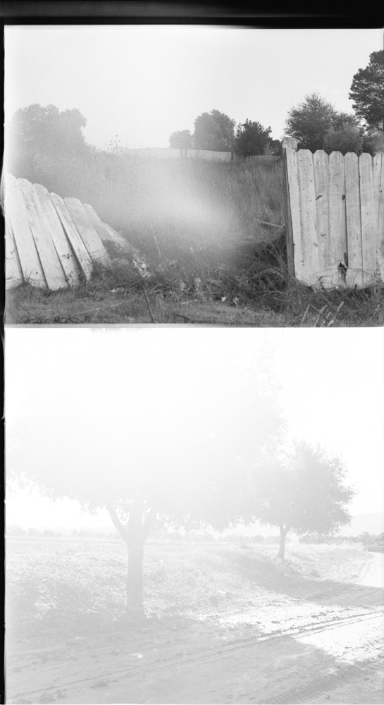

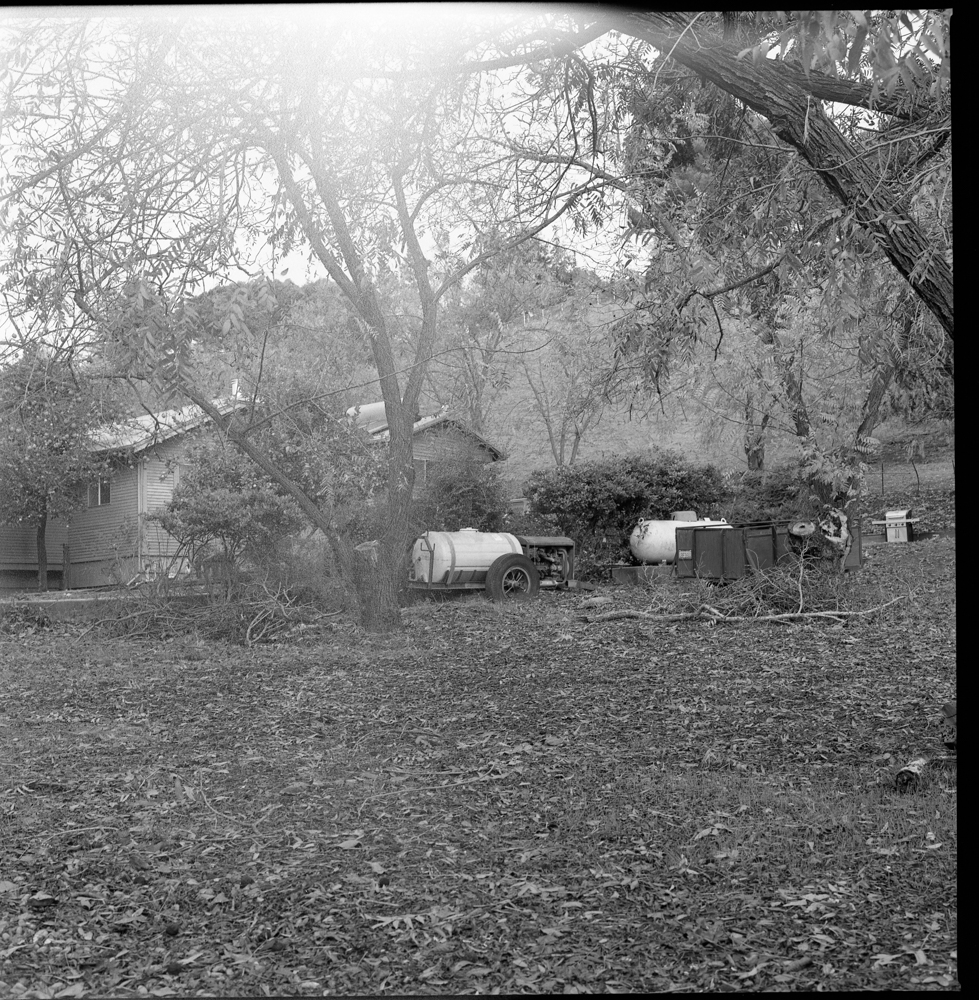

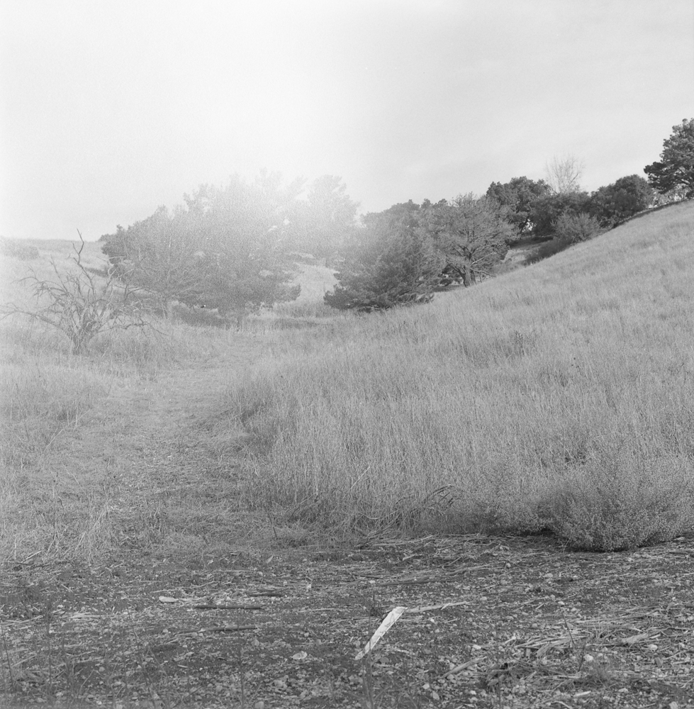

I just got my negatives back from the first roll of film I shot with my new-to-me Hasselblad 500C/M and it was a bit of a disaster. There is a pretty significant light leak that (given what I've read online) may be from the dark slide light trap. In addition, the first two frames overlapped. Finally - and this may very likely be user error - the final frame (12) is blank (except for the effects of the light leak). I believed I was at the end of the roll because the progress indicator was completely red (at least I think it was), despite the fact that the frame counter read '12'. I may have simply misread the progress indicator and rewound the roll one frame early. Anyway, that appears to be the least of my problems.
I've attached a few scans so that those of you familiar with the tell-tale signs of Hasselblad light leaks might be able to tell me what caused them. As I said, I've looked at some images online of leaks caused by the dark slide light trap and I believe my scans show similar signs. If that's what it is then I assume that's a pretty simple fix (for someone who knows what they're doing :tongue: ). I assume the frame spacing issue would only be resolved by servicing the film back/magazine.
I suspect the whole camera is probably due for a CLA. I bought it from a reputable shop that provided a 90 day warranty and I paid using PayPal. I don't really want to return the camera for a refund but I'm not sure I want to drop $400-$500 on a full CLA and be without the camera for several months when it was advertised as 'excellent condition' and was priced accordingly. Cosmetically it is excellent but obviously there are mechanical issues that need to be sorted out before it's a fully-functioning camera.
Scans attached. Some images are affected by the leak more than others. The last image shows the two overlapping frames, (frame 1 and 2 on the roll) including a very fogged frame 1.
So, keep the camera and negotiate with the seller to cover some/all of the repair costs, or return it and look for another one?

Hello Logan2z
It does look like a dark slide leak, I have replace several seals and it is not that hard to do, and I am not anywhere near a mechanical person.
I would try the seal and run another roll of film as you may not have wound up the first roll quite right as you mentioned the problem with the last frame.
good luck
Don

Thanks for the advice Don. It is conceivable that I didn't load the film quite right as it was the first time I'd loaded a roll of 120. That may account for the overlap of frames 1 and 2.
Now that I think about it, the first frame was shot with bright sunlight hitting the left side of the camera body and it is the frame that shows the worst fogging. More evidence of a dark slide leak I guess.

Hi Logan2z,
pity that those pics didn't turn out well, they are beautiful.
This seems indeed like a film back issue - do you by any chance have a 2nd back you could try?
An option for you would be to buy a 2nd back (around $200-300 depending on age and condition) and only send your back for CLA, or work something out with the seller. This way you will not be without a camera too long.
As for the overlapping frames, did you by any chance use Acros 100? (original version, not the recently introduced Acros 100 II) I remember reading somewhere that the somewhat thinner paper used on that film could cause issues such as overlapping slides. I never had that issue myself but only shot around 10 rolls of Acros.

I'd try a different film, load it in subdued light, double check your loading procedure and keep a count of your shots. If the problem persists and you believe it's a back problem, buy or borrow another back if you can and try again. You could ask the shop to swap the back if they have or could source another one.

Thanks for the comments on the photos. The good news is that they were all taken within a short driving distance from my home and I can reshoot them once I have a working camera.
Unfortunately I don't currently have a second back to try.
With regards to the film, it was Tri-X 400.

This is not "excellent condition", no matter what the outside of the camera looks like. I'd give the seller a chance to make it right by replacing your film back with one that doesn't leak and try a roll again. "Excellent condition" should not mean "fixer-upper" or "useless until you service it". All of the cameras I've purchased from KEH labeled as excellent condition have been exactly that, functioning perfectly. Good luck!

Completely agree with both of you. I've sent the seller my scans and am awaiting a reply. I'll see what he says, but I may just decide to return for a refund and look for a better example. My intention was to buy a working camera, not a project.

Depending on where you are in California, there may be someone nearby who does service Hasselblads, and would be willing to give you advice.
If it is just a problem with the seals, and the camera is in otherwise excellent condition, it may be better to seek a small price adjustment and have the seals replaced (a quick job).

When used professionally, the dark slide light seals would be replaced every year, maybe every 2 years if the back was used a lot. It's a bit like changing the oil in a car - if a used car was advertised in excellent conditions, but still needed an oil change, I would not use that as a reason to return it. Just saying.
Film spacing mechanism is quite precise and sensitive, and issues are usually due to lubrication. It was not unusual to get a few odd spaced frames, but we usually attributed that to the speed that we slammed the wind mechanism when things were moving fast in the studio. But the mechanism was usually lubed every few years, and if one noticed some regular uneven spacing. Quality of the lube made a difference to how long they went without service, and with used stuff this old, there is no reliable service history - and many local service providers regularly over lubed with cheap oil, because the pros would regularly service them before any issues occurred. Whether you want to use the spacing issue to return the camera is up to you.
You could run another roll through it and:
- black tape the dark slide slot to eliminate the light leak
- check to see if the film spacing is repeatable

Light leaks in Hasselblad backs are so common and you have to run a roll through and develop it if you want to know if there is one. Leaks develop after 2-3 years of not changing the seals; almost every single hasselblad back sold has a leak unless the seals were specifically replaced by the shop you are buying it from. Nevertheless, excellent condition should mean that the back has had its seal replaced.
A frame overlap is a bigger problem and should have been easily caught by anyone selling a back -- you just need to run a dummy roll of film through and mark the film with a sharpie as it passes by the film gate. It might be worth you trying yourself if you want to confirm that it is indeed a spacing problem and not user error. What kind of back do you have? Is it an A12 (where you line up the arrow to the dot) or a C12 (where you open a window on the back and turn the knob until the "1" is under the window)? If it is an A12, when you loaded, was the film tight throughout the whole back? If there was some slack, it could explain the overlapped first frame and missing last frame. Just a thought.
I see nothing to imply other parts of the camera aren't working besides the back. If you trust the body and lens, I would insist that your shop fixes or replaces the back. In the meantime, I'd recommend picking up a cheap A24 back (which, contrary to what some people will tell you, does work with 120 film) and can be found as low as $40.
FWIW, all three of my A12N backs have been leak-free since purchase, and none of the sellers mentioned replacing the seals.
The leak is an easy fix either way, but the spacing issue is more serious and will probably require a full service.
