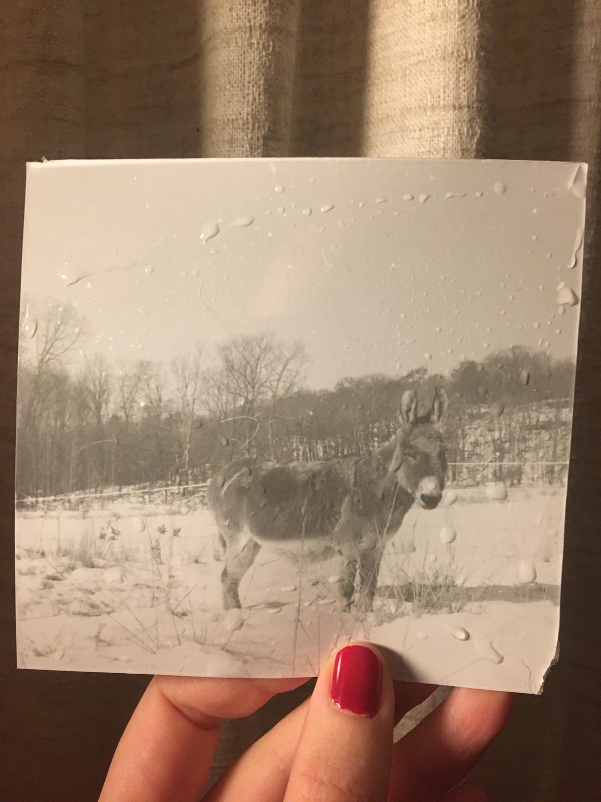

hi all! after a break of about 10 years, I'm developing again in a (very) DIY home darkroom.
made my first prints last night and was hoping you fine people could help me troubleshoot some of the issues.
as you can see this one is very gray and not enough contrast.
also troubling was that I was getting some where even 3 seconds of exposure was too much, at f 11.
I'm using a 70s Durst M600 enlarger and Oriental Seagull VC-RC II paper. I'm not super familiar with either yet.
So I think I have two main questions, unless I'm missing something, which is entirely possible as I am very, very rusty.
  • I'm assuming I need some kind of magenta filter to increase contrast. are these generally interchangeable, do I need one specific for the enlarger I've got? How is it used?
  • What could be causing the way too short exposure times? The bulb I'm using is the recommended wattage, using dektol diluted 2:1 w/ water for developer. Even at f22 it was unsustainably short.
  • Bonus question: some of my negatives came out completely dark (ie completely white negative), but it seems to be down to the camera itself. could the light meter be wonky? I was using auto exposure (boo).
many thanks and apologies for any 'stupid questions'..

-My first thought, is the negative very thin? If its thin, not much contrast between clear parts and the image,, will be very low contrast and short times.
-Yes you need contrast filters, look up ilford contrast filters, depending on the enlarger, some will be gels, others are held in plastic to mount under the lens. Higher the grade, higher the contrast.
-I have many old thin negatives, only way to get anything out of them was grade 5, highest contrast, and still were short times.
Hope this helps.
Now for someone that knows more....
thanks!!

That looks like a pretty small print, so short exposure times are to be expected. I would venture your exposure time will increase with a VC filter in place, especially a grade 4 or 5. I think Ilford MG paper without any filter (white light) is a grade 3.
Filters are available to use below the lens should fit any enlarger. If your enlarger has a filter drawer, then you would need ones that are the right size for the drawer or slot.
Get yourself a contrast filter pack from someone like Ilford. Then taylor your film to your paper, unfiltered. What film are you using? Developer?
This image you've shown here is not the ideal subject matter if you're trying to test your camera's exposure accuracy. It appears to be an outdoor scene in sunlit snow, which is much brighter than the average subject. If you're shooting on auto or program, the camera will underexpose the image, which will give you a thin negative overall. This is because the meter is influenced by the bright reflections of the snow and it's going to set too high of a shutter speed and/or too small of an aperture on your camera. Unless you can get closer to take a meter reading off your main subject, the donkey, you would have wanted to use exposure compensation to overexpose the image by 1 or 2 stops. This would have given you a denser negative with better contrast between the snow and the donkey.
Also, your print exposure time is short because this is a thin negative. Every enlarger is different, but for me to make a 5x7 print from a "normal" negative usually involves exposures between 5-15 sec at f:8.
would an older ilfospeed filter work? (happened to find some used).
I was using Kentmere 400 and Dektol - but my next roll will be Ilford. I bought a bunch of different BW films.
Ah! that makes a lot of sense. Other photos from the same roll that were inside and taken with flash seem fine. dumb of me to trust the auto setting!

Is it a pack of filters for various contrast? Filters do wear out, so test it to make sure they give you varying degrees on contrast. Is there a reason why you are using a print developer for film? I have used Ilford MG developer when I was out of film developer... used very diluted 1+49. I'd get a dedicated film developer and film. Stick with them until you are quite familiar.
yes, just from the 80s it seems! I'm willing to test them, they're cheap. getting stuff shipped to canada is expensive.
oops, no, the dektol is for paper. for film I used Ilford ID-11.
Tell me about it! Luckily I live very close to the US border so I can drive over and pick up at a postal outlet in Blaine... that saves big time in shipping costs.

Notwithstanding the other good advice above, make sure the internals of your enlarger are clean are reasonably dust free (mirror, condensers).

As I understand it, Ilfospeed Multigrade RC paper (and one would assume the corresponding filters) was made between 1978 and 1983/4. So those filters could be more than 40 years old. In 1983/4 the product was improved and the name was changed to Multigrade II, which means that I think that there was no longer any use of the word "Ilfospeed" in the name.
In addition, half grades were introduced in 1983/4 and the capacity to achieve a full grade 5 became possible.
I am reluctant to encourage someone to try to learn printing using 40 year old, potentially unevenly dis-coloured filters, which were designed in the first place for paper that has not been made for 35 years. And I am particularly reluctant because of the fact that the OP is relying on internet help, rather than in person help.
If he/she was my neighbour, I could easily help him/her determine if the results using the old filters made them dependable enough for use while learning. But I am 3000 miles/5000 km away.
So not impossible, but rather problematic.

ninochka, I got so flustered trying to get the right filter to make a good normal print, that I went back to “graded” papers. That’s the kind of risk, that you will become frustrated when you could have had a good time with the right set of filters and the same effort.
I would add one item to your hunt/shopping list.
An 0.60 (2-stops) Wratten No. 96 neutral density filter.
This will “double” your time so 6 seconds instead of 3 seconds, without making it so dark that you can’t see.
I use one “all the time”.

as you are starting out again, i would stick to one film and developer; one paper and developer. get things "dialed in" so your producing stuff you like. stick with the same materials for a year, then maybe change one thing and see what happens. modern day materials will produce for you - if you work them.
(this was the best advice i ever received! it also the hardest to do, because you think that this other developer is better; other film has finer grain, sharper; fix the problem - looking for the holy grail.)
As an update... I think the culprit was my camera (plus lack of filters).
I developed these thin negatives using some vintage ilfospeed filters and got OK results. Not bad.
Then I developed another roll of film that I shot with a different camera - a simple pentax point and shoot. Developed the same way, and these turned out gorgeous and contrasty!
I had been shooting a second roll with the Nikon, and developed it the other day. Very underexposed, low contrast. This leads me to believe that the light meter built in on my Nikon is broken (I have a hand held one form the 70s, but I'm not sure I trust that either), or something else is wrong with the camera itself..
