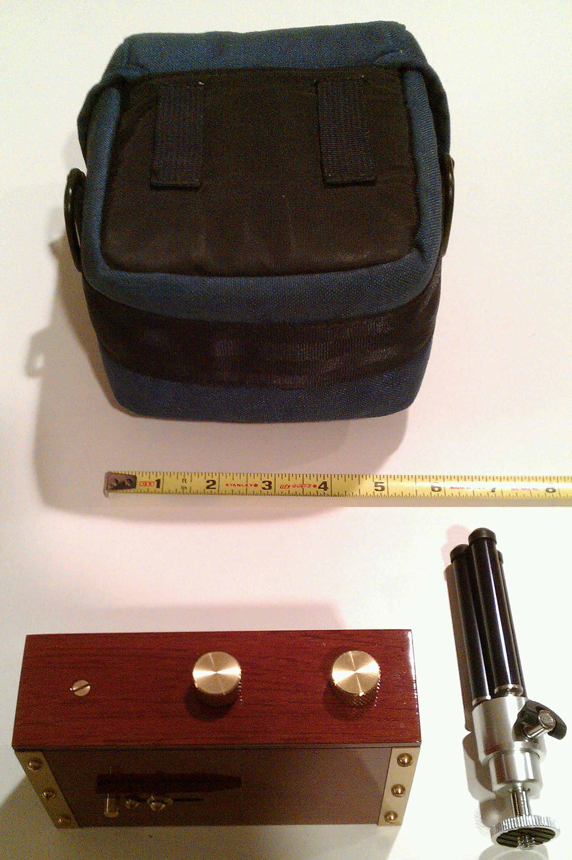

    My ZeroImage 2000 6x6 with my own case and tripod. Some models allow filters and cable releases. They have a web site,
    http://www.zeroimage.com/

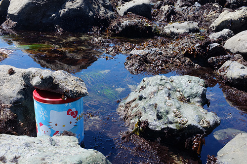

    Christmas popcorn tin and 11x14 paper makes a great pano ULF.

    Definitely! Mine is a "Hello Kitty" popcorn tin... my daughter was little when I made it and I had to get permission to turn it into a pinhole camera :smile:
    [​IMG]
    Making "Shell Beach Tidepool"
    par Ned, on ipernity

    Sorry - I should've provided more details. I know two people who have the ZeroImage 6x6 pinhole cameras. We both use 120-format color film and have it printed at the same place (I'm looking at actual prints, not a monitor). Theirs appear less soft than mine. The only thing I can think of is that I was using old film and increasing exposure to compensate. Even so, most of my exposures run from one minute to 20 minutes.
    The ZeroImage 2000 6x6 has an effective aperture of f/138.
