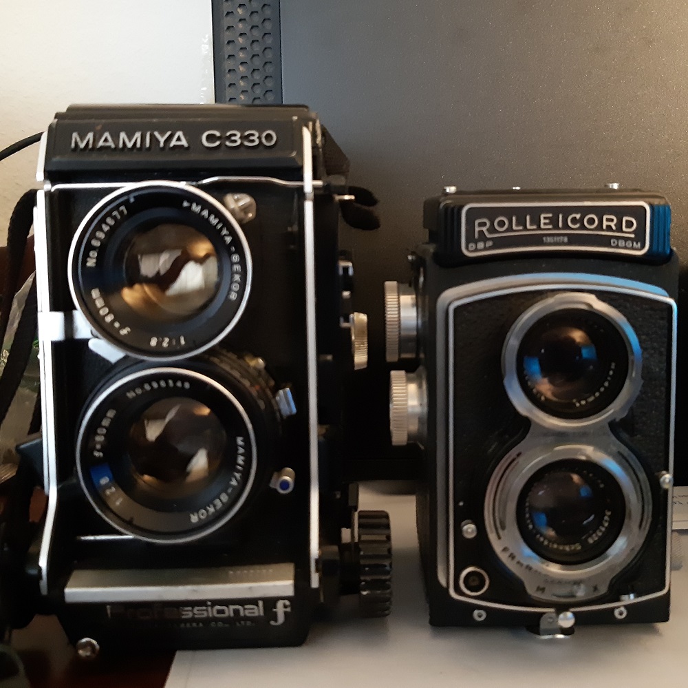

C330 is a bit of a clunky heavy box to lug around, especially if you only ever plan to use the 80mm lens, as compared to other smaller and lighter TLRs, but the bellows focus does remove some of the limitations you'll run into with lighter options.
If I'm out framing up flowers and such with the Rolleicord I frequently hit on the camera's relatively long min focal length. This is not the case with the C330, and the framing issues of a TLR aren't that hard to compensate for, even handheld.
Also given that basically nothing moves when you take a photo, you can push your handheld speeds a little lower than you may otherwise do with an SLR - Not having to move a big mirror out of the way is nice. And it is a fun camera to do panning motion shots with I find, assuming your brain is happy with the reverse image finder if you're not using the eye level option.
Both of these have the eye level option- the sportsfinder built into the waist level finder. Incredibly handy to have if you’re not out with a clumsy prism finder on that TLR.
I love the mechanical simplicity and low weight of TLRs. I think your choice of the versatile Mamiya is a good one. For size, low weight and portability it’s hard to beat a Rolleicord though.
