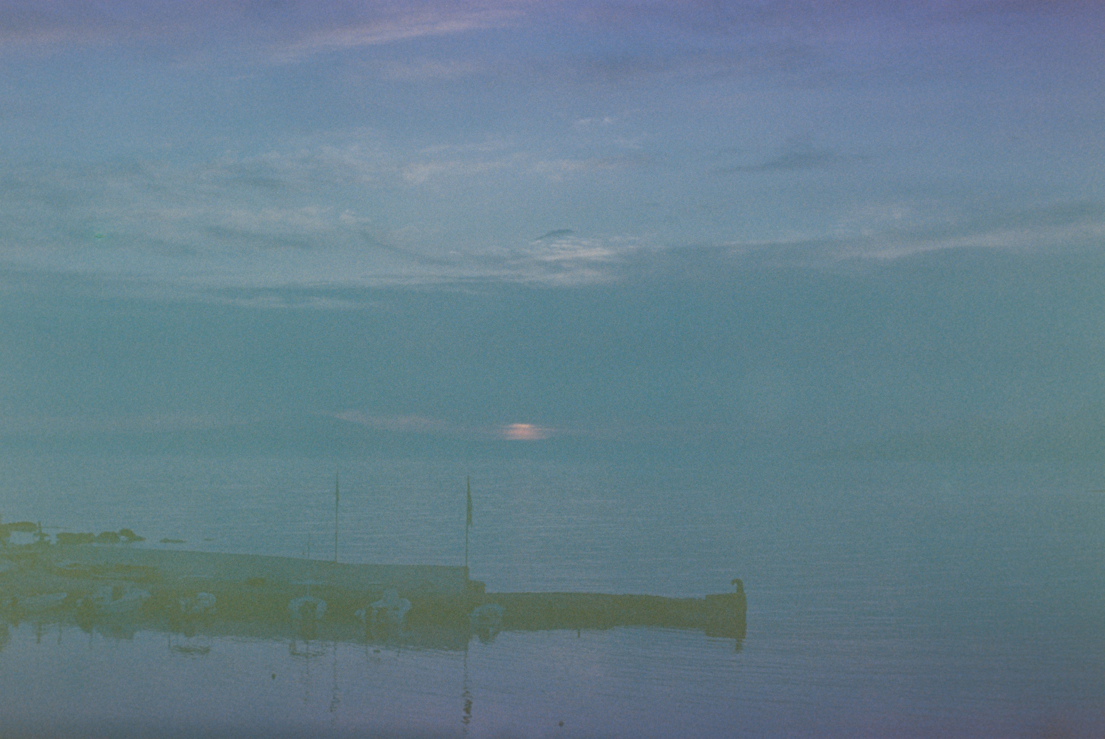

Have a look at the second image (see here)
The image appears underexposed and there is a magenta cast to the top and bottom of the frame. This is usually associated with out of date film and/or poor storage (temperature fluctuations).

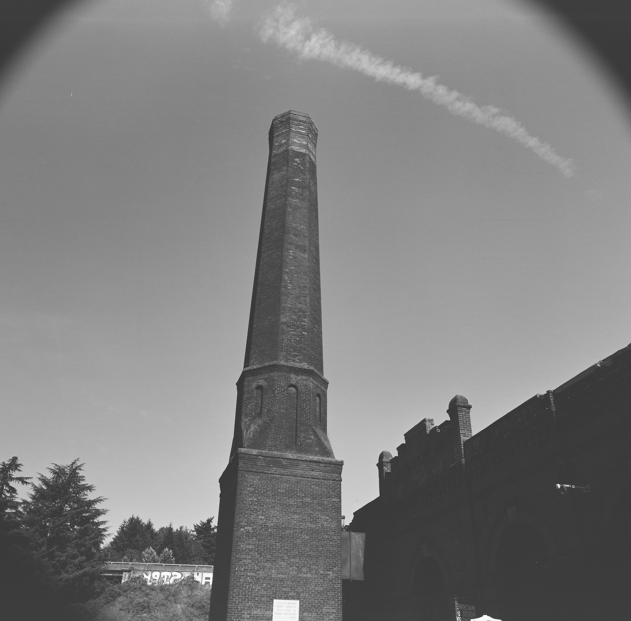

I have a sample image that is germane to this discussion, and I got to use the word "germane." Wheee! For this discussion, can we agree to leave the vignetting issue alone please? This image is not the worst from this roll, but my mistake was that I did not reset my ISO/ASA dial after switching film types (Delta 400 to Agfa APX25). Mistakes can happen to all of us. I managed to pile 3 issues into one roll, I'm trying to "get back on the horse" as they say.
One of the ways to learn is by making mistakes. If one does not make mistakes, then they are not working at learning.
