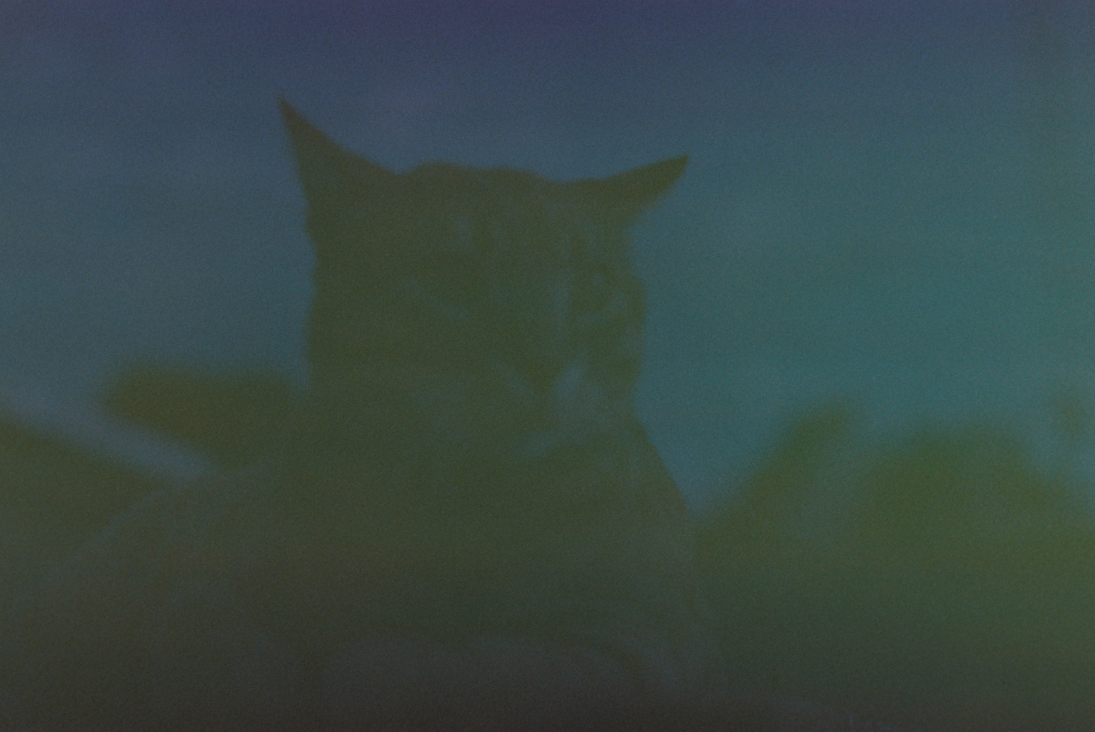

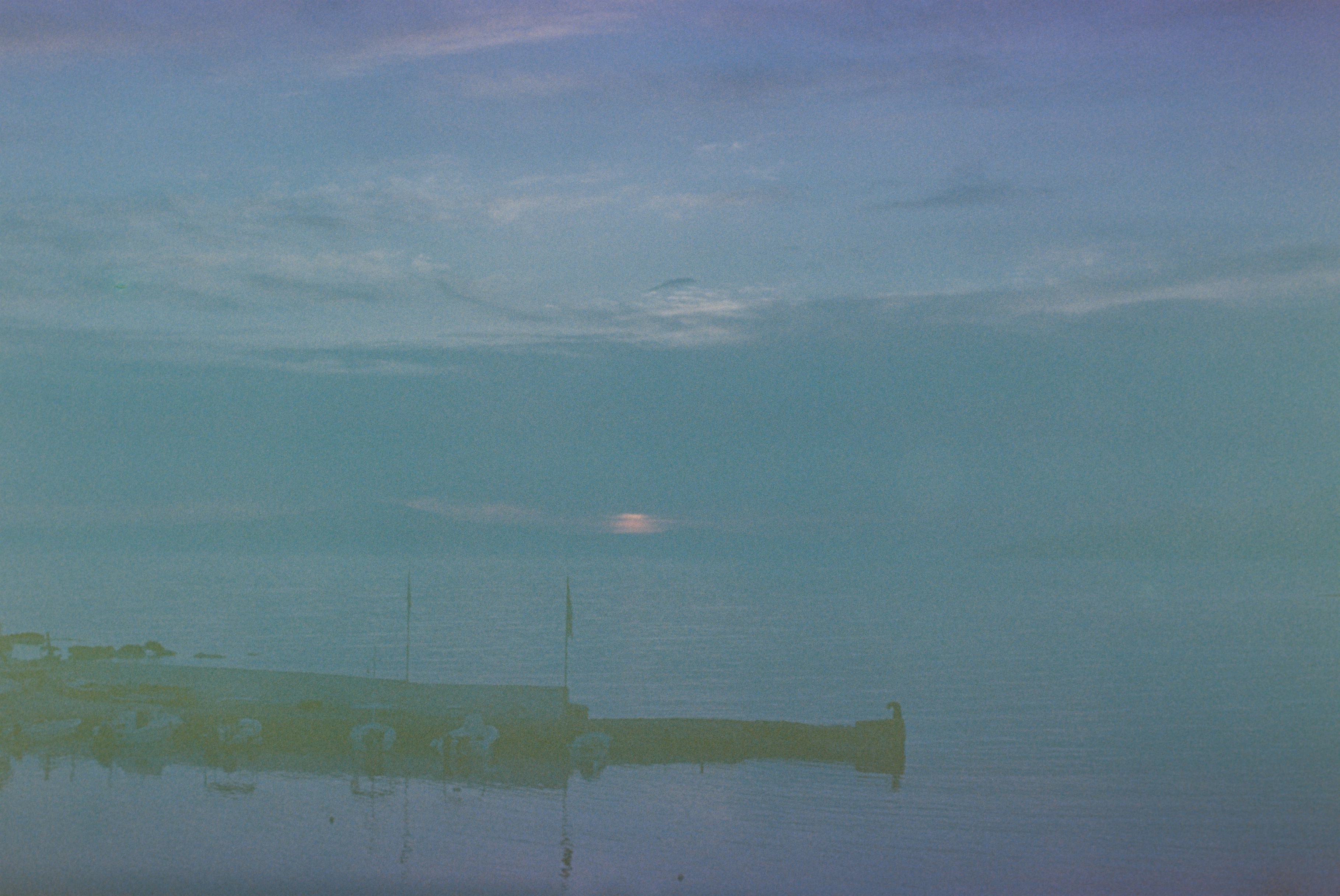

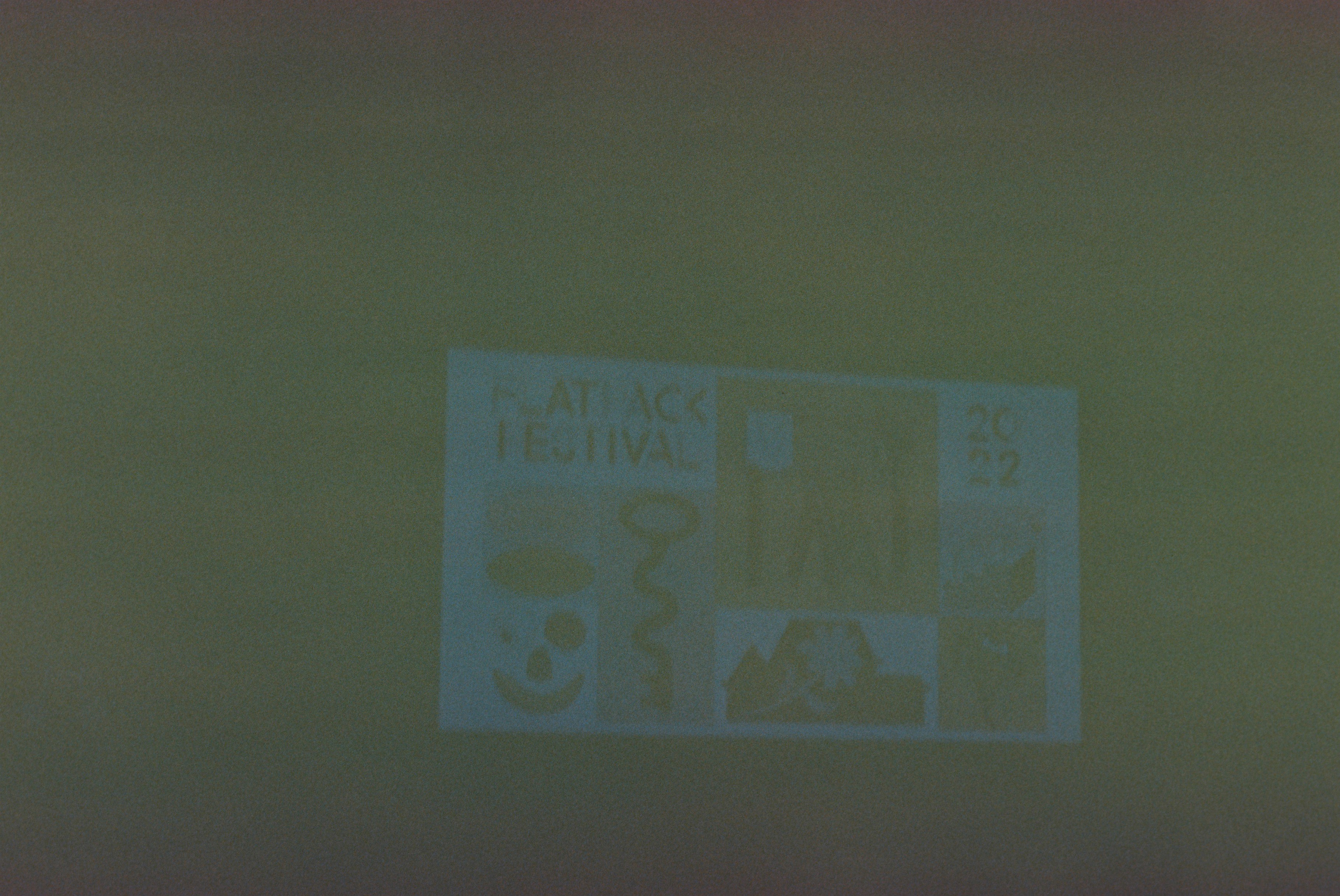

Hello!
First of all, i'm very new to shooting on film and wondering if anyone could help with this. I got my first lot of photo's back from development and pretty much all of them look underexposed like in the attached photos.
I'm shooting on a Chinon CE-5, Kodak Gold 200 35mm. As far as i'm aware, I should have the correct exposure. ISO was on 200, and I was using the cameras built in light meter, and checking it against a light meter app I have on my phone - all seemed to match up.
Does anyone know why my photos still looked like this? Two of these photos were taken in bright daylight so can't think of why they'd be this underexposed.

First check that the batteries are fresh and that the battery contacts are clean. Then compare to Sunny 16 [Bright Sun light check the meter at f/16 and the shutter speed should be approximately 1/[film ISO]. If not then the meter needs to be adjusted.

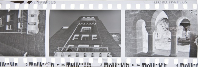

Can you supply us with a backlit digital photo of the negatives themselves, with the edges and the space between the frames clearly visible.
Something like this, please.
(thanks to foc - I borrowed this from one of his posts).
Your negatives will, of course, be orange coloured colour negatives.
For the backlight, a window or a blank tablet/computer/cel phone screen works well, and the digital cameras in cel phones can usually do this too.
Be mindful of the file size limits when you upload,

Forgive me for asking, but when you say you were using the camera's meter plus another meter, did you set the camera's shutter speed and aperture according to the meters' recommendations?

Along the same lines, what metering method were you using -- metered-manual, aperture-priority, shutter-priority, programmed???? We need more details about what you did. Otherwise we have to guess.
Hi, yes i set the shutter speed and aperture according to the recommendations. Metering method was aperture-priority :smile:

Sure looks like plain underexposure.
You need to double check that you are doing everything right. ISO setting of the film, be sure you are using auto metering, no compensation etc.
In fact best to get a quick lookover from a photo shop, to see that everything is working right.

About the negatives - it might be the case that you had perfect exposures and the lab completely screwed up the scans. The only way to know for sure is to have the negs yourself. But hey, it's just your first roll.
Looks like a lab scanner trying to boost underexposed frames.
Best bet for now is that it’s compensation that has been set without OP knowing what it is.
Or the camera could simply be broken.
