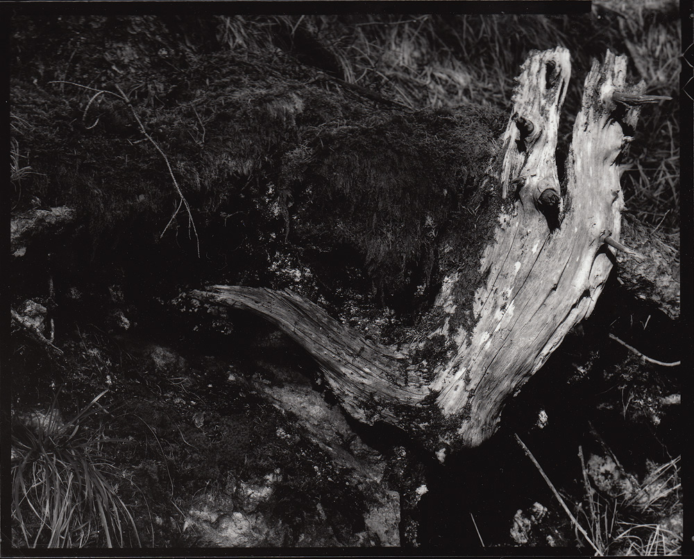

My take here is just to complement your review with my own data for the sheet film version, in this case 4x5. This is densitometry (or sensitometry) data for my specific developing procedure (PyrocatHD 1.5:1:260), but it might be useful for someone else, specially because I include a short reciprocity test.
So, in one of the figures you will see how the gradient changes for different durations of my developing: 12 min, 24 min, 36 min and 48 min. In another figure how the gradient changes for the same exposure but using different exposure times: 0.3 s, 2.4 s and 9.6 s, and developing time: 36 min. As you can see at least until 9.6 s there is no significant reciprocity failure - the gradient is essentially the same. I wanted to make further tests with longer exposures but have been under heavy workload...maybe next week.
I don't like to compare density curves from different films but for a reference I can say that for the same developing conditions (36 min) the gradient of Adox CHS100II is lower than that of Fomapan 100, but not by a lot (0.58 vs. 0.64). This means that Adox is slightly less contrasty than Fomapan.
Included is also a photograph I have taken with this sheet film and developed for 36 min. While there is some sky in the photo it really is very small and dark since I used an orange filter and thus cannot comment on its spectral response. Arguably it is one its greates strengths so I am curious to try portraits and open landscapes. This is a scanned negative, as I haven't had the time to print it, but I have not processed it digitally.
I must say I enjoy this film a lot. Kudos to Adox!
