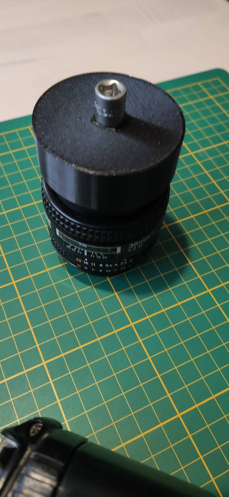

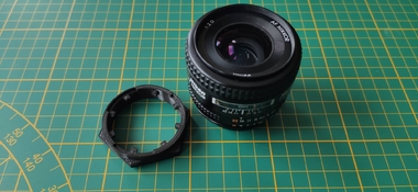

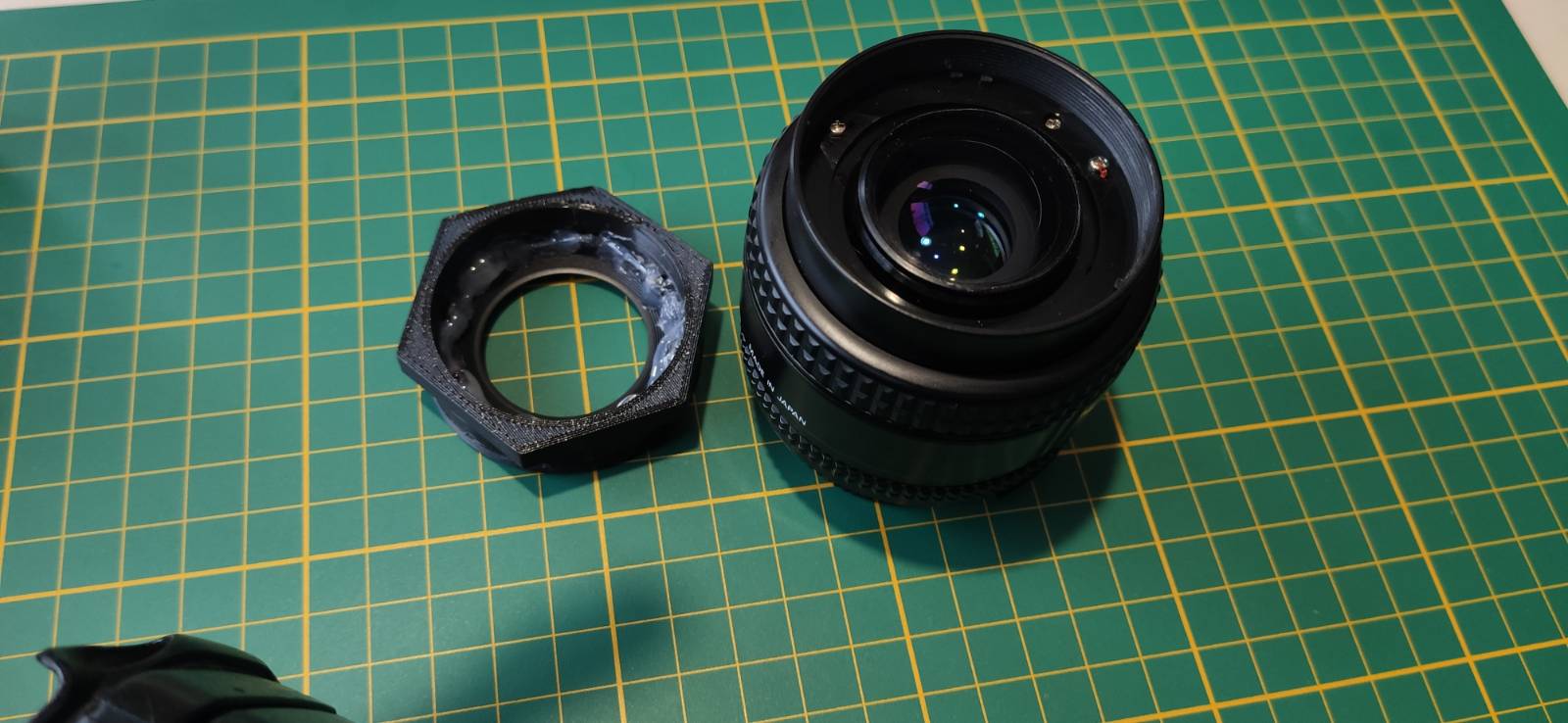

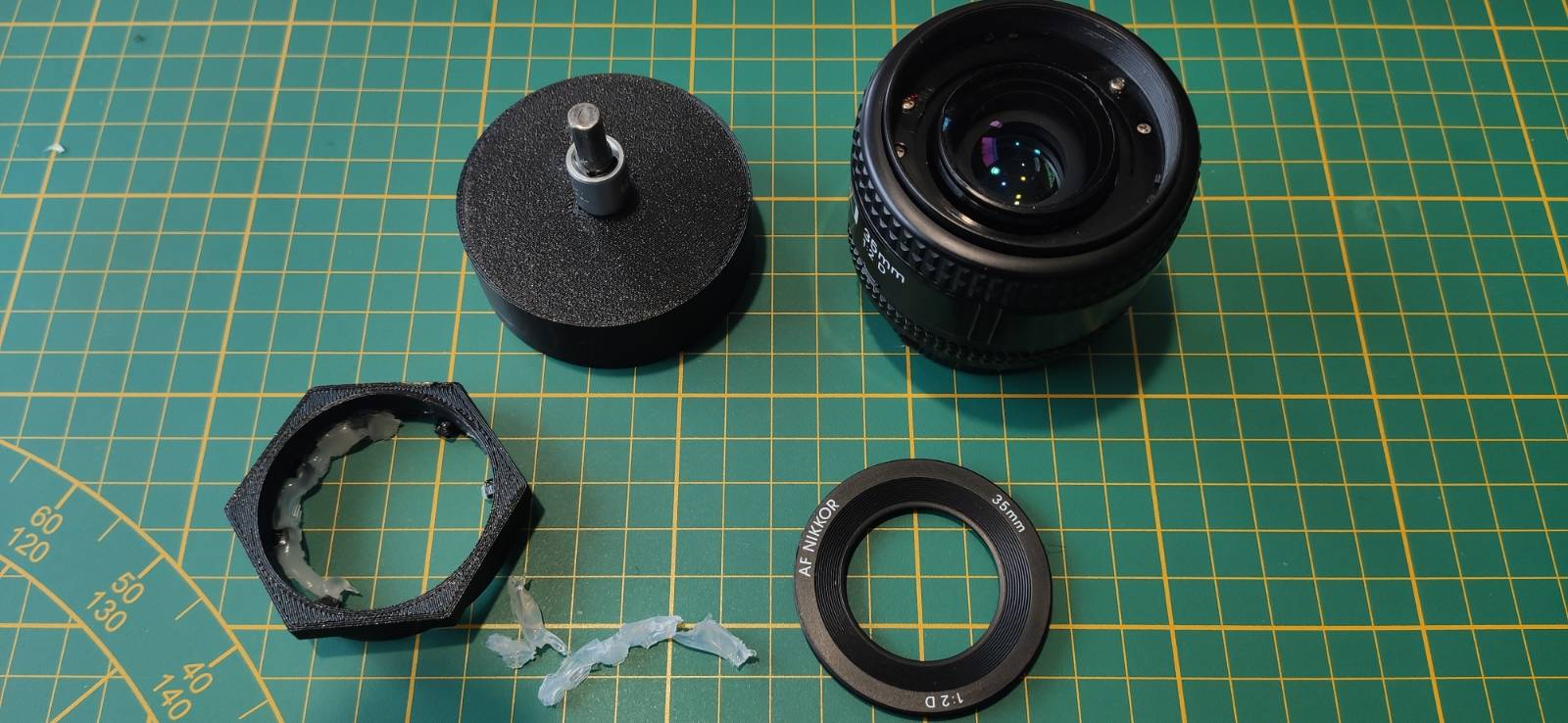

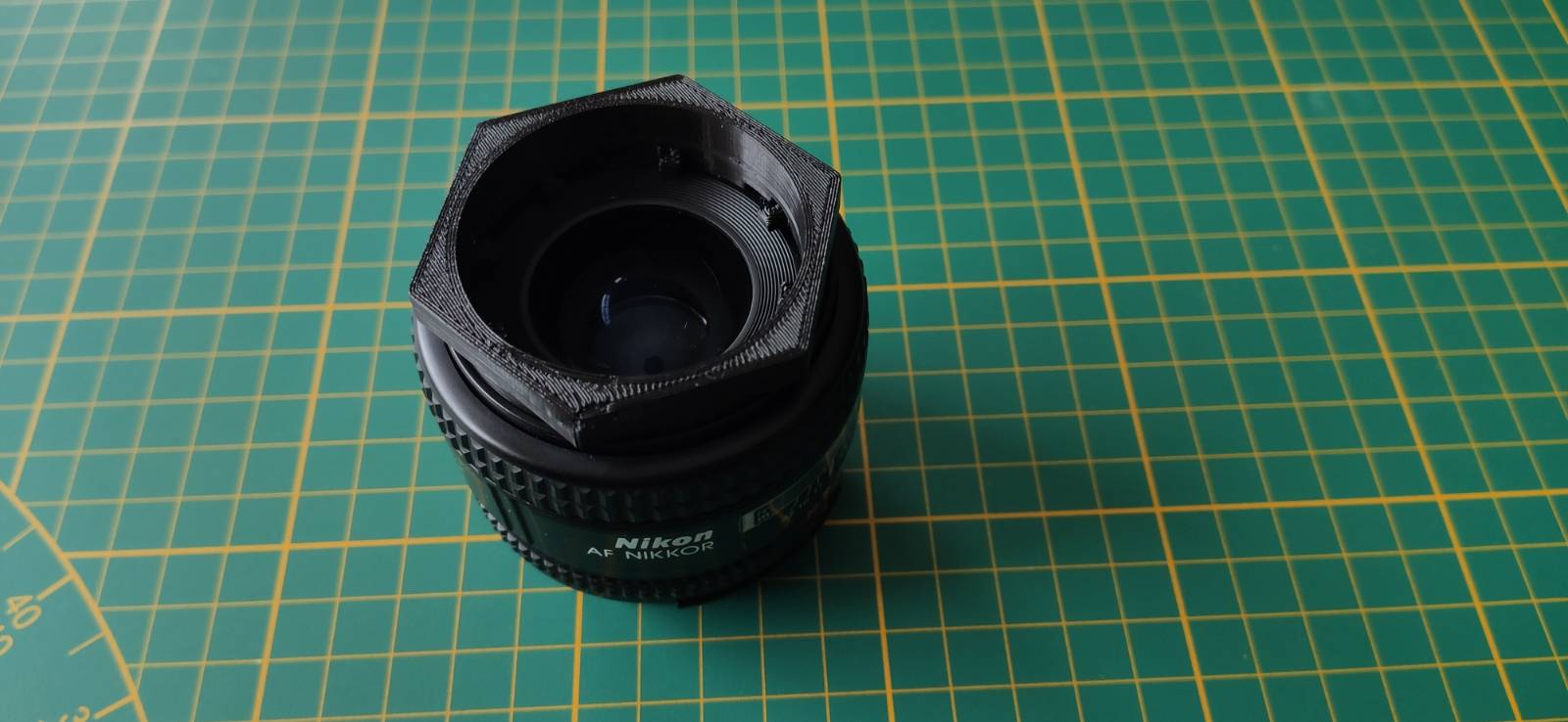

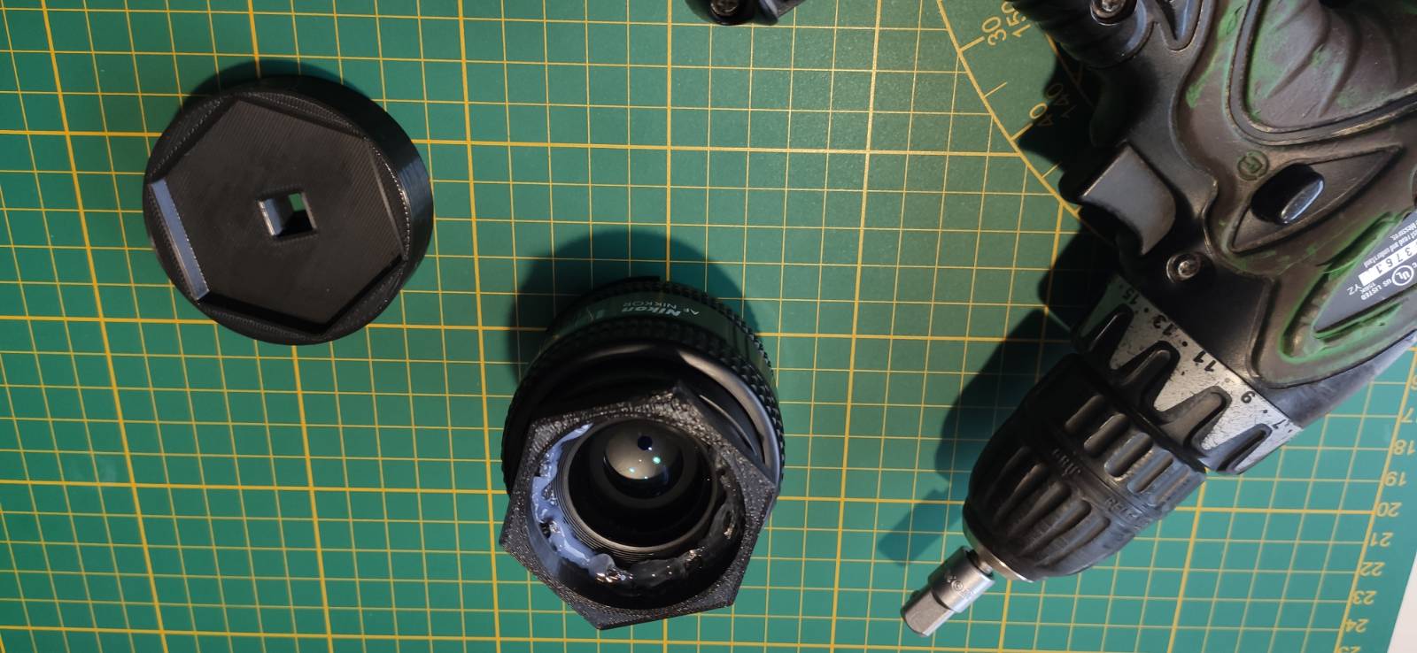

I’ll describe my weekend story - maybe it will be useful to someone in the future.
Recently, I bought a Nikkor AF 35mm f/2D lens in very good condition, except for an oily and sticky aperture blades. Since cleaning it isn’t a big problem, I decided to do it myself. I have some experience repairing photographic equipment as well as the necessary tools. However, this lens turned out to be quite a challenge. The front name ring was screwed in crooked and jammed. It might have been a factory defect, because once I finally managed to unscrew it, the inside of the lens appeared untouched.
None of the standard tools for unscrewing rings were able to loosen this ring. At first, I 3D-printed a simple ring with a diameter small enough to fit inside the lens. I warmed the part of the front barrel a bit with a hair dryer, then pressed quite hard the lens onto the ring so that the thread would fall back into its proper position.
Now the ring was straight but I still wasn’t able to unscrew it. I really didn’t want to damage the ring or lens, so I came up with an idea for another tool. This time it consisted of two parts: one that I glued to the ring using hot glue, and another that served as an adapter for a cordless drill.
And that did the trick! I think this method can be used to unscrew even very stubborn rings.
I’m attaching photos that more or less show what it looks like.

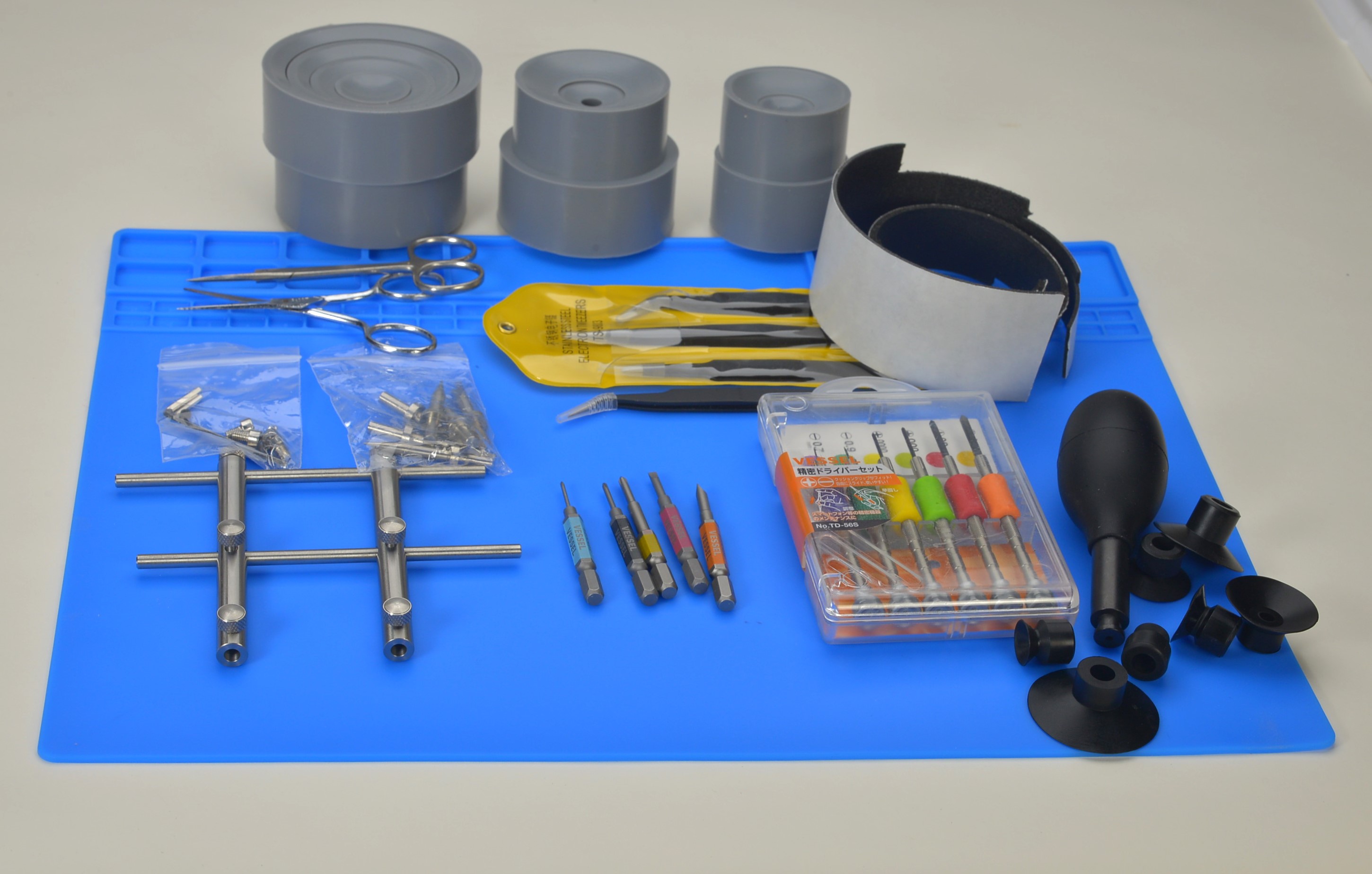

I have a 35mm Nikon lens that has oil on the aperture blades. I have watched a YouTube video on the procedure, evidently it is a common problem with this lens. I have acquired the tools I think that I will need but could use your opinion if I need any other tools for this repair. Here is a Picture of my tools:
I have already hit a snag. The first step is to remove the beauty ring on the front of the lens. I have the proper size rubber tool, but it will not budge. I have put double sided cloth tape on the ring, but it will not budge. Anyone have any idea as to how to remove that ring?
Any help that you can give this novice repairman would be great.
