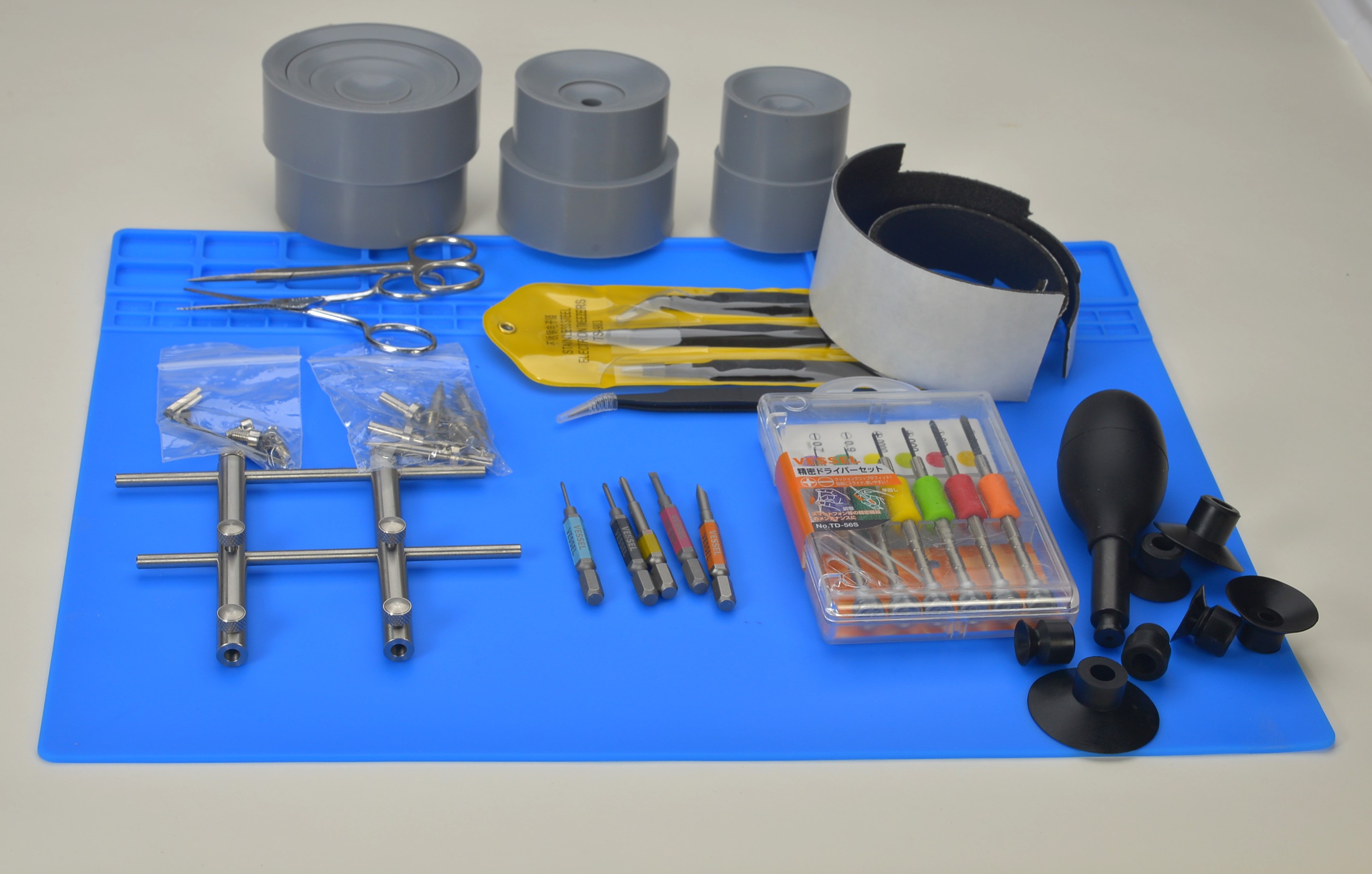

I have a 35mm Nikon lens that has oil on the aperture blades. I have watched a YouTube video on the procedure, evidently it is a common problem with this lens. I have acquired the tools I think that I will need but could use your opinion if I need any other tools for this repair. Here is a Picture of my tools:
I have already hit a snag. The first step is to remove the beauty ring on the front of the lens. I have the proper size rubber tool, but it will not budge. I have put double sided cloth tape on the ring, but it will not budge. Anyone have any idea as to how to remove that ring?

As far as I can see, you're very well equipped. Even the Vessel JIS bits are on your table. Which holder do you use them with?
For lenses, I would prefer JIS screwdrivers with a larger handle, as this gives you more torque, especially with the bayonet screws, which can be very tight.

I found a Youtube video on repairing my lens and the presenter goes in from the front of the lens. He shows the beauty ring screwing out of the lens and I have not been able to budge that ring.
These rings are often stubborn, but can often be loosened with a bit of WD-40.
To do this, I dab a little bit of it on the thread in several places using a cleaning swab. The oil finds its way through and if you have patience and wait at least two hours, you can use the spanner wrench.
Once the ring is off, I clean the thread with isopropyl alcohol and the ring can then be screwed in easily using the remaining WD-40.
It is important to pay attention to the angle so that the ring does not get stuck in the thread. To do this, I loosely turn the ring anti-clockwise on the thread until it clicks into place with a slight tug. Then screw it in clockwise. It is best to use a plastic or wooden swab on the grooves and only use the spanner wrench last.
It is safer to work with it if you press the spanner wrench firmly into the two grooves on the ring and just turn the lens.
If you slip and scratch the paint, it's not a big deal, you can repair it with black paint.
The spanner wrench is the tool that requires the most attention and control, as a lot of force is applied to two small spots.

I'm reluctant to use my the lens spanner similar to yours. I have my heart in my mouth when using it, in case of slips.
Also, the tips are way too big to fit the ring spanner slots in my case.

The "vacuum pads" from Japan Hobby Tools have a much superior grip to those gray rubber plugs btw.

OAPOLi, I even tried both IPA, Naptha, and lighter fluid and picked up the Japan Hobby black rubber cups, still no joy.

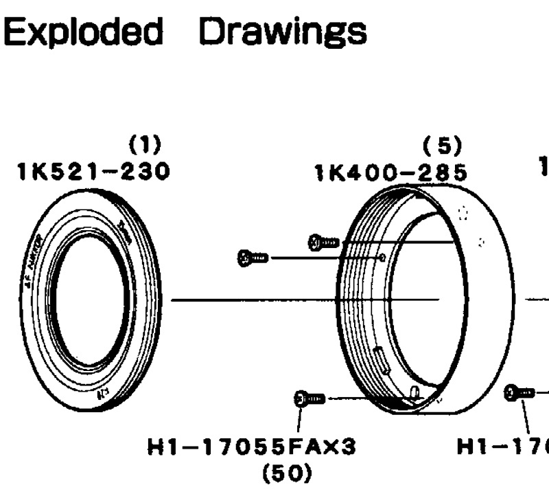

From the service manual, the ring is screwed in.
You could drill two holes for the lens spanner and try to unscrew it. The last possible measure that comes to mind. You can close the holes with Sugru.
