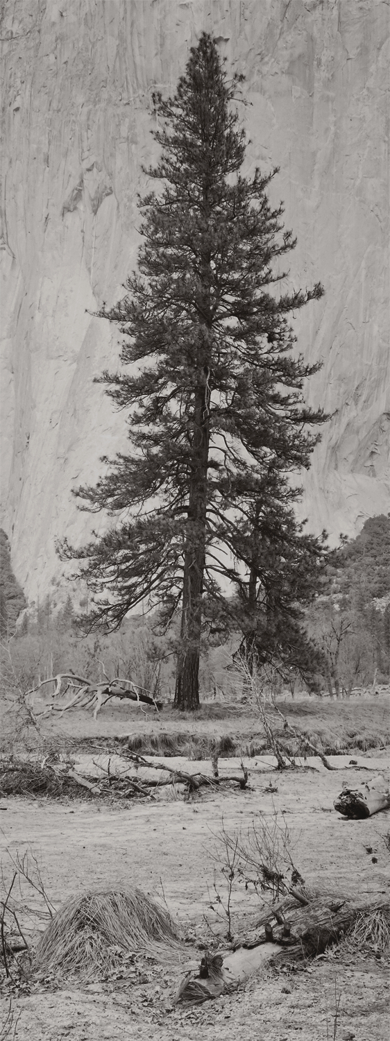

Here's me not wanting sky so much I put a big rock behind the tree.
5.5"x14" platinum/palladium print (FP4+ in PyrocatHD)
