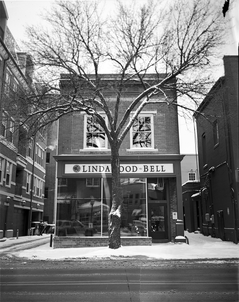

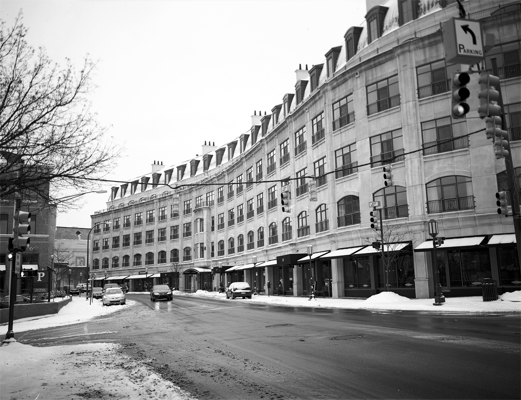

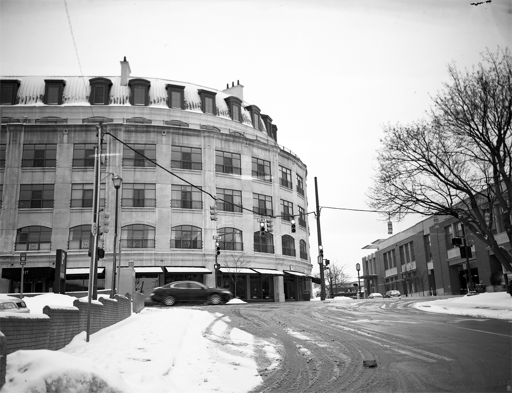

I very recently got into LF photography when I picked up a beautiful Toyo 45CX and 135mm 5.6 Fujinon lens from a fellow APUG member. It took a couple *ahem* experiments :whistling: to get some decent photos out of the camera but I have a couple questions:
1. In all three photographs, why are the tree tops so out of focus? Is it just the super slim DoF considering the larger film plane (these were all shot at f/5.6). Also IIRC these were all shot at 1/30 second and there wasn't very much wind.
2. Also in the first and second photo, you can see the little black artifact in the top right of the frame. Any idea what this can be?

Were you using movements? If so they look a bit extreme; if not, perhaps some perspective correction should have been considered.
Artifact in 2nd picture looks like vignetting. Artifact on first image looks like emulsion loss somewhere in the process. What film was that?

My guess is that you had someone process the film rather than doing it yourself and both artifacts (1&2) were cause by the clips used to hang the negatives to dry. Bill Barber
It looks to me that the trees are in front (closer to the camera) than the plane of focus (ie: out of focus). At 5.6 there is not a lot of room for DOF especially in front of the plane of focus. It looks like you focused on the store front and the trunk of the tree retains some focus but the branches leaning towards you become out of focus.
I don't know what the artifact is but it appears to me it occurs to different degrees in photos 2 & 3.
Brian, no movements were used in these photos. I should have probably corrected the perspective distortion that makes the buildings look like they're falling backwards but didn't think of it at the time unfortunately. Also, these were shot on Ilford Delta 100 Pro film.
Bill, the film was processed in a 1+25 dilution of Rodinal for 9:00 in my 135/120 development tank using the "taco" method. IIRC the film was not clipped in those locations.
Bruce, I had a feeling that's what it might have been. I was just curious because the other two photos seem to have a deeper DoF despite having the same architecture. But I do understand that they are compositionally different and the distances may have had an effect on the DoF.

I assume the artifact is there on the negatives, not something that happened during printing or scanning? It looks in both cases like a nasty scratch/scrape, more than you would normally get during development without some really extreme event. Any chance you accidentally beat those corners up pretty badly during loading/unloading, or during the taco-making process?

I think the blurry trees are due to you having some lens tilt and shallow depth of field based on the aperture you chose (f/5.6). For the first shot I probably would have shot at f/16 minimum (probably owuld have used f/22) if I wanted the trees in focus along with the store front. But I think you had lens tilt because road in the foreground is more in focus than the tree tops and the top of the front building facades. In addition your background buildings are sharper at the top than the bottom (at least it looks that way form the small scan).
My guess is the black artifacts are scratches in the emulsion from your processing. In the first shot it also looks like there's a processing artifact in the upper right. Maybe uneven developer flow or wetting.

Agree with the others, the black splotches look like scratches and scraped on the negative. You say you used the 'taco' method, but in what tank? Inversions? The film taco could have hit the lid of the tank, or the funnel in the top, when inverting. (or clips when drying, or holder in scanner, the list goes on). Also, is that a crinkle or something in the road of #1?

I'd suggest the black marks are emulsion damage from the taco style developing. I gave up on that way of doing things after similar problems. If you curl the processed sheet the same way it was in the tank and look at it, it's pretty clear how likely it is for one sharp corner to be scratching the emulsion as the film moves around during agitation.
The first photo, the building is falling back slightly which goes along with your no movements idea. The front standard and rear standard should be level to keep a upright plane of focus. It doesn't take much to alter that. Raise the front standard if you want to correct for the building falling back. Basically keep things vertical if you want the plane of focus to be vertical. More aperture for more depth of field is good too. It appears there are some scratches on the film in the first photo, as you've mentioned in the corner, dust would show up light (as it blocks light and is value inverted by scanning/printing)
To me, the artifacts look like a couple of very large chunks of dust on the film.

The spot in the first image is pretty bad, looks more like emulsion damage than dust to me. Could be from lots of things, one of the more likely is a film clip allowed onto the image area, or pulling the film from a clip rather than releasing the clip.
These were items I noticed too, as well as I agree with the corrections required. Years back when I first started using 4x5 I never used the movements. Moving from MF to LF it was nothing more then a larger image to me. But, to prevent the "keystone" effect as I've known it where tops of buildings and trees tip backwards movements are required. In a lot of cases it's not how you do it, it's recognizing the need to adjust to the cause and affect one way or another.

You have a good eye and are going to take a lot of wonderful photos with your LF. But I agree with the others, you need to think f11, 16 or 22. In the third photo the center of the pic (about where the car on the right is) is about the only thing in focus. You need to stop it down -- unless what you got was what you want.
