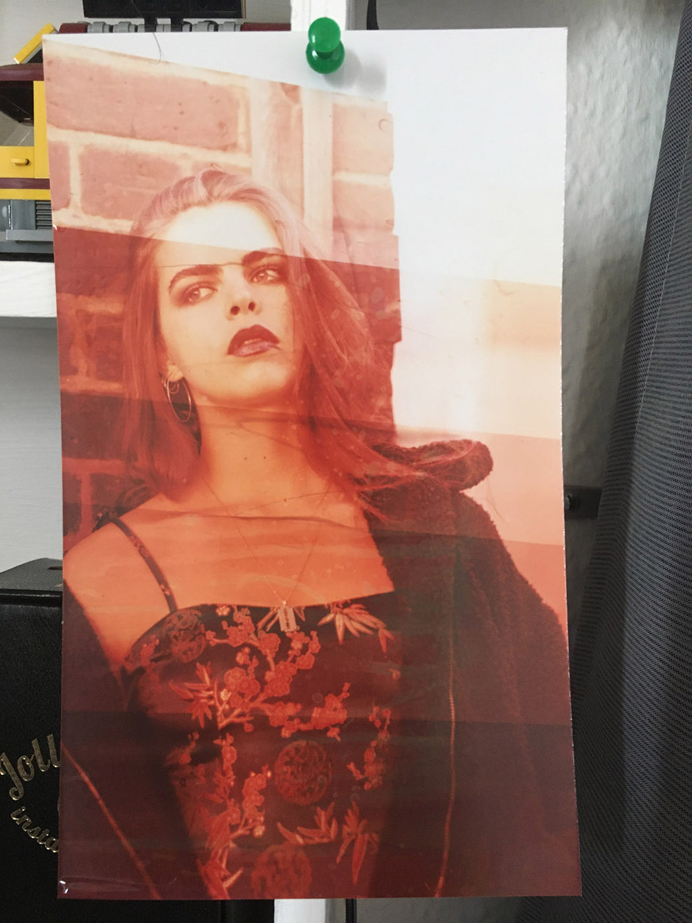

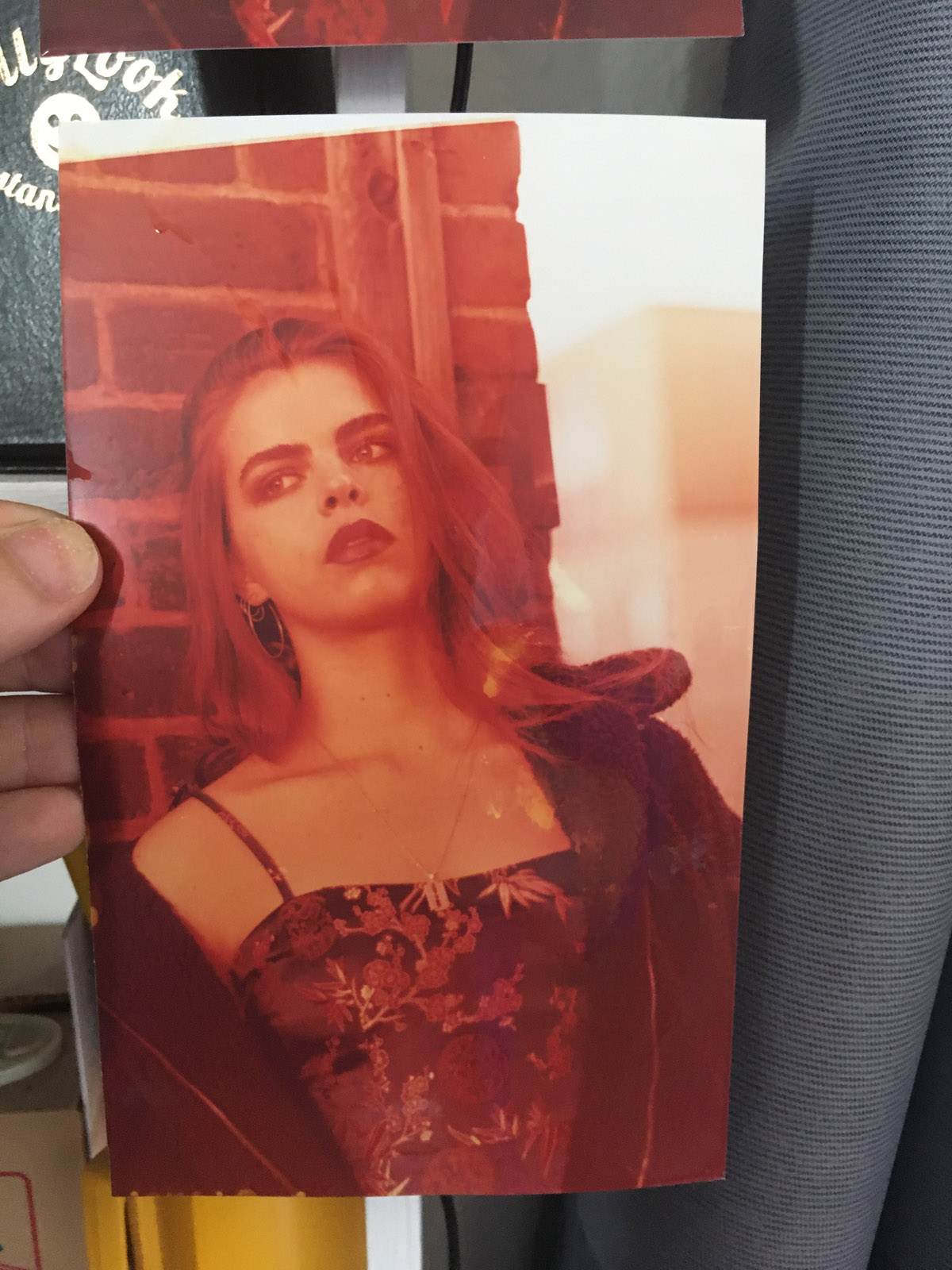

I finally got my act together to make my first ever home prints (after helpful advice here) and they have turned out reddish brown, despite me using different filter settings on the two I made.
I'll post the two images to show they are doing the same thing then explain my process.
Testing exposure. I think the greenish streaks are from me incorrectly using the CPE2 tanks.. f11 @ 2sec-increments. filter: 70Y 50M 00C.
Dunno what the marks are, any thoughts for a newbie? f11 @ 6sec. filter: 0Y 0M 0C
So, as you can see, the filters seemed to do nothing. I use Durst 670 Colour > Fuji paper Crystal Archive Paper > Kodak Ektacolor RA4 > JOBO CPE2. 1min DEV, 1min BLIX.

Hard to tell on a computer, but it looks like you could try reducing magenta considerably, say by up to 40.
Did you look at first image for comparison? The colours look the same and Magenta reduced from 50 to 0 (as well as Yellow from 70 to 0) as per notes above. Seems not to have had an effect.
EDIT: I've edited the original post to properly show both now.
I agree I can see no difference either. Based on this the only conclusion I can draw is that your dichroic head filters are not working i.e. the dials are not operating the filters. An easy way to check. Shine the enlarger lamp through an empty neg carrier with everything at 0 then dial in yellow only and see if there is a change in colour on the easel and does it get stronger. Return the Y to 0 and do the same with M and then C
Thanks pentaxuser, here are my results:
Y - no change from 0 at all
M - clear change from 0 to 5 (went more magenta), no change above that (so it sorta seems like an on/off or binary state, I don't know if this is wrong)
C - clear change from 0 to 5 (went more cyan), again no change beyond 5

Mike, what's the range of units your dials cover. For instance my Durst is 0-130 for all three so no change after 5 would indicate that my dials were making no change after just a tiny amount of whatever the colour is.
I think it safe to say that the colour filters are not working or as good as not working. This may or may not be something that you can fix.
Do you have an instruction manual and does this allow you to dismantle it enough to see inside to see what is going on

Start of with a a filter pack of 50Y+50M with a test strip. Don't increase the time to increase the test for density. Use the f stop on your enlarger lens. RA4 has characteristics when you increase the time, the color will shift.

Yes I wasn't really sure why finding the white light lever was important but as you used the word progress I think you mean that the filters were not working becuase the white light lever was still swing in its position where all the filters are out of the way. Doesn't really explain why up to 5 worked in M and C though or maybe you only thought that some C and M were showing. The white light lever should remove all filtration I'd have thought
pentaxuser
The white light lever is important. I missed that. I've left my white light on with my Beseler 45S dichroic head and had the same problem.. It's great for focusing you image, but if you're forgetful like me, it will happen.

Test successful, much better colours, so glad!
Good point, need to work on this lot more.
I know it shouldn't affect the light if they're out of the way, but they definitely did, but nowhere near the amount with the filters actually on.
