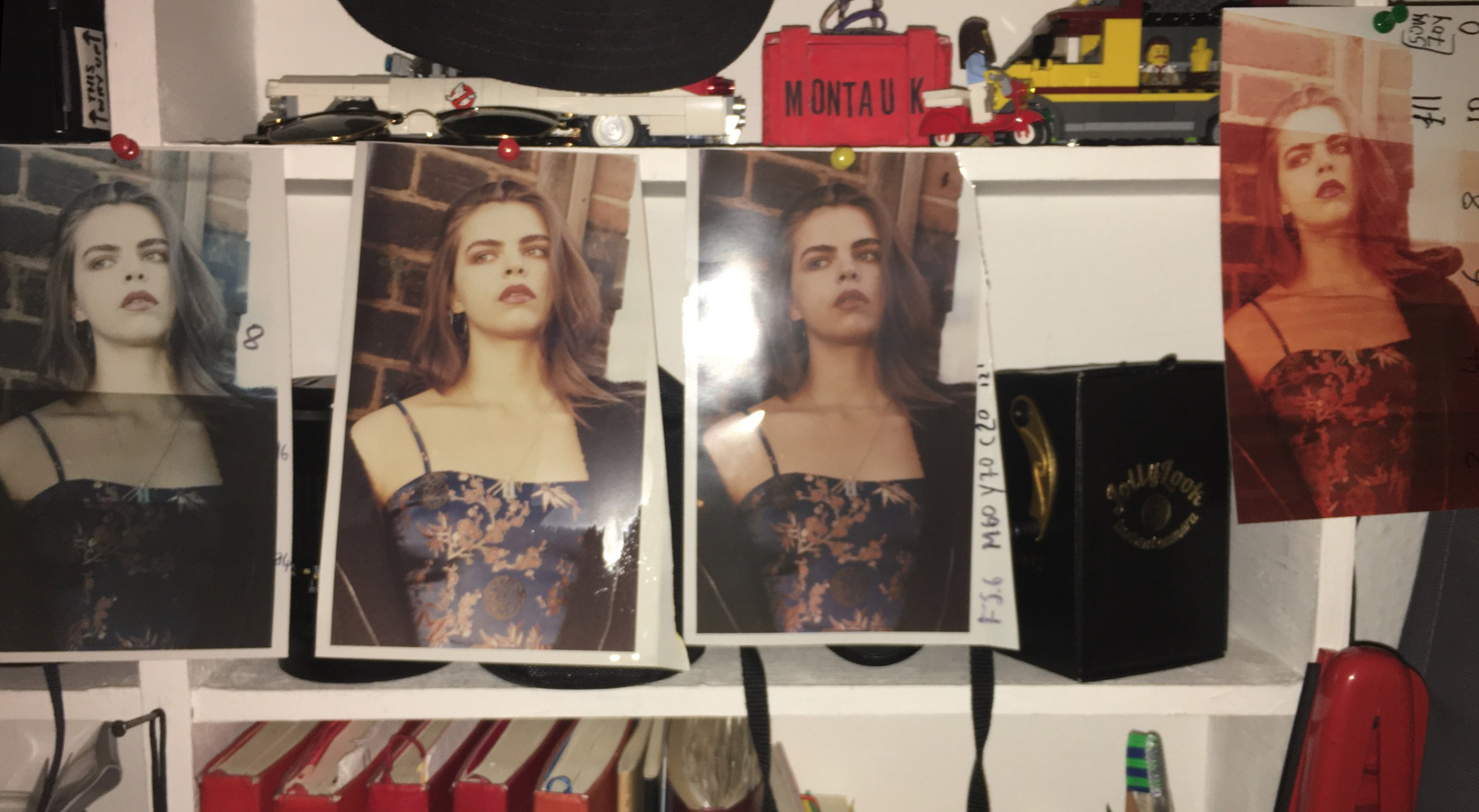

Okay, so I used up the last few sheets of my paper supply getting closer.
I ended up closest with M65 Y70 C20 (though not quite what I was hoping for)
I wasn't getting deep blacks no matter what I did (even on overexposed prints, the shadows were a bit washed out) - so I tried a technique in my darkroom book: close down a stop then increase develop time by 30%. This didn't turn out like I had hopd and was my last attempt.
I wasn't having these issues when I was taught a couple of years back and don't have the experience to know why my blacks are muddy.
I also regret making an arbitrary choice of negative, perhaps not the best choice for practice, but the experience is worthwhile.
I'm going to order a pack of paper now..
Sorry for the quality of this image!

From left to right print 2 looks very close to what I think it should be. The blacks don't look particularly muddy but yes there is a kind of muddiness in the prints overall but this could be due to the contents of the scene . They don't sparkle as much as you might have hoped for. It might be that fresh paper will help and a scene on a bright day with a person showing a reasonable amount of skin and a range of colours The lady and her dress with dark brick in the background may not be ideal
You might want to overexpose the film by a stop but I'd stick to the 3' 15" for the film and I'd use an in-date film as well

Thanks @pentaxuser
Print 3 from the left is closer to what I'm after, more detail in the skin etc. Definitely somewhere between the two.
I always use in-date film and am able to get the results I want from scanning the negatives directly, so I think it's in the enlarging that something's not quite there.
I know it's not a good image to properly analyse but I'd like the blacks to be at least as black as the black items behind and the colours to be significantly more vibrant. See my website for the kind of contrast / saturation I'm aiming for..
Anyway, pack of paper ordered and next week I'll give it another go.

I have had a look at the pics on your website and assuming these are all scans of enlargement prints from C41 film then the key question is what has changed in this latest print compared to these previous pictures? Something clearly has.
