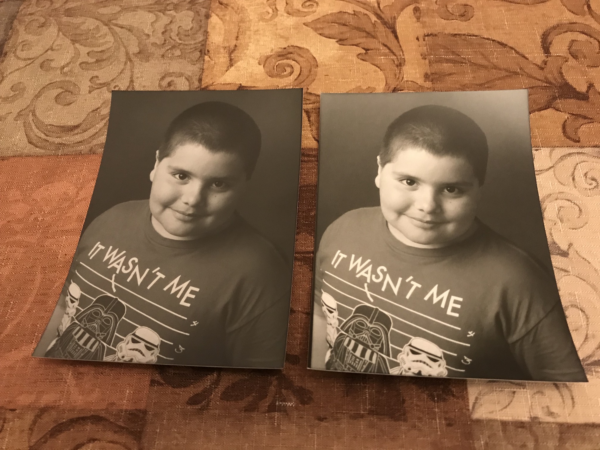

For quite a while now, I’ve been working on getting a dedicated darkroom and just did my first ever darkroom print.
Being a a totally hybrid guy, my first ever silver gelatin print was produced the following way:
I shot a studio portrait of one of my kids on a 24MP DSLR
In Lightroom I post processed the file to my taste, then in PS I converted it to black and white, inverted it, and adjusted from gamma 1.0 to gamma 0.615 so the it looks like a film negative.
Flip it horizontal and print it out in bw mode on canon pro-1000 and inkpress RC inkjet paper in 5x7 and 600dpi
Make a contact exposure of the inkjet print onto 5x7 Arista.EDU pearl paper. 3.9 seconds, no filters.
Develop the print in dektol, fix in Kodak fixer.
The image on the left is the inkjet “digital negative”, the image on the right is the silver print.
For a first effort, this was shockingly easy to make with totally usable results. Looking at the dried print, I’d probably dial some more contrast, but otherwise it’s really sharp and looks good.

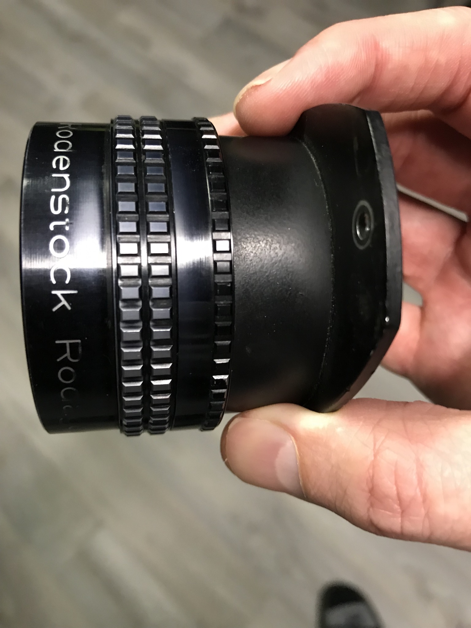

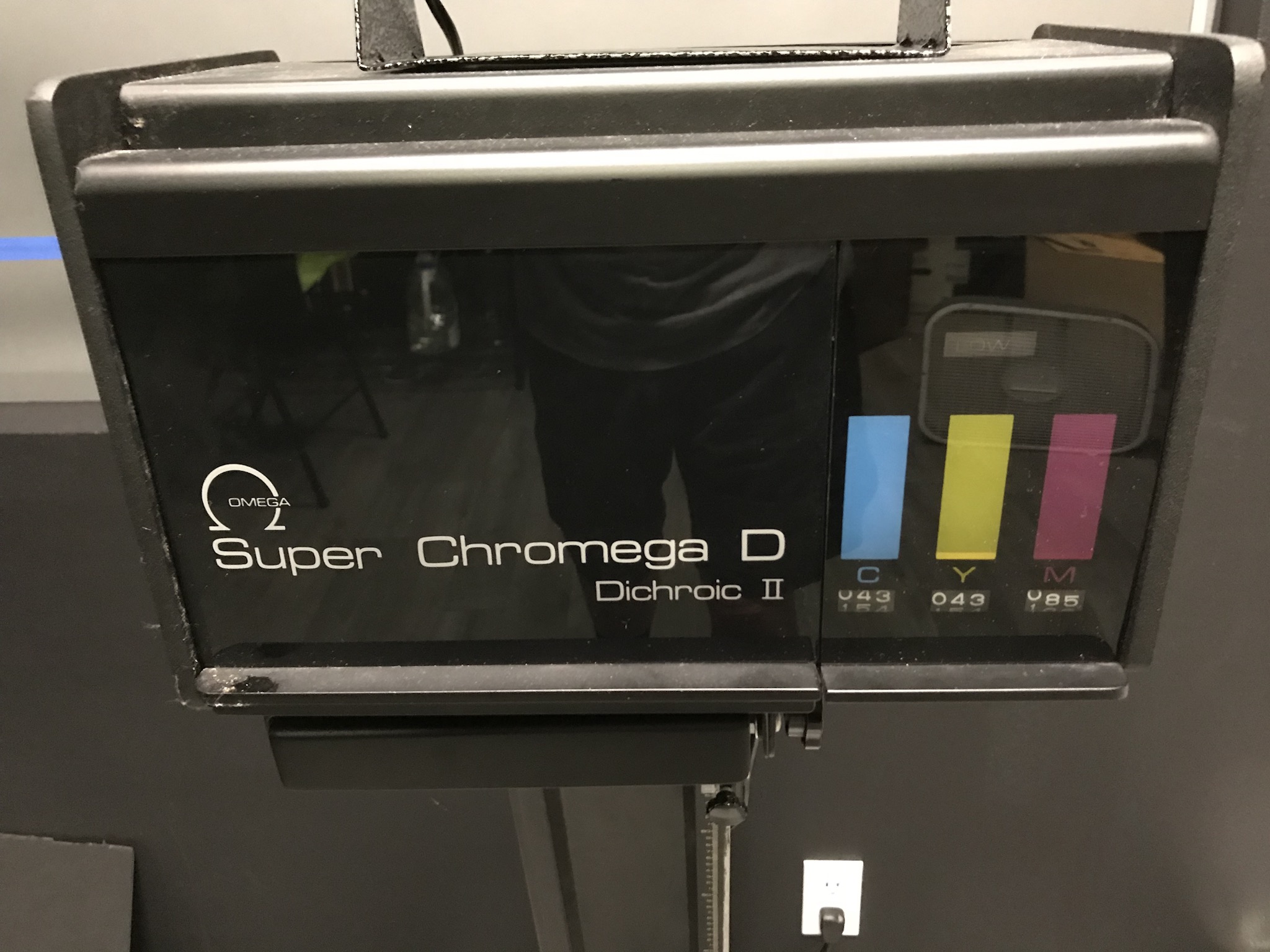

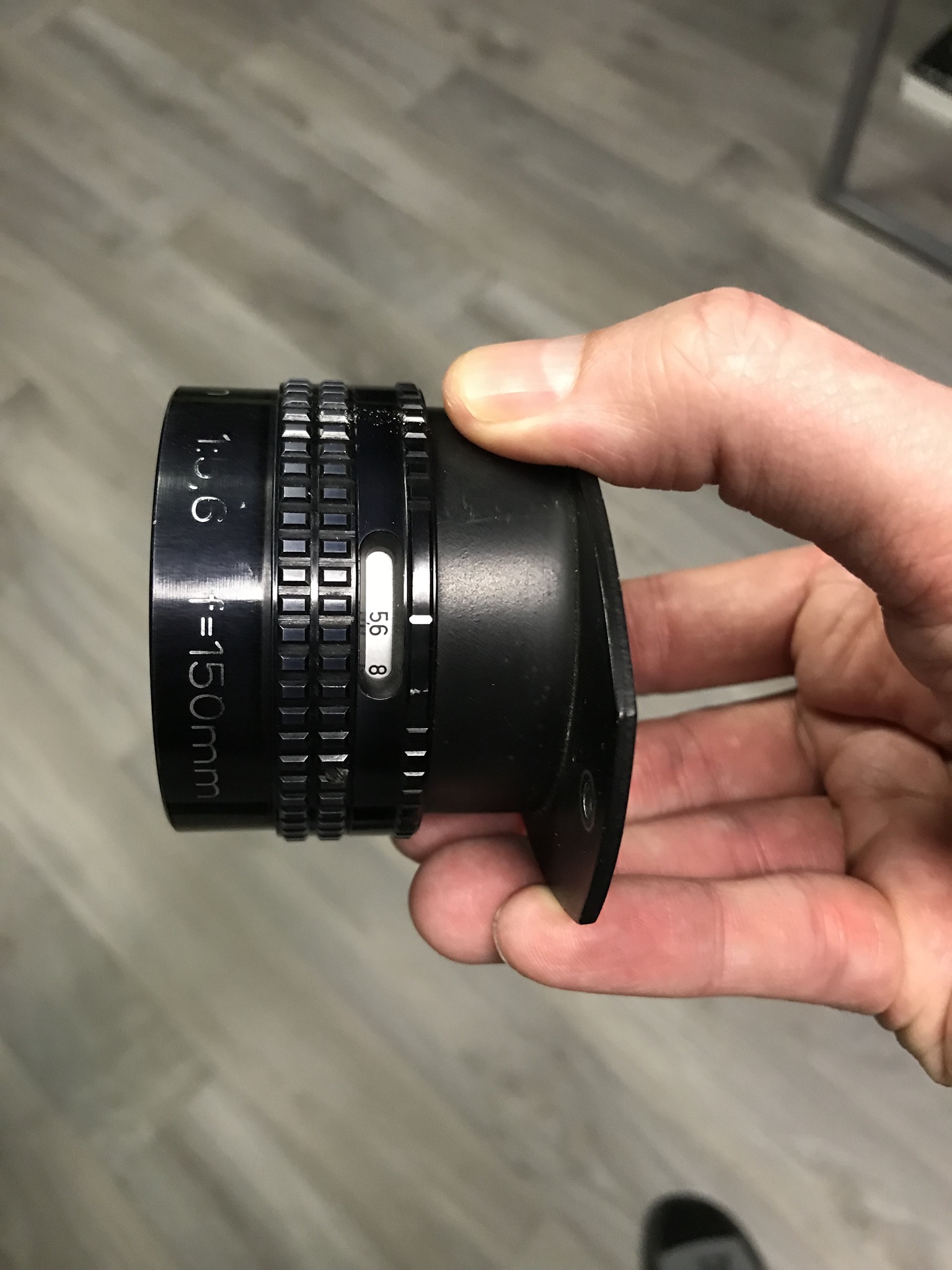

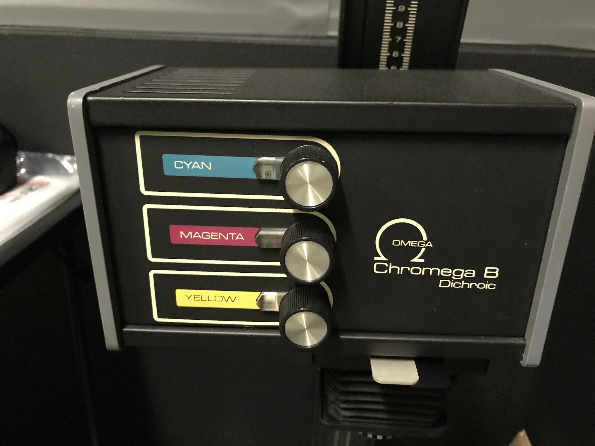

Those top pictures are pictures of the light source, not the enlarger per se.
The light source is removable, and sits on top of the enlarger itself. There are a few different types of light sources, and they are interchangeable, and some light sources can be used on more than one model.
The photos you posted are sort of like those wonderful eBay listings where all the photos are of the outside of the protective case!:D
If we could see the parts where the negative holders go in and the lens gets mounted, we might be able to tell what model the enlarger is. A shot of the upright columns might help as well.
Alternatively, there may be a plate on either the front or back of the upright column(s) that indicates the model number.
If it is an Omega D2, 5 or 6, (a guess) it looks to me like you already have a lens plate. The lens plate goes between the lens and a lens mount - either a single mount or a 3 lens turret.
Say it is an Omega D6. We could then go to KHB's site with respect to that enlarger, and it will tell us which lens mounts work. With that information, your search will be easier.
As an example, here is the link to KHB's page on the Omega D5/D6: http://www.khbphotografix.com/omega/Enlargers/D5.htm

Alright then, I'll be back in the darkroom tomorrow PM, so I'll get more detail on the big one then. The small one I'm not so concerned about as the guy I bought it from had it in his darkroom and used it almost every day for quite some time and he was moving and just needed to unload it. He was an older fellow and I guess just got tired of doing the film/print thing. He had two that where exactly alike, I snagged one. I've got a used Grablab 450 (I think) timer on it's way, so once that shows up, I'll put some 135 through it and make some prints.
The bigger one is kind of a frankenstein. When I bought it, it was supposed to be complete, but the guy who sold it sent just the baseboard, power supply, the head, and the part that slides up and down the column that the head mounts on. There was no column, no film carriers, no lens. He went silent and I never got the rest of the stuff, so I searched around and found a column and got the head and stuff mounted on the column and smoothly working with the tensioners so it doesn't come crashing down as soon as you unlock the column lock. I also found and got some film carriers for the sized negatives I usually shoot that fits. At this point it seems to have pretty much everything except a lens mounted on it. The power supply has the timer built in so I don't need a timer for it.

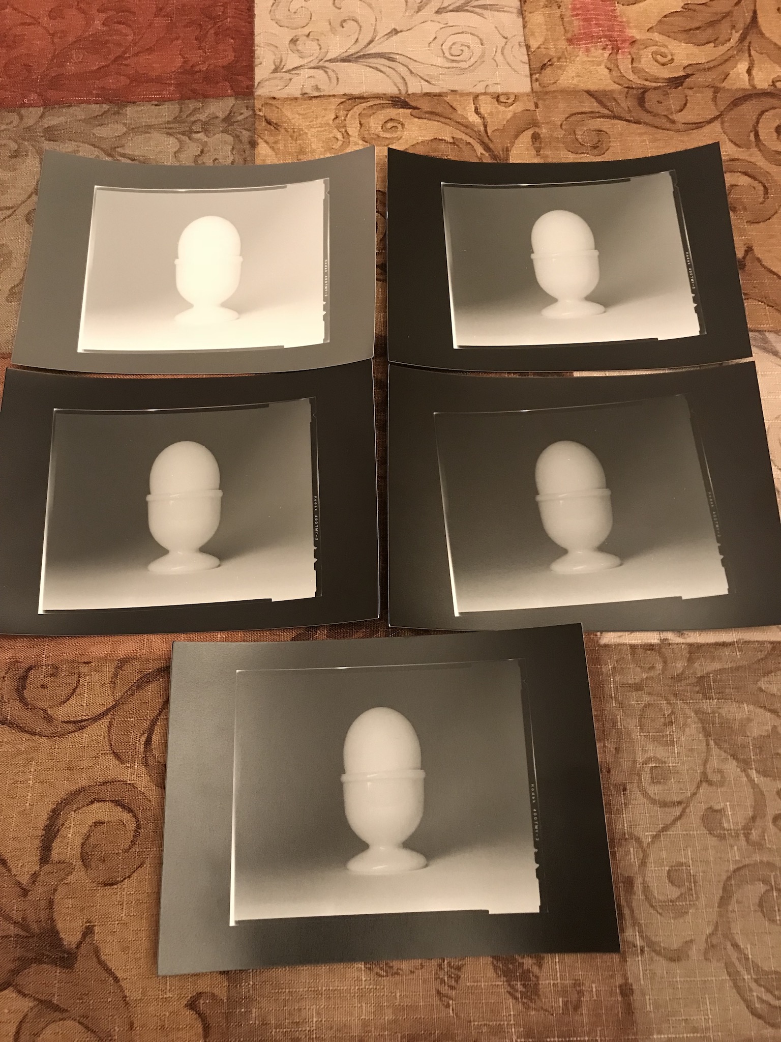

So, I messed around with doing a contact print of a 4x5 negative I recently shot. Figured I'd try out split grade printing. The results of the experiment
The bottom one is 6 seconds 170Y, 12 seconds 170M. I think I'd rather have the white of the egg a little whiter, so I'll try 5s 170Y and 10s 170M tomorrow.
Taking what I learned I re-did my first effort and just used the same inkjet print as before, but re-printed it with split grade:
The one on the left is the first effort, the one on the right is the re-worked one. This picture doesn't do it justice, but looking at the two side by side with my eyeballs, the revised one simply looks better in pretty much every way. The whites are whiter, the darks are sufficiently dark but don't lose details. Any more changes will be just that, just changes. Not really better or worse, just different. I supposed I could add some luminance noise to the original to make it look less clean, but that's totally aesthetic.
