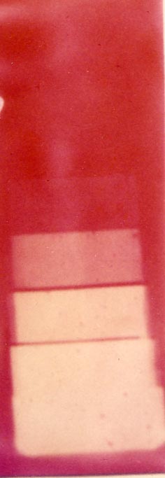

I thought the enthusiasts here might want to hear! I'm excited.
It is drying in the darkroom right now :whistling: . Scanning tomorrow.
I used Red 1 Azo dye in an AgCl coating and gave it a "normal" dye bleach process after a "normal" B&W process.
The Bleach was H2SO4 (~4%), Phenazine (~100 mg/l), NH4Br (~20 g/l), and Thiourea (~20 g/l).
I followed this by a wash and a blix and then a wash. I got a quite distinct positive magenta / red image. A lot of dye washed out even though I used an Aluminum mordant, and the coating blistered indicating poor hardening for this process.
But, it is my first color coating, not my last. :D
I have Metanil Yellow for the yellow layer, so if I can get a Cyan dye and a good red sensitizer for this emulsion....... Maybe. IDK. The only Cyan dye I can easily get is Chicago Blue, which is not the best "cyan" in the books but bleaches well.
PE

Don't laugh
Well, it looked better wet!
Here is the image that I got of the Stouffer step wedge. After scanning in the image I could clearly see both a negative yellow brown image and a positive dye image. I tried treating the brown area today and could do nothing to remove it.
The blemishes are due to the acid causing the gelatin to swell in a bubble and then burst. The spots appear to be due to dye washing out or being retained in some of the areas.
I can play with this in PS and get just about any enhancement to show more detail, better color, or even the dual neg-pos images, but this is the raw data.
As the title says, "don't laugh". Because then I would ask you to try it and see how you did on your first attempt! :wink:
PE
PE

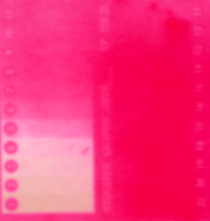

Similar coating done at EK
Here is a similar coating to the one shown in my first example.
I coated this by machine and it was one of the first Dye Bleach coatings I ever did. The process was close to what I used above. However, this machine coating was the result of a lot of experimentation using hand coatings to get the balance of silver and dye correct, and experiments to bind the dye in place.
Even so, this early example shows flaws.
PE
This is a complete dye bleach process from start to finish, quite similar to that used by Ilfochrome.
PE

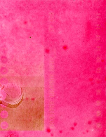

An AhHah moment - Second try.
I ran the first attempt posted here, on Strathmore paper, and thought that the paper fibers might be absorbing some chemicals and might also be reacting erratically. So, I repeated the experiment on Baryta paper. This scanned image still shows a bit of the negative image which is not apparent to the naked eye. Also, the hue shift across the paper is not very evident to the eye. It appears as more of a density change. So, the original looks better. Again, using PS tools I can make it look more like the eye sees it, but I think that the raw scan is the only fair way to post the example.
There is some mottle in the high density areas. IDK if that is in the silver or dye or bleach part of the overall sequence.
The original silver image is very sharp! The lack of sharpness in the final image indicates that there is too much silver, or too much phenazine or that the "system" needs a competer or a scavenger. Wandering phenazine in excess can drastically decrease sharpness.
You can see how sensitive any color system is!
Sequence at 20 deg C is as follows:
Develop 1' Dektol 1:3
Stop 30"
Fix in Kodak Hardening Fixer (alum).
Wash 10'
Dry to examine the results
........................< Dye step tb posted later
Dye Bleach 4'
Rinse 1'
RA4 blix 1'
Wash 4'
Dry
