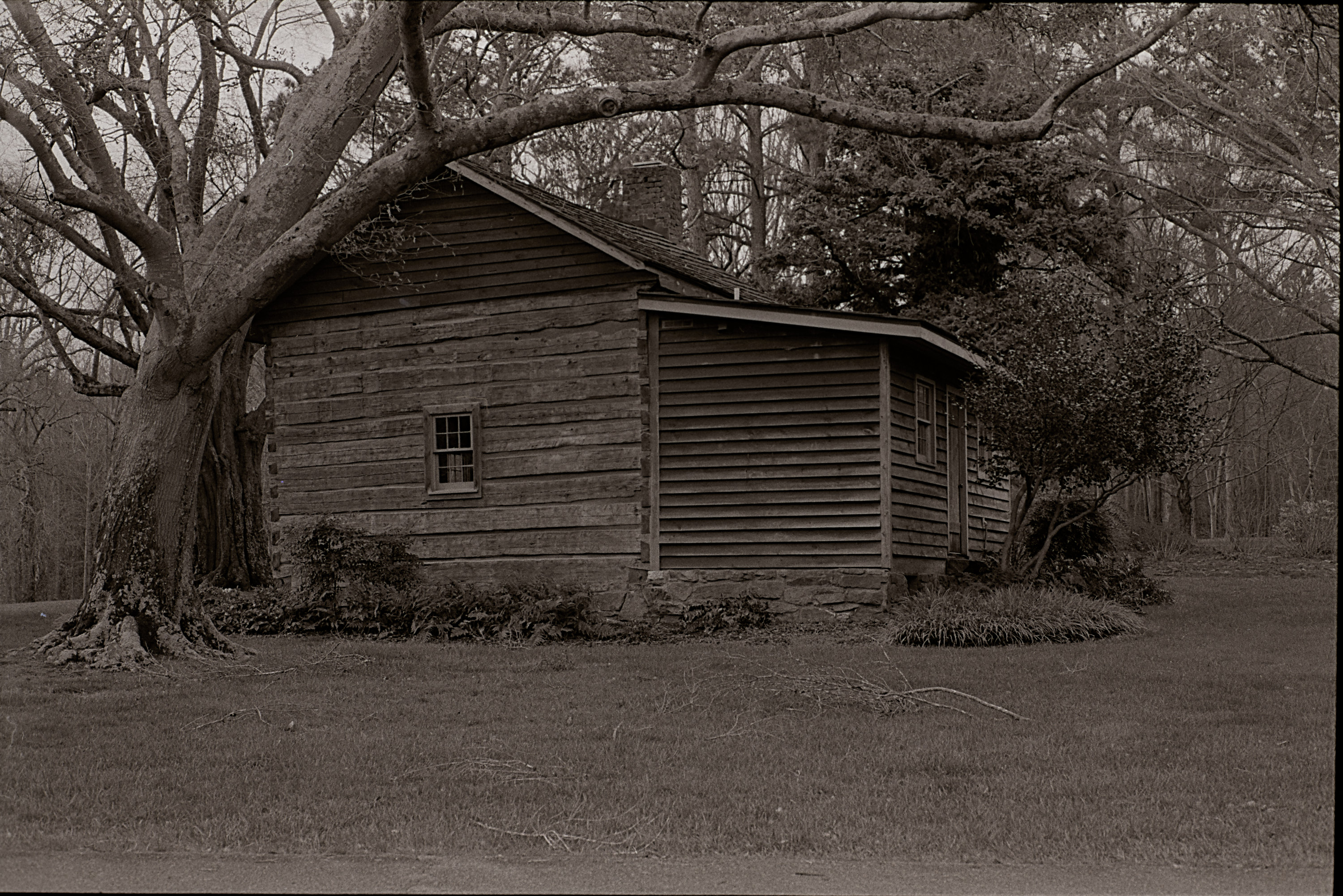

After reading and watching various techniques for scanning and copying negatives into a digital format, I decided to give it try. This turns out to be a test of several things. This last time I seriously made photos on film was decades ago. This is my second roll of film since getting a Nikon F5. This is Tri-X 400 at box speed. I copied the negative on a tracing LED light table I already had using a D800 and a Nikon 55mm 2.8 macro lens with extender. The D800 is at ISO 100, f11, 2" exposure. It is on a tripod facing down as well as on a macro focusing rail. I am holding the negative down by hand with some black foam board and capturing tethered into Capture One Pro 20. I think the focus was pretty good, but if I can hold the negative better it should be easier. A negative holder seems to have advantages over covering the negative with glass. I converted to a positive image be reversing the levels. I am pretty happy with my progress after an hour or so experimenting.
I don't have any prints from this roll, so I can't compare how well my setup is working. Let me know what you think of this example which I exported as a 3000 x 2000 pixel jpg.
I should have slept on this before posting. This morning I see that I didn't really get to black and white. Also I need to get the whole rig straighter. I had to do some leveling and keystone corrections which should not be needed. Two things contributed to this. The tripod attachment was a little too adjustable. I am going to use an L-bracket instead of the ball head next time to get the macro rail oriented the correct direction. A copy stand would also address this and give more working area than the tripod does. The second issue is ergonomics. I was working on the floor. I need to work on a table. As someone who was born when Nixon was Vice-President, I am not as flexible as I once was.

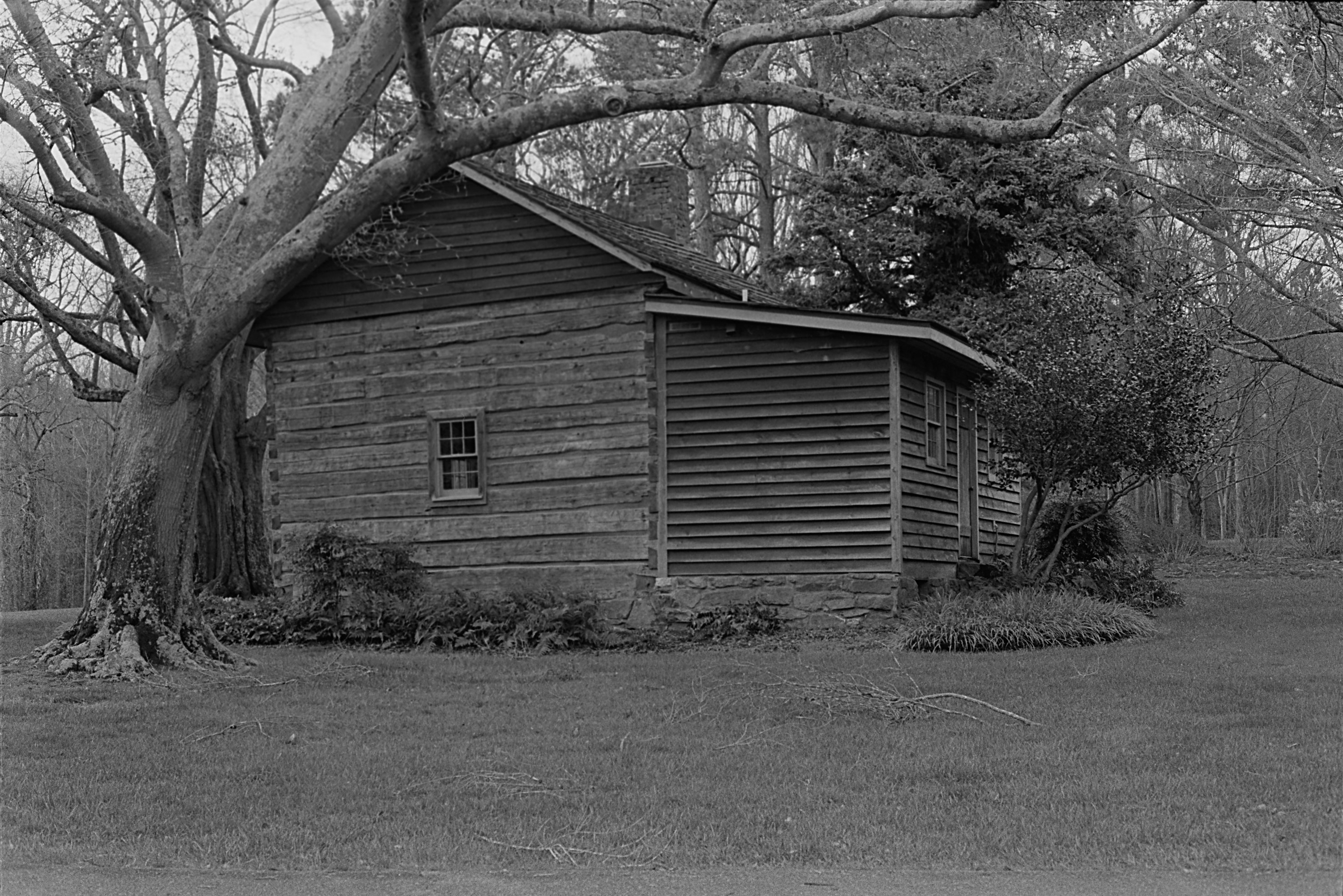

Here is the above image, actually in black and white. I added a user style in Capture One that can be applied as the images are captured. That is the right workflow although the style itself may need to be tweaked as I refine my setup.

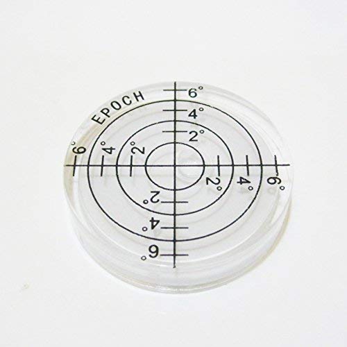

If you are working vertically - that is, if you are positioning the camera directly above your negatives - a bulls eye bubble level can help align the camera parallel with the negative.
