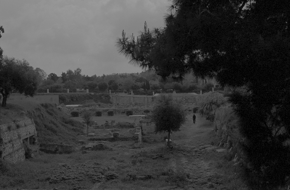

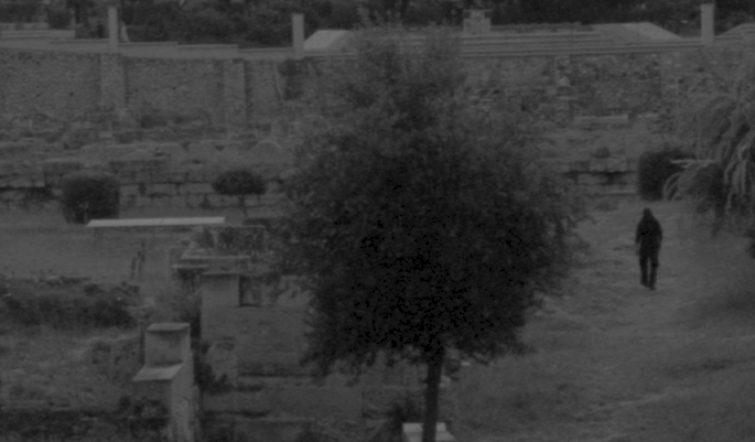

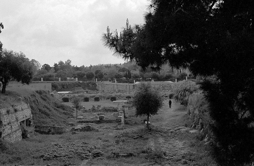

As said, first attempts both at developing and at scanning my first 2 rolls of TMAX 400 with HC-110. Can't say I like the result that much, I know there are better alternatives from the Epson V600 when it comes to 35mm but I believe it can do better than this. So, to see what I am talking about:
Any ideas how to improve detail and clarity?
Thanks!

Hi hoakin1981, I'm not familiar with the scanner you have, but my first suggestion would be to adjust your levels in your photo editing program, then adjust your brightness and contrast, and lastly add about 50% shapening to your image. Another idea is to scan in color setting then convert to B&W in your photo editing program. I find I lose less detail if I scan in color and then convert to B&W afterwards. Here's your image with the levels adjusted, a little brightness and contrast adjustment and 50% sharpening.

Thanks for the suggestions! Indeed the shot does look better. However, want I mostly need to establish I whether my original capture and film processing were executed correctly. Meaning that the final film I have to work with indeed has all the necessary information required to make a suitable digital version to work with.
Apparently the problem lies in the scanner's inability to capture the fine details on the film. Perhaps I do need to spend some time testing the color scanning process as well, I have read elsewhere that it does help even though the specific articles were 10 years old and I trust scanning technology has evolved from back then.

Hi hoakin1981... as noted over on APUG, probably the best way to evaluate your negatives is to examine them directly and, if you have the option, to print them the traditional (non-digital) way. With that out of the way... could you tell us what scanning software you are using? I have the Epson V700, which is probably quite similar and find the Epson software the comes with it nearly unusable. I have Lasersoft Silverfast, I don't use it and MUCH prefer Vuescan.
My workflow is to scan the negative 'raw' in Vuescan, which produces a linear TIF file with no adjustments by the software. Then I import the TIF file into Photoshop (using import as TIF, NOT using ACR) and invert it from neg to pos using ColorPerfect plugin. This gets me a decent file to work with and the rest can be done with PS curves and other adjustments.
However, if you want a quantum leap more and finer control of contrast, white/black levels, etc., the NIK Silver Effects Pro II plugin is worth a try. The fine control made possible by Nik Silver Effects Pro plugin is quite amazing.
Also, if you don't want to invest in ColorPerfect (colorneg/colorpos), you can still get excellent results with Vuescan doing the neg-pos conversion.
If you don't use Photoshop, then perhaps others will have alternative suggestions.

Hi! Thanks for the info. Indeed i trust an actual print from the negative would help but this is not possible at this time for various reasons. I too have vuescan available so i could try the "raw" option to start with, so basically you just scan the negative with all options turned off, absolutely no tampering whatsoever. And then invert to pos in PS and take it from there...
One last question, ever tried scanning it as a color image in 48bit data? Some say you get more "information" from the negative this way...

If you wish to scan a "raw" file, Vuescan has an option to save as "raw", which I believe is a linear TIFF. If configured correctly, this saves it as a negative (no neg-to-pos conversion). Then you can use the ColorPerfect plugin in PS (C F Systems Innovations in Sight and Sound - Photoshop plug-ins page). ColorPerfect is not easy to learn but its a powerful tool once you get used to its quirky interface. If you Google ColorPerfect, there is quite a bit on the net about how to use it to convert b&w negatives (and color too). Maybe others use ColorPerfect and could chime in here.
An alternative is to use auto-levels (under the "Color" tab of Vuescan I think) and then tweak the appearance of the pic from there in Vuescan prior to scanning. I find that Vuescan can be quite good for the neg-pos conversion, with some adjustments. If you uncheck "all frames", you can make adjustments for each photo individually. Then, you don't need to do so much in PS.
Sorry, I don't know about the 48 bit option.

Hi again... I just re-read your posting and it seems that you are most concerned with the lack of fine detail. I've had experience with multiple flatbed scanners as well as dedicated film scanners, most recently a Plustek OpticFilm 120 scanner for medium format film. Although the Plustek 120 produces obviously higher quality film scans than my Epson V700, the results (from 35mm) are still quite sharp with the Epson V700.
Looking at the two samples you posted, I can say that I've been getting much more detail from sharp negatives using the Epson flatbed. So, if fine detail is the question, perhaps it would be worth looking again at the original negatives (for sharpness) and, with regard to scanning, at the film holder and scanner focus.

@dismalhiker. Yes, my problem is not with the overall contrast or brightness or grey variations of the shot. The specific is not a good shot anyway, my problem is indeed the lack of fine detail & sharpness overall. What I see reminds me of a cheap 1st generation P&S digital camera and I was really expecting more from film...As for your advice to check the film holder and scan focus, sure! but do I go about doing that? I already have the betterscanning +ANR glass kit for the 120 format shots but such a kit is n/a for the 35mm. So, how do I adjust scan focus with the 35mm film?
@Alan Klein. Cannot remember for sure if the same was scanned using Vuescan or Epson Scan but what I do know is that all options were on OFF and I only increased the overall brightness a little since it was too dark to begin with. If I had to guess I would say it was done with Epson Scan. As for the dpi used believe it was on the range of 2400-ish, 16bit Grey and B&W negative.
