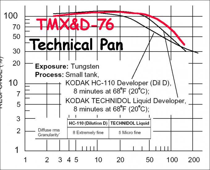

The way we present our data usually skews the results,
and talk about 'fine grained films' is a perfect example of that.
Here is Kodak's MTF data for Tech Pan, with the TMX curve superimposed.
Note that TP in Technidol has a lower performance than TMX and D-76.
With special developers, TMX has even higher MTF, and lower grain.
When we make the same shaped negatives, possessing the quality to make excellent prints without making a science project out of it, TMX/Acros/Delta100 have finer grain and higher performance than any of the tricky microfilms.

I don't have the numbers that Mr. Cardwell has, but I can tell you from my own anecdotal experience that TMX is one of the best performing films I've ever used. In terms of grain, it is so fine that viewing a print of any magnification from the proper distance, you can't see it. In making 8x to 10x enlargements, I find it difficult to see the grain with a grain magnifier. You can experiment all you want with re-purposed microfilms and exotic developers, but I've yet to see anything that produces consistently excellent results as well as TMX and XTOL or D-76. All that's required is to be a little more careful with exposure and development techniques to achieve negatives of very high quality. In the time when films like TMX were not made, there was a pretty good reason to wring what one could from a microfilm. There simply wasn't anything that could match the grain structure if that's what was needed. That's not necessary any more.

Figures for grain and MTF do not tell the whole story.
Tech Pan has a 'large format' look - an 8x10 print from a 35mm looks like it was made with a 4x5 camera, an 11x14 from 35mm shows higher quality than most 120 shots.
The same can not be said for TMX, even though the grain can be just as invisible. At any size larger than a 5x7 print there is no doubt that the negative was anything but 35mm.
The performance criteria where Tech Pan excells is resolution at very low subject contrast.

Figures for grain and MTF do not tell the whole story...At any size larger than a 5x7 print there is no doubt that the negative was anything but 35mm....
Well said, Nicholas... but our results our opposite of each others !
