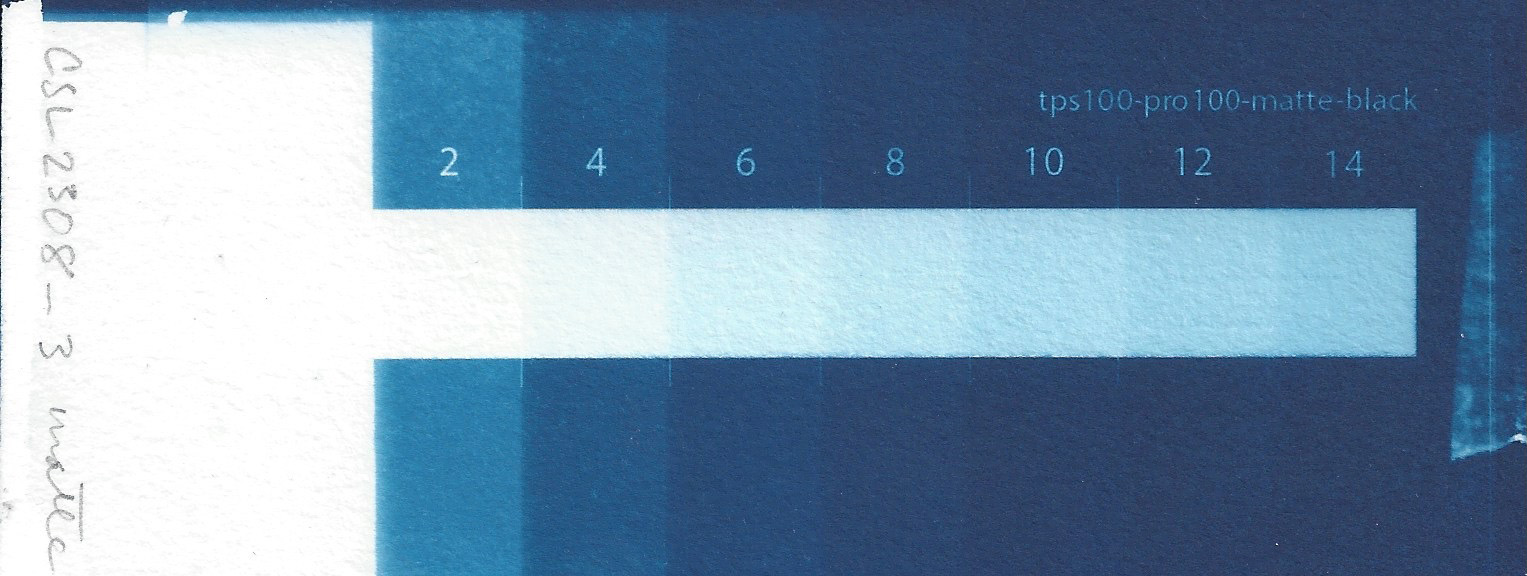

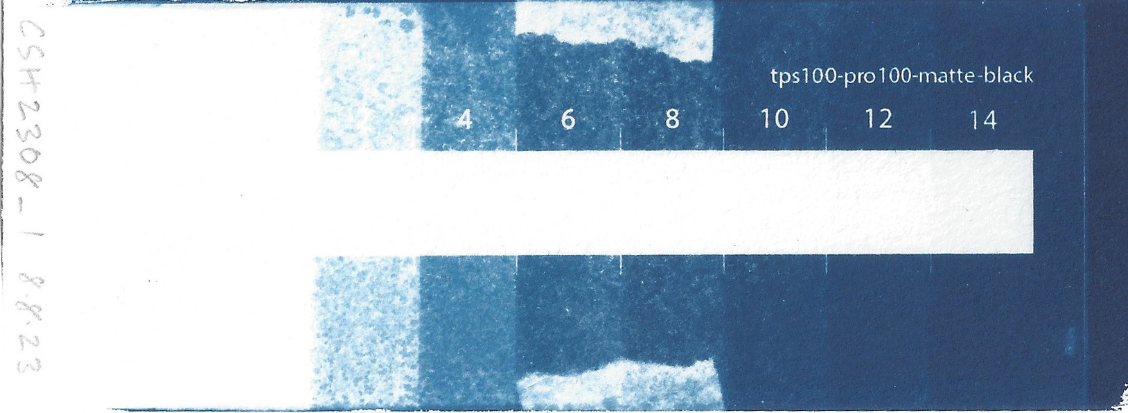

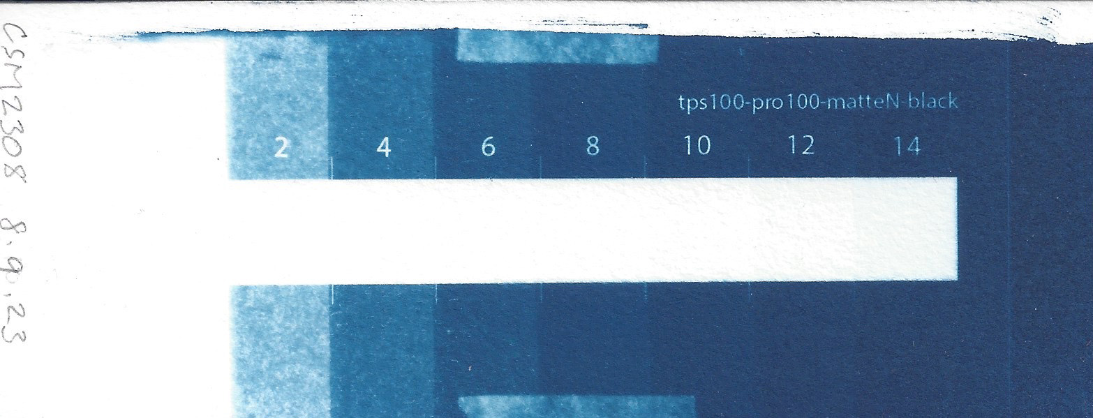

Then did the following exposure test: exposing a black strip at 2m intervals, for each solution.

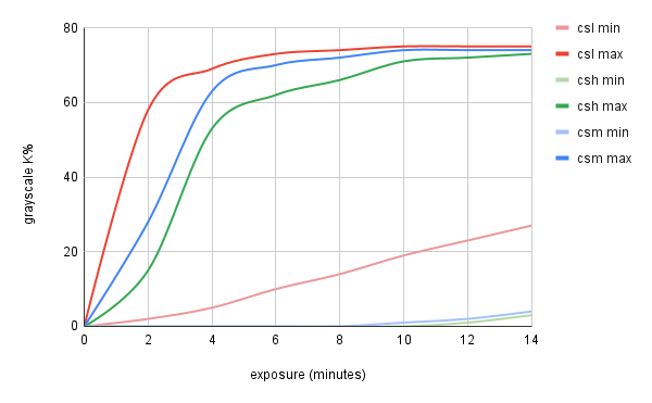

As you see, each has a different optimal Dmin-Dmax range. Here's what the density graph looks like in terms of grayscale K% at different exposure times:
The hockey-stick style lines going to the top are the Dmax's. For my setup (chemistry and paper) the highest Dmax I can get is capped at K=75%. But each version rises up to that level at different speeds.

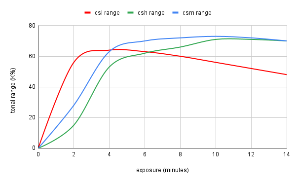

The lower three lines are the Dmin's. You can see how CSL's Dmin rises much more rapidly than the other two, making CSL the worst option for my setup. Here's a better view of the tonal range (Dmax-Dmin) for each solution:
For my setup the best I can do with each solution is:
  • CSL @4min: Dmax=69% Drange=64
  • CSM @10m: Dmax=74% Drange=73
  • CSH @12m: Dmax=73% Drange=71
So out of the three, CSM is the best chemistry for me. It's not giving me the highest Dmax possible, but it's good enough, and instead is giving me the widest tonal range. Had the 50% CSM turned out not to be good enough, I could have experimented with other ratios of CSL+CSH to find the optimal chemistry. In my case, I can push it up to a 58% solution, but then it's downhill from there.

1. It seems that the higher contrast formula adds a lot of coarseness to the image, which also extends to the middle grade as well. I don't know if this is real (i.e. repeatable) or not. If it is, you might have to add a surfactant or do something with the paper to counter it, to the extent that it transfers to an actual image.
2. It is interesting that even as Dmax curve for CSM is nearly the average of CSL and CSH, Dmin curve moves all the way down close to that of CSH. It is possible that you may not need a lot of CSH in the mixture to bring down the Dmin while still enjoying the higher ultimate Dmax of CSL. Based on this rationale, perhaps it is better to go less than 50% CSH rather than higher to get longer DR.
That's right. For better tonality, less graininess, I have to go to about 58-60% CSL in the mix at the expense of Dmax and Drange. It's a little disappointing, since now there's a third parameter to optimize in all of this; Dmax, Drange, and now Tonality.
