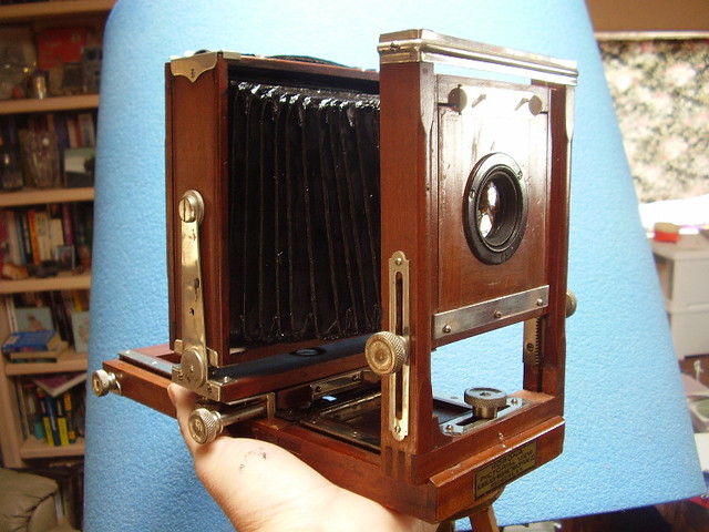

Back to the original poster; I made a quarterplate wetplate holder for a 3x4 Korona the other day. It's pretty small with a fair amount of movements. I don't know if Korona made a smaller version, but you can make your plate holder to shoot 2x3.
