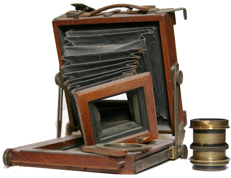

For about a tenth of your budget get a British 1/4 plate camera from the 1880's 0 1920;s and make an adaptor back. and it looks the part :D
well that's what it used to look like :D Enough movements as well.
Ian
Now
It has the original lens and a push on Thornton Pickard shutter as well as another board with a coated Trinar 105 in a Compur shutter, as well as a 6x7 adaptor back

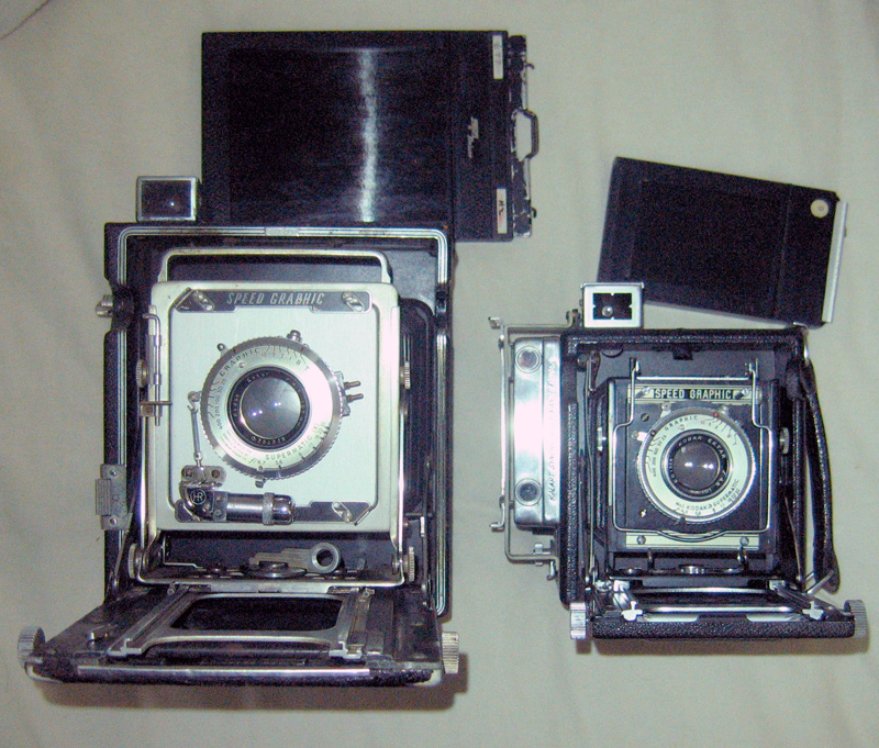

This is a timely thread because I'm looking at 2x3's myself. Does anyone have a picture of a 2x3 graphic next to a 4x5 graphic? It would be great to see what the size difference truly is. I poked around flickr but didn't find much.

Here you go, a 4x5 speed and a 2x3 speed

Wow...that's a pretty significant difference IMHO. Thanks for taking the time to post them.
Jim
I also have a 2x3 and a 4x5, and the 2x3 really is a much more intimate camera.
