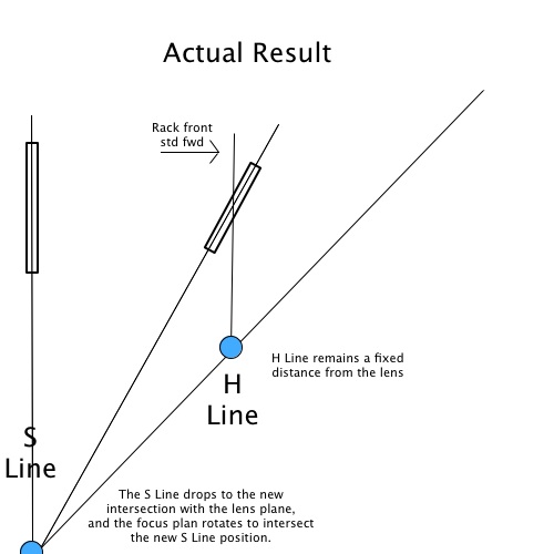

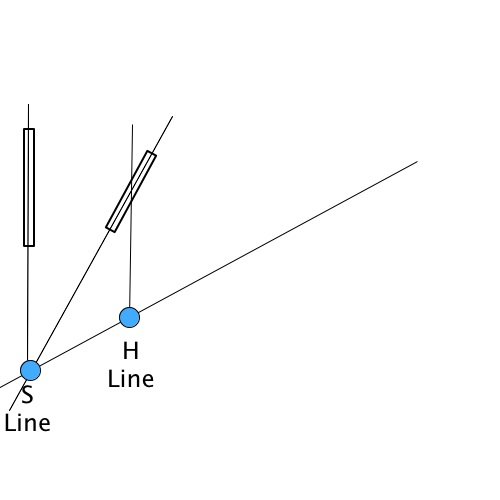

Chuck, I'll try this with my own crude figures.
Consider the following situation, with forward tilt. The Scheimpflug Line (S Line) is one of the blue dots (a line seen end-on is just a dot. It sits at the intersection of the Film Plane, the Lens Plane, and the Focal Plane. The Hinge Line (H Line) is also a blue dot. It sits a fixed distance vertically from the lens, and its distance is determined by the amount of tilt of the lens:

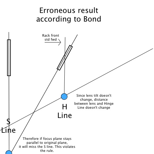

Now we will rack forward the front standard. Bond claims the focal plane will remain parallel to the former focal plane. But that would result in the following:
Clearly that can't be true, because the focal plane must intersect at the S line (the blue dot). The S line is in a different place, because the front tilted lens has changed position relative to the film plane, because it has moved forward. Thus the intersection is lower now. Thus, the focal plane has to rotate as seen in this correct result:
(Forgive the crude graphics, its the best I could do on short notice. Click the images to see them full size.)
Bond is claiming that a tilted plane of sharp focus (refer to as the focus plane) moves parallel to itself, not the focal plane. The focal plane is a line parallel to the lens plane but one focal length in front of the lens------so, to obey the H-Rule, the focal plane, the focus plane, and the parallel-to-film lens plane must converge at the H-line. Taking part of your suggestion, as I draw a line parallel to the focus plane, it continues to intersect the S-line and the parallel-to-film lens plane, but comes off the focal plane line, giving the appearance that an adjustment of the tilt angle is needed to re-establish the H-Line.
By this, then, it appears to me that, while the S-Rule is being obeyed with parallel movement of the focus plane , the H-Rule is not. Merklinger says that is possible, but the camera will not be in focus until both the S-Rule and the H-Rule are obeyed simultaneously. When re-reading Bond's statement, he is either:
- wrong, as you say
- he is right but fails to convey it properly in the article
- he is right, but I have totally misinterpreted his statement
I have to assume that when he says "....a tilted plane of focus moves parallel to itself....when the focus knob is turned...." that he means the front standard. Because, moving the back standard "rotates" the focus plane at the H-Line, and I view a rotation movement as different from a parallel movement.

For what it is worth, when I wrote "focal plane" above I meant "plane of sharpest focus". My bad for trying to save some typing.
The bottom line though as can be seen by the figure is that the light doesn't know whether it is the front or read standard that moves. Both movements accomplish the same optical result, of change the distance between lens and film, as shown. I think it is plain to see that the same figure represents the result of either a front forward movement or a back rearward movement.
