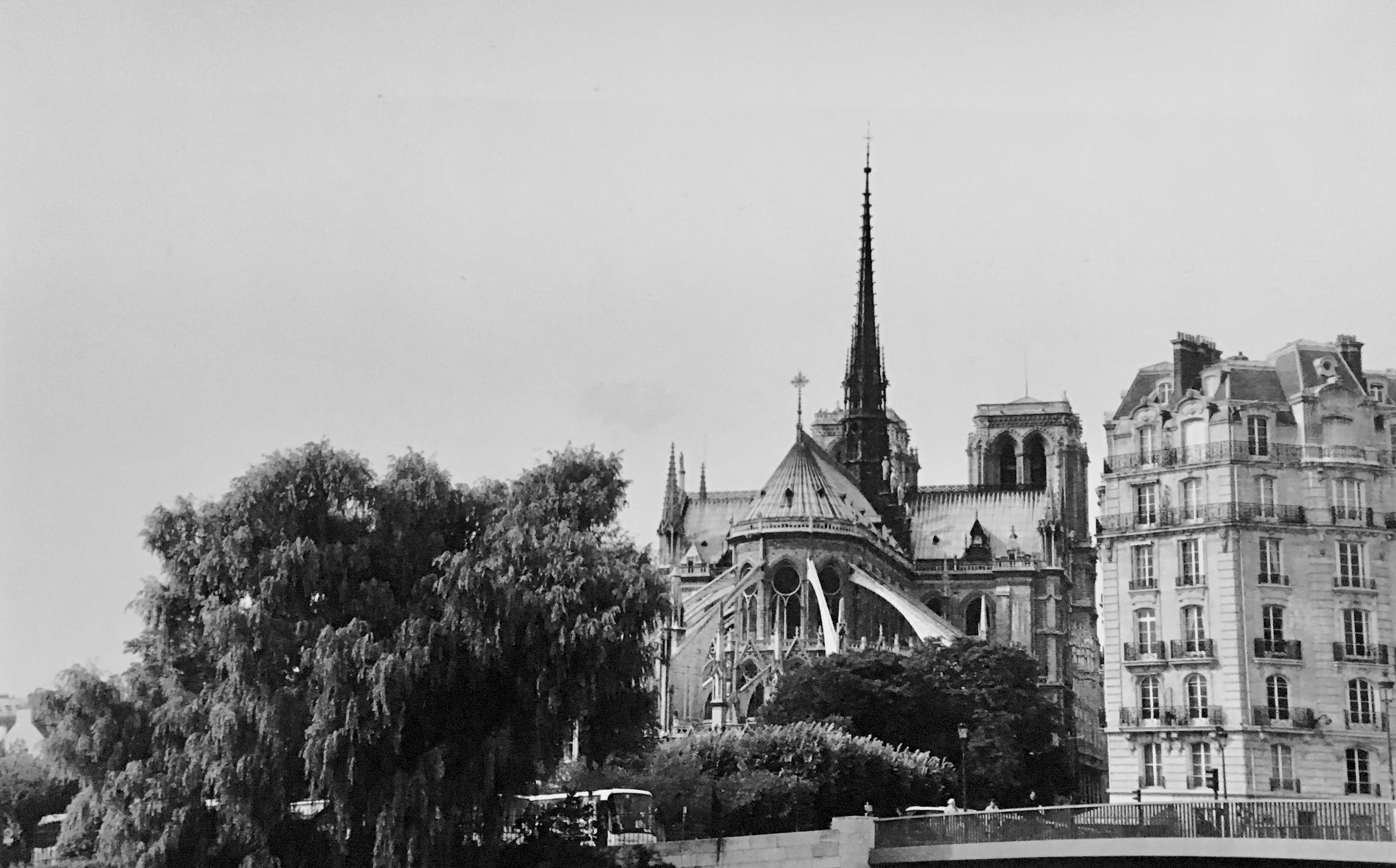

Although i love FP4+, TMax 100 has given me the sharpest (looking) results. I process most everything in Pyrocat. I recently printed an old negative (Leica 35mm Summicron) of Notre Dame before the fire. I didn't really think about it until the print dried....then i had to go back and see it was a Delta 100 commercially processed.

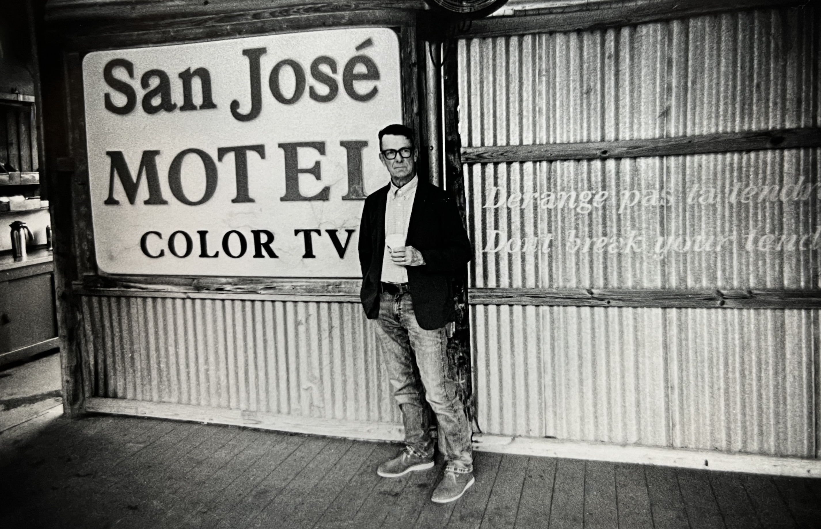

Don't look too closely, because this is an iphone photo of the print. But i absolutely feel that 11x14" is easily within the reach with 35mm. By comparison the 2nd (recent) photo (also an iphone photo of a print) is taken with a 50s Canon 28mm f2.8 (wide open) LTM on Tri-X and printed to 11x14". The image and tonality are higher on my priority list than "sharpness".....so much so that i sold off my (5x7") Sironar S lenses and went to Commercial Ekars and Dagors. Of course the rabbit hole you go down may/will be different than mine....
