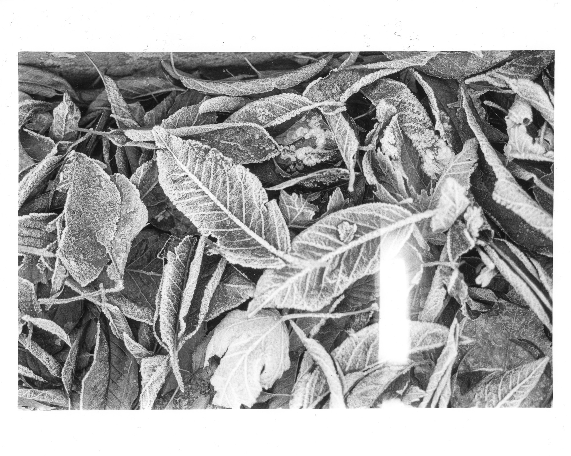

Long overdue posting of the scanned prints. These were scanned at 600 DPI and had white and black points set in Lightroom.
I decided not to scan or post Print #2 - it was pretty light and a bit flat compared to BTTB, so it seems I developed it to a slightly lower contrast index than the Mytol roll. It also clearly had greater overall density. Both rolls preserved plenty of shadow detail, though I printed some of it down to black in Print #1 as I prefer that interpretation for this photo.
Without further ado,
Print #1 - from a roll of HP5+ developed in Mytol 1:1
Canon FTb, Canon FD 50mm f/3.5 Macro, f/11, mirror lockup and self timer used to eliminate camera shake. Didn't note shutter speed; I suspect somewhere around 1/30. On a tripod of course. Uncropped print made on 8x10 Ilford MG FB Classic (Glossy), diffusion enlarger, Grade 1.5, selenium toned.

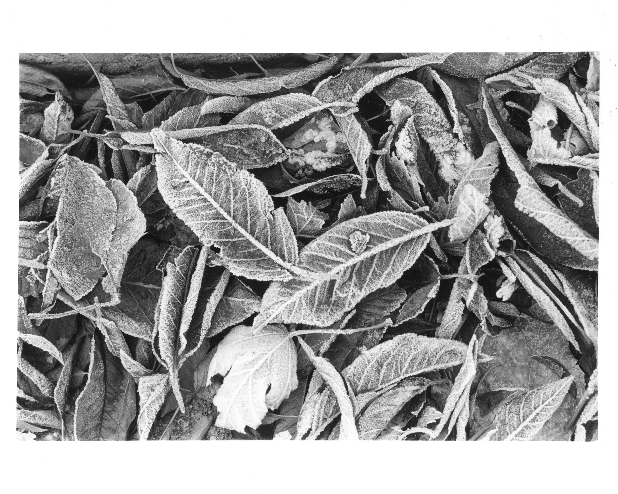

Print #3 - from a roll of HP5+ developed in BTTB
Canon AE-1, Canon FD 50mm f/3.5 Macro. Identical exposure and printing procedures (though at Grade 2 instead of 1.5). I believe the lens must have been a millimeter or so closer to the subject at time of exposure, as the focus reference was the same (the veins of the left-central leaf), but the right-central leaf went out of focus. Likely due to differences in the relative location of the tripod plate on the camera body and the lens mount. Also please ignore the light leak. I just replaced the seals on that AE-1 and apparently missed a spot.

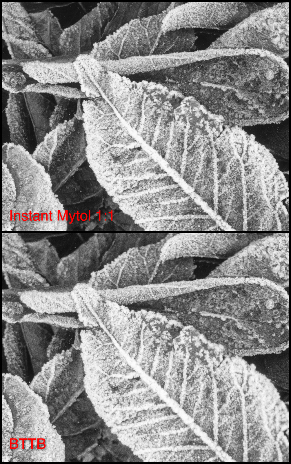

But close-in crops from my scanned 8x10 prints show pretty conclusively for my standards that I'm not getting a noticeable (any?) improvement in acutance using BTTB over Instant Mytol. I see none of the purported edge effects despite minimizing agitation with the BTTB. I do believe I saw a bit of compensating effect in the highlights, but nothing that made me want to standardize on this over Instant Mytol. The BTTB has noticeably more grain, but Mytol 1:1 gives a non-zero amount of grain with HP5+ that I think is probably enough for my tastes.
Comparison here:
