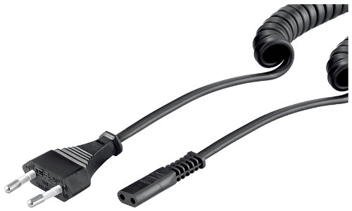

Is this the type of cable you are referring to?

Nope. It has a 12mm plug. New and for sale, from Paramount.
