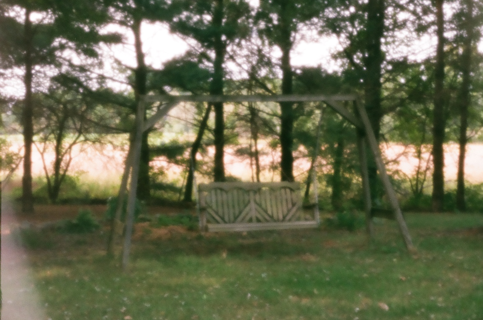

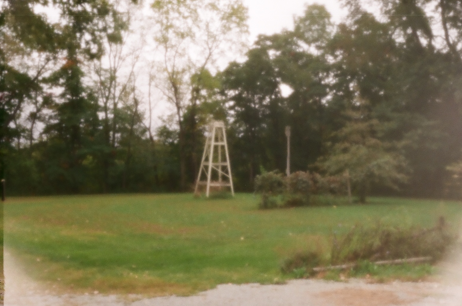

    I have been trying to get as sharp a pin hole photo for a while.
    I decided to try as small a pinhole as I could make, (.356 mm) as close to the film plain as I could mount it.(61.5 mm). this gave me an f 170 aperture.
    The subjects were simple a swing at about 25 meters, and a windmill base at about 75 meters.
    The photos are as shot, with fujicolor 200 and printed to a disc by the photo lab.
    Certainly not the best but a good starting point.

    Congratulations.
    I really love the romantic feelings in the swing shot especially.

    That's very close to the pinhole diameter given by the Lord Rayleigh constant in calculating the diameter. Slightly smaller pinholes should make slightly sharper images, but not enough to bother with as long as you're getting such nice results.

    Definitely shows progress! I agree with Jim Jones, a little smaller yet might be sharper, but you're getting some "painterly" images which could be quite acceptable as they are.

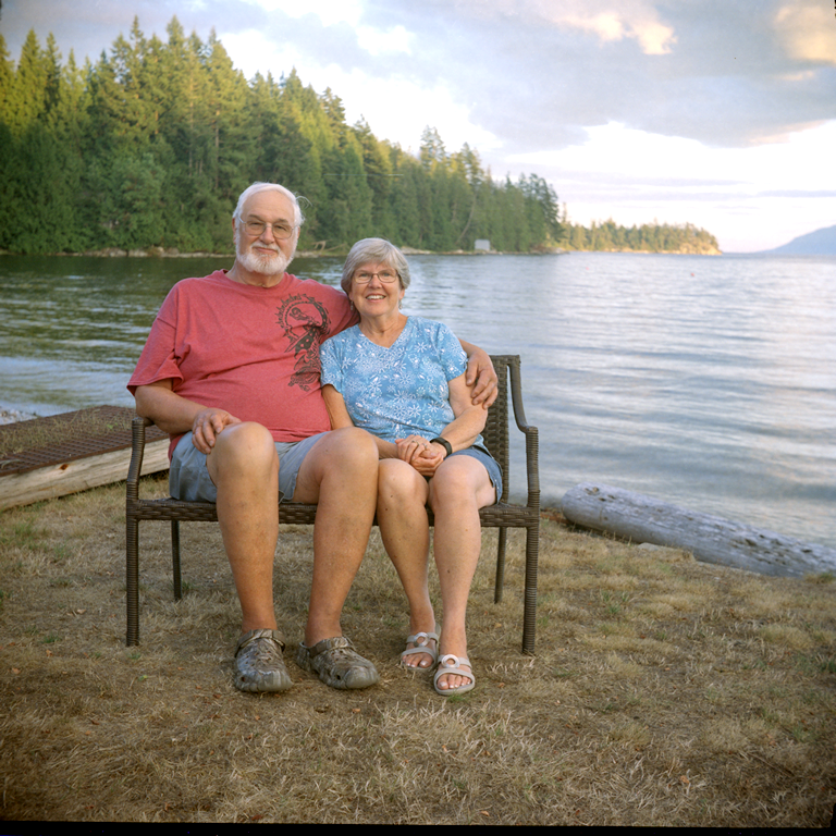

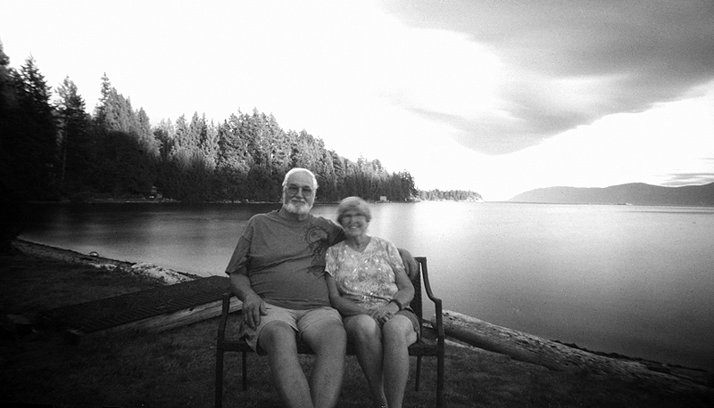

    One thing that it helps to understand is that when you use film with a pinhole, how you go about creating a print from that film is quite important. A pinhole image is almost by definition deficient in edge sharpness, which is a major component of apparent sharpness.
    Here is a resized but otherwise not heavily manipulated "snip" from a relatively high resolution scan from a larger, 6x9 negative:
    And this is the result after some aggressive post-processing work, particularly with the the Unsharp Mask tool:
    Not bad, considering this was taken using an exposure of about 30 seconds - our friends are great sports!
    In case you were wondering, this is how our friends appear on 120 colour negative film exposed in an older but more "normal" folding, scale focus camera:
